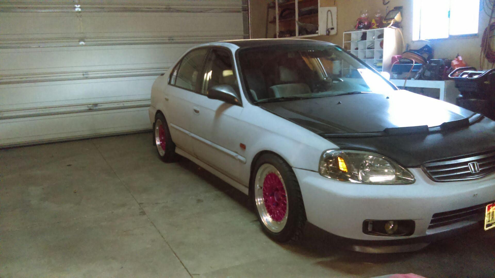

Originally Posted by A.R
do u have any pics of that setup?
what wheel spec were you running.
I might have to go with 5mm then becuz i dont think i want to roll my fenders
Not many pics that show the clearances but here's one that may help.
I only ran the 5mm spacers in the front cause I would have had to roll the rear (Sport-Comp 2 tires have wide shoulders). Wheels are just 15x7 +40 rotas with 195/50. Car's lowered about 2.5" in the front, natural camber via stock UCAs bringing it to about -2.4* according to my alignment sheet that summer.
Thanks man, thats the look im going for. My wheels are +44 thats why i said 10mm spacer
Based on your wheels specs +40 with the 5mm spacer will give you +35
Sounded like you didnt roll your front fender either.
What lip is that, and do you have pics of the mounting?
Looks spoon style to me
Yep, it's a 96-98 spoon replica in polyurethane. the tab that rests over top of the lower part of the bumper needed to be trimmed on either side 2-3 inches. Doesn't fit super well then again i never really sat down and tried to massage it more. i should have the front bumper off next week sometime for some corrosion control on the headlight supports and will take a few pics for ya!
I've seen a few people modify EM1 lips to fit, I believe they need to be lengthened about an inch and that's what I'd really like to get eventually
