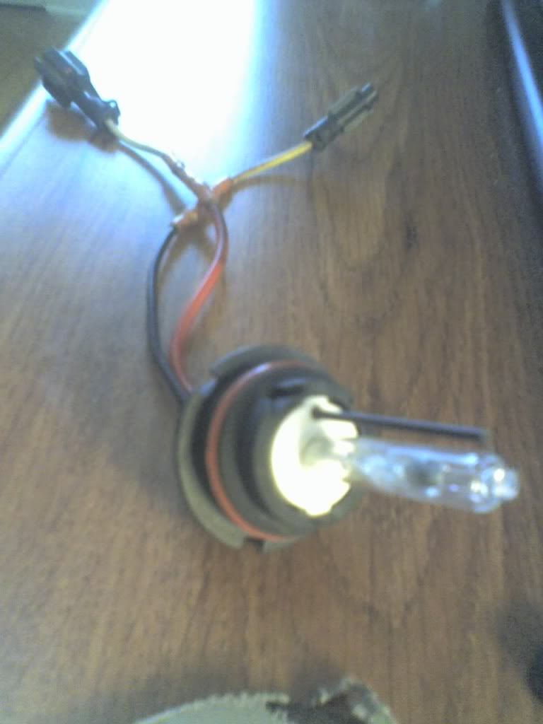

Biggest difference is the filament location. 9004 uses transverse filaments, which is crappy for headlight use IMHO, similar to H3 foglight bulbs with a transverse filament. 9007 bulbs have axial filaments, like H4, 9006, and 9005 bulbs do.

So the 9007 will fit right ? This is the headlight that was in there.
