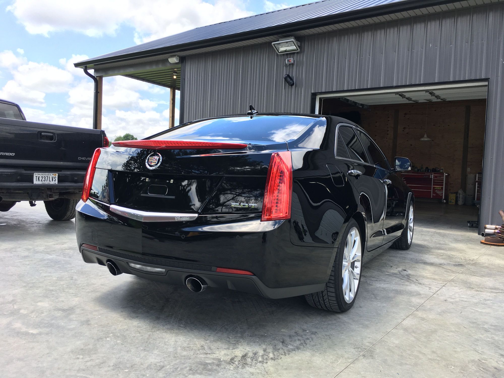

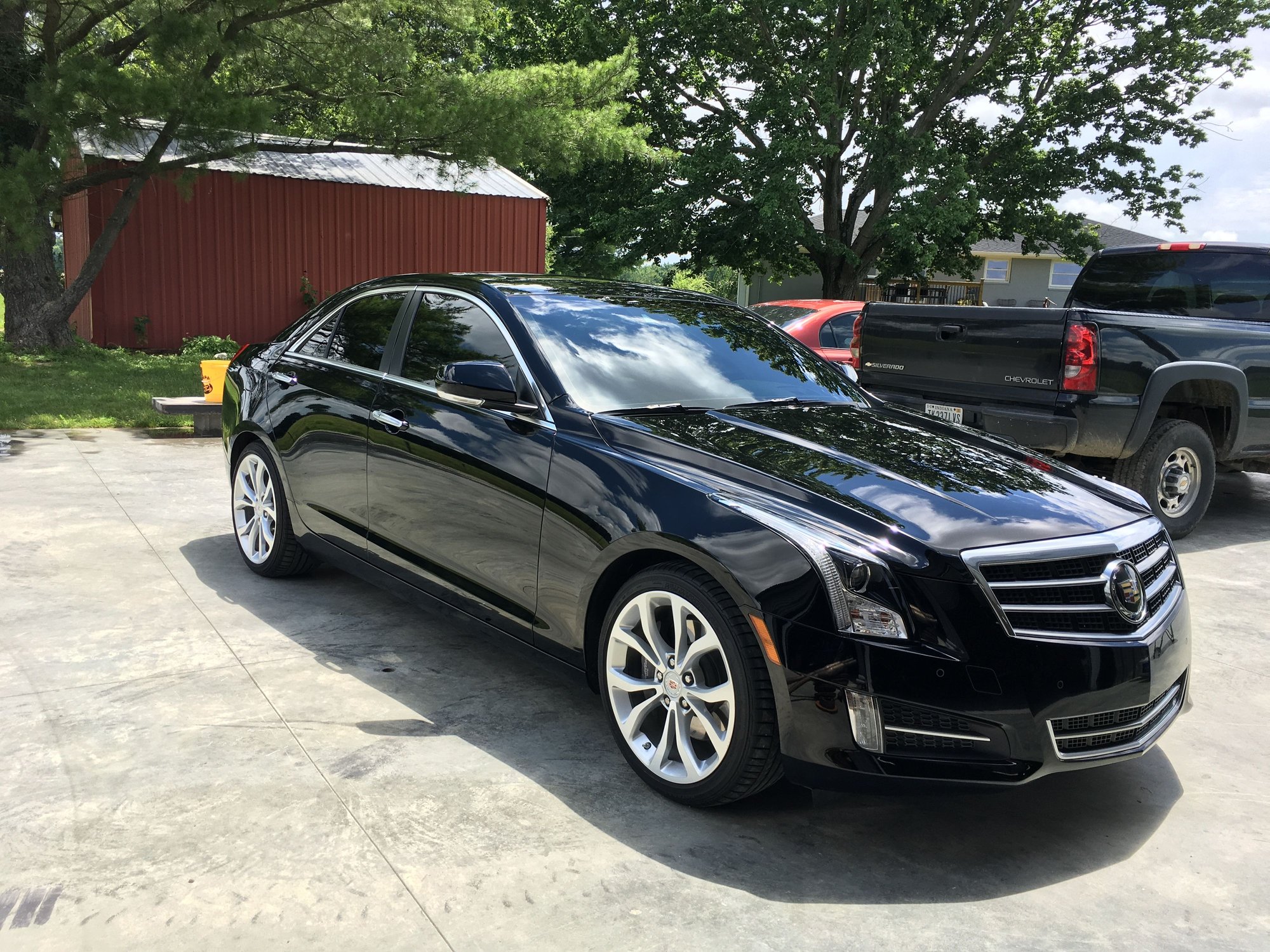

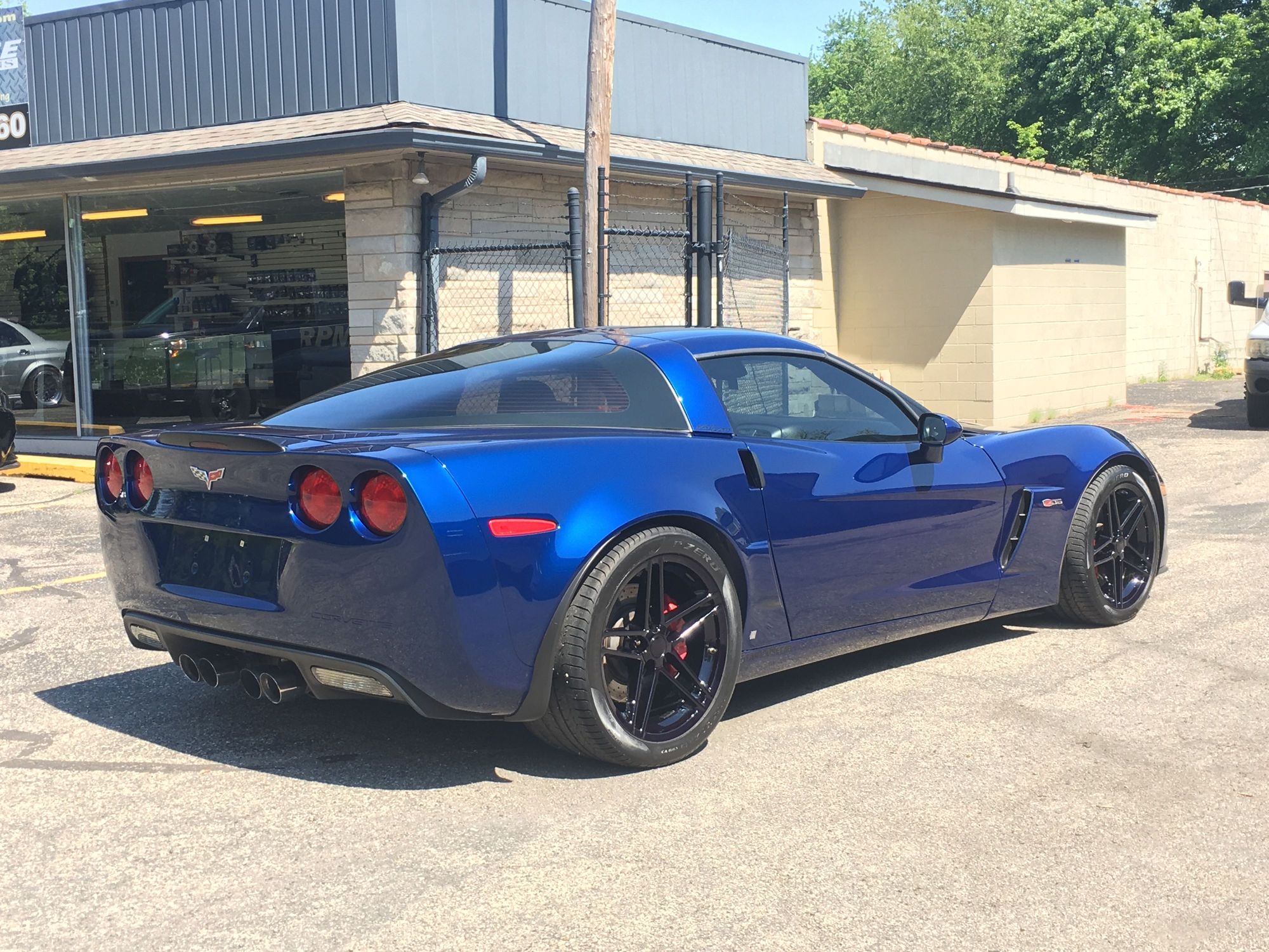

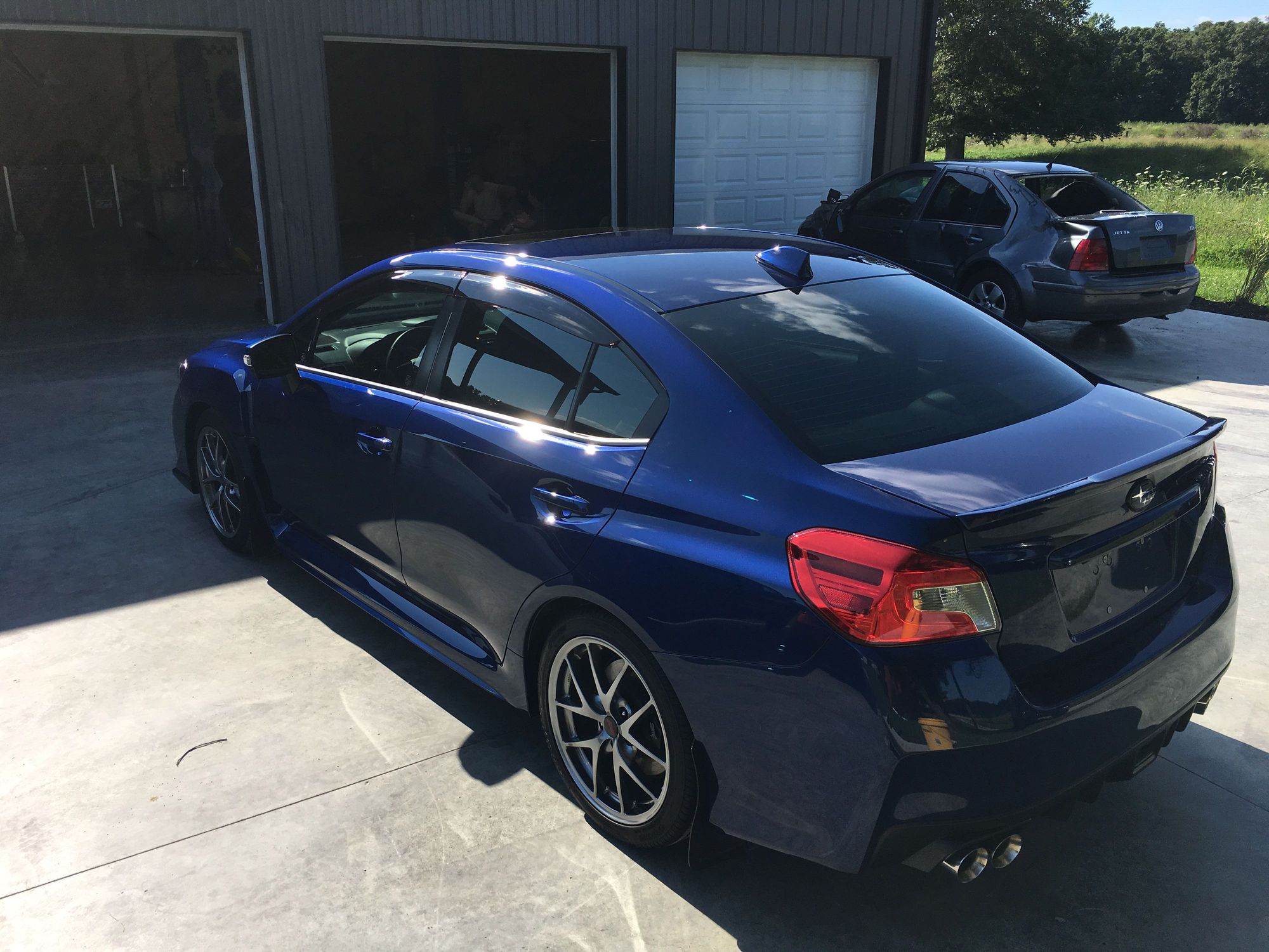

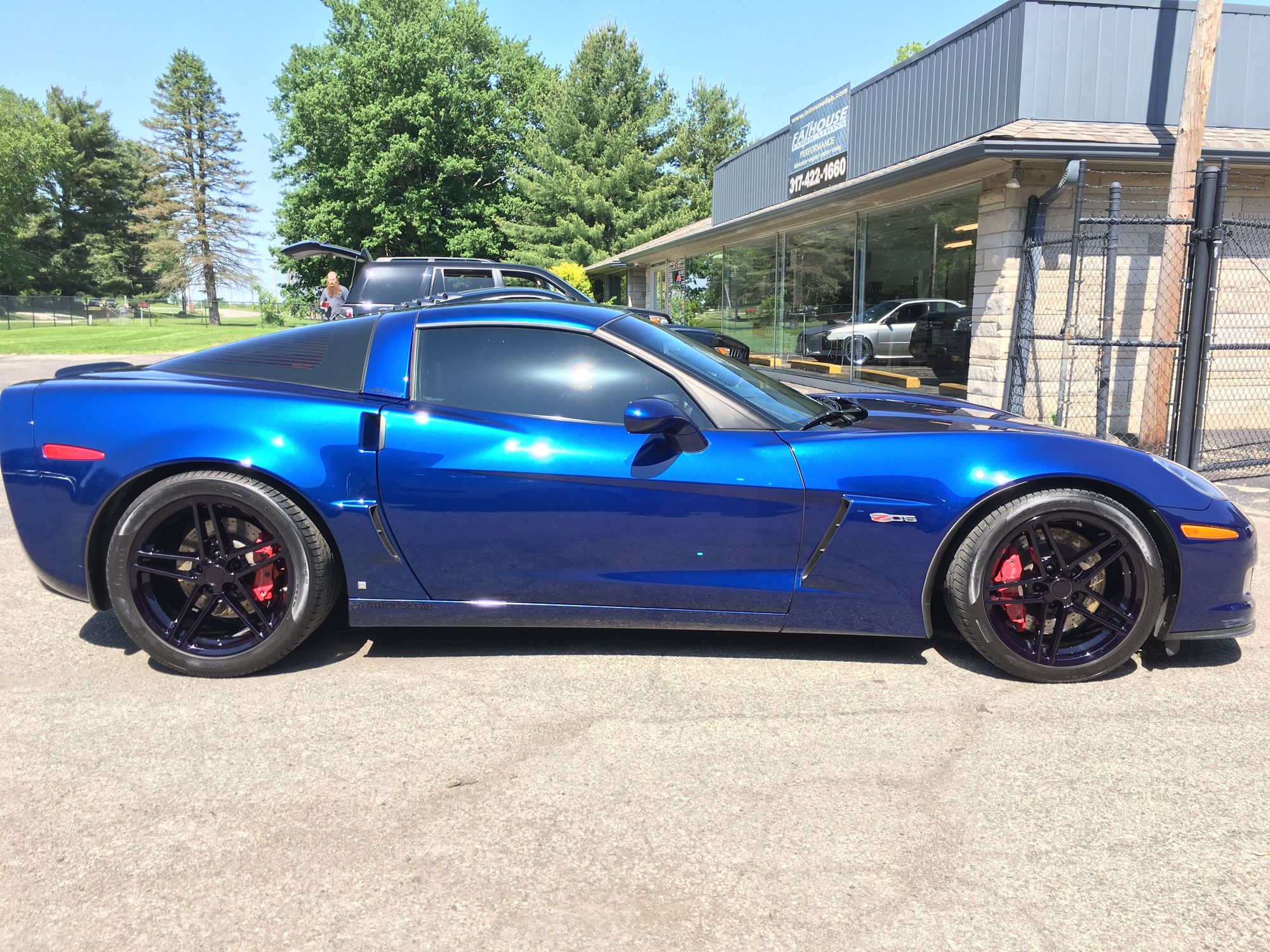

Originally Posted by Charisma View Post
I own operate 'Detail Solutions' in Baltimore, Maryland Detail Solutions - Baltimore Maryland - Detailing and Coating Specialist. We coat roughly 10+ cars a week. Here are my 'expert' findings.
Coatings WILL help mitigate the number of wash marring/swirl marks; depending on which coating you go with. The most important part here is proper washing. My personal truck is a 2011 F150 (BLACK) that has Opti Coat Pro Plus on it (for 2.5 years now) - for 1.5 years I washed it with the same brush that we used on customers wheels/tires - my truck is now showing swirling - but minimal. The amount of abuse I gave my trucks finish is easily far and above that which my standard customer gives their coated vehicles.
I have customers who come to me for a 2-year off-the-shelf coating after a year they show a good bit of swirling, but I would be inclined to say still less than a non-coated car would.
I recently purchased my wife a new car and we coated it immediately. This is GM black (which is complete trash FYI) - it will be used as my 'control' unit. I will only be 100% properly washing her vehicle. I am quite confident when I say there will be little to no swirling in her vehicle after 1, 2 or even 3 years. When it is heavily soiled or salty I pre-soak with Optimum No Rinse, then come back and wash with ONR and a quality sponge. I've seen incredible results with this method on my customer's vehicles in the winter months and have seen little to no wash marring induced over years
I offer a handful of coating options to our customers - I find the most important thing when selling is being honest. It does not matter, over time you WILL induce marring no matter which coating you buy. Over time, if that type of thing bothers you-you will need to be repolished and recoated. Nothing lasts forever, regardless of what the manufacturer tells you. The important thing here is - your vehicle will look better, be easier to clean and any issues will likely only be in the coating, not the clear coat.
