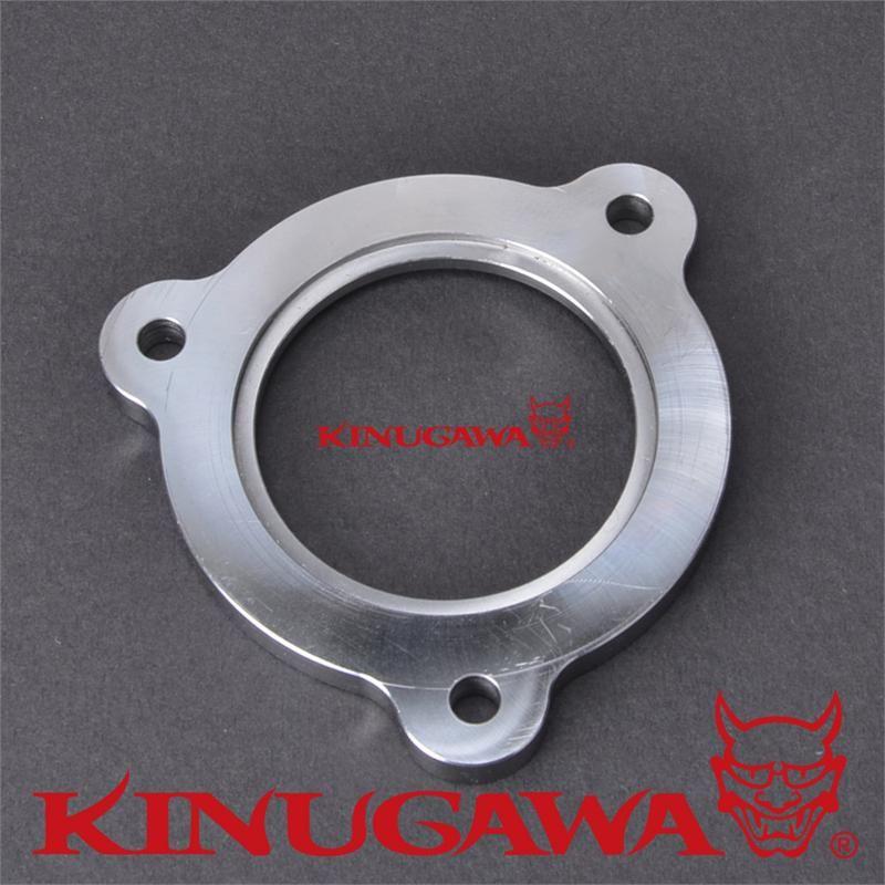

Dur Da Dur
hondur's Avatar
Join Date: Aug 2015
Location: Jackson, New Jersey
Posts: 526
Default Re: You guys wanna help me design my exhaust?
look guys i found it
all i had to do was enter the correct term into google. "s70 turbo flange"
