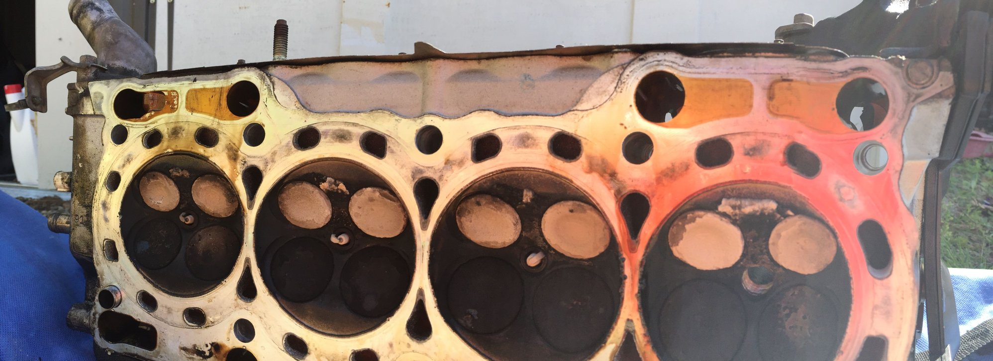

Hey guys I'm new here, still tryna find out how to work this.
ive just bought a 5th gen prelude , H22a4
was throwing multiple misfire code and cylinder 3 misfire code. Just pulled the head off and seen the timing was off on the intake side. Also the exhaust valves are white with a lot of build up as well as in the combustion chambers , would this cause the multiple misfire code and cylinder 3 missing?
ill try to upload some pics The timing marks
The combustion chambers
All exhaust valves look like this

Default Re: white exhaust valves turbo b16 : pics
No. Not necessarily. white valves like that are typical with higher mileage engines, especially those that run in too high of a gear attempting to accelerate. It's rather common.
Your misfire sounds more ignition related. (distributor, internal coil, spark plug gap, etc).
Start checking there 1st. Make sure cap & rotor are changed, usual maintenance, etc..
