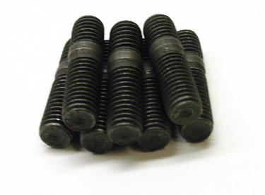

I am currently looking for those 4 manifold studs that you use when you mount the turbo to a rev hard style manifold
Honda header studs are too small for them so I needed something bigger.
Anyone know the measurements of what i need and where I can get them.

Hmm, just checked my notes, and it looks like Drag, Rev-Hard, and Inline Pro manifold to turbo threads are 10x1.25(per Stan). I'm using the studs above from ATP with my BLOX manifold, and they work fine, so I assume BLOX are 10x1.5. Sorry for the confusion.

<TABLE WIDTH="90%" CELLSPACING=0 CELLPADDING=0 ALIGN=CENTER><TR><TD>Quote, originally posted by project dc2 »</TD></TR><TR><TD CLASS="quote">blox are 10X1.5
revhard are 10X1.25</TD></TR></TABLE>
i have those ebay cast ones so im not sure which one they used.

Ace Hardware has plenty of these studs. They are in the bolt section in the box labeled "Automotive Studs". I just bought an M10x1.25 stud for my bike two days ago.

damn i went to hawaii nut and bolt, and napa. i forgot which one i found 10x1.25 or 10x1.5 only at napa, but not at hawaii nut and bolt. Oh wells. ill check out ACE in hawaii.

your lost for good reason, revhard has been known to mess up and tap there manifolds to 1.25, there supposed to be 1.5 but a lot of them are 1.25 due to using the wrong tap by mistake... revhard

It's just a different thread pattern. That doesn't make it "wrong" or bad...just means you need a different type of bolt to work.
<TABLE WIDTH="90%" CELLSPACING=0 CELLPADDING=0 ALIGN=CENTER><TR><TD>Quote, originally posted by Evilparadize »</TD></TR><TR><TD CLASS="quote">What about the Meutek manifold bolt size? (Turbo to Manifold) Do they have to be heat treated or do ACE bolts hold up pretty well? </TD></TR></TABLE>
The ACE studs are black. Black are the strong ones....you'll be plenty fine. I've used them before on my turbo setup for over a year with no problems at all. Those bolts don't really need to be like super high strength because they are only holding up like 20lbs or so. It's no where near the forces that a strut bolt would see or something like that.
