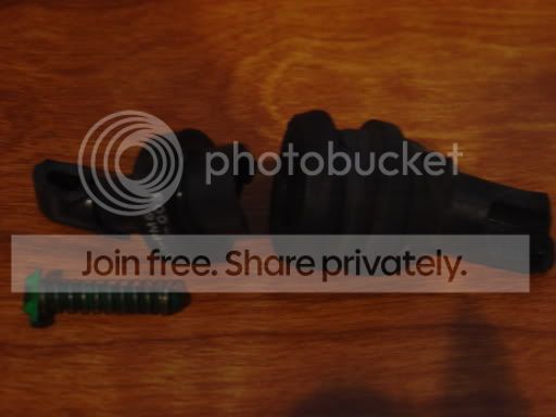

Alright, so i think i found the pcv valve, and i broke it into like 30 pieces on accident..oh well.
it was in this hole

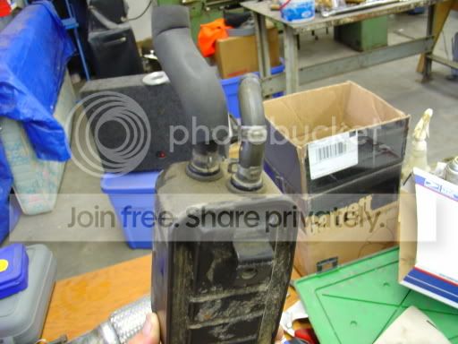

I pulled out the black box
What do I do with the second hose that goes to the back of the block? keep it there?? the other one will just be replaced with a longer hose like Ryanej8 said to do. And then i will run a breather.
It all makes sense when you just go take **** apart. This should be alot easier than a catch can, and you shouldn't have to worry about draining the can, and having to fill your car back up with oil.
