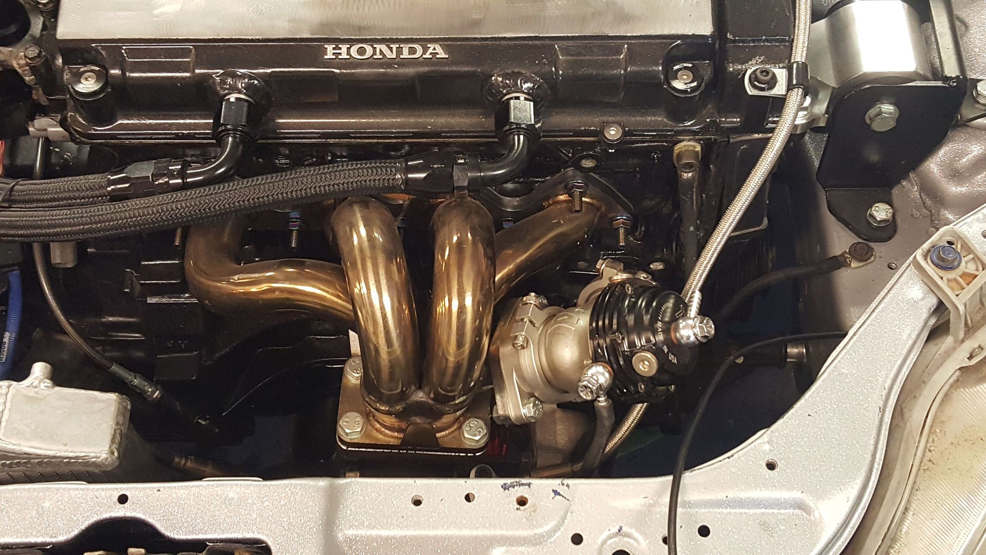

Here is a picture of the manifold
https://cimg5.ibsrv.net/gimg/honda-t...2890e43ea4.jpg

Those manifolds are notorious for having problems controlling boost. Look where the wastegate placement is, the exhaust has to make a 120 degree turn to exit out of the wastegate. My advice would be to get a new manifold with a better wastegate placement, plus those manifolds are also know for cracking unless it has been braced. I would get a ramhorn manifold or a cast iron manifold with the wastegate placement in the middle part of the manifold. Don't get a mini ram manifold, you will have oil return issues since the turbo sits so low.

Typically those manifolds boost creep rather then lose boost. As far as cracking really depends on who made the manifold if its an ebay version then yes they crack mini rams made with good materials not so much.
Is that Genuine Tial or knockoff? If its a knockoff I would not trust it at all, if its genuine I almost wouldnt even bother testing it as it looks new. From your description about "not closing fast enough" sounds like a knockoff, a genuine Tial would never do this...but you need to test its operation at this point
double check your vband connection is tight looks to be on the looser side in this pic The dumptube portion looks extremely loose...which wouldnt cause this issue but would still be an exaust leak, just dont over tighten, Also looks like you are using Intake manifold studs on the exhaust side Make sure everything is tight, Personally I use OEM studs and OEM exaust nuts. Make sure those are nice and snug aswell

Dark_Teg Jan 17, 2018 11:09 AM
Re: wastegate issue?
I think you have a massive exhaust leak pre-turbo. Cracked/broke manifold, loosened turbo to manifold bolts etc...

ok guys put together a regulator ,wastegate has a 14psi spring, so along with finding bov set very loose, exhaust manifold bolts not very tight, i found the the plugs on the wastegate was leaking some as well. I sealed them up and ill test again shortly.
