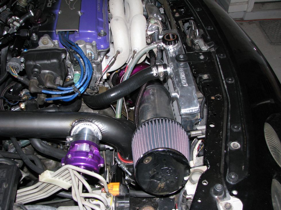

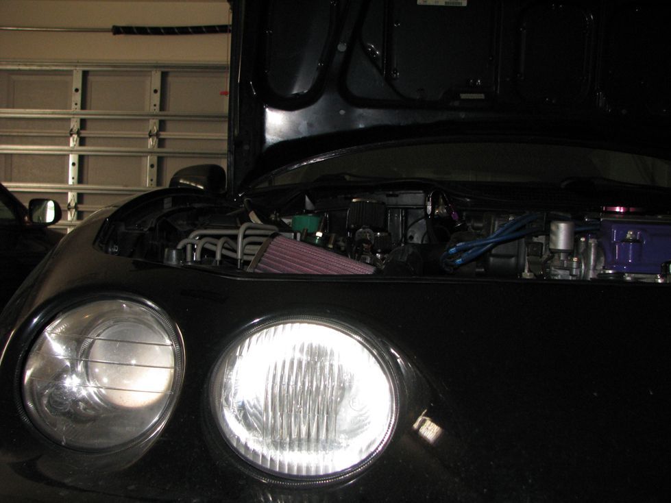

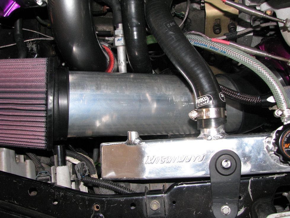

I had to move the coolant overflow (I found my stock plastic one had cracks in the top so I just replaced it).
Anyway, here it is, full 4 inch diameter and about 21" from the turbo to the end of the filter. It does not hit the hood. I haven't made a bracket for the filter end yet, but I plan to make something to help support it though it might not be needed.
