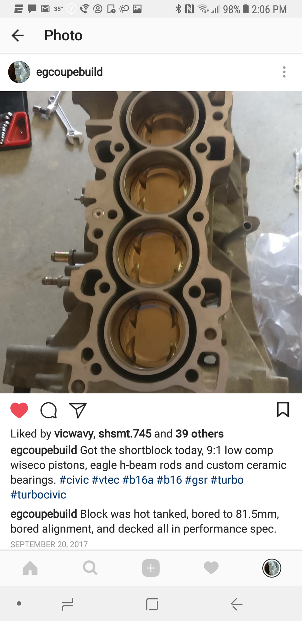

Just finished the head last night, about to bolt the head down when i get a nice torque wrench, heres some pictures of the goods🤗.
Anyways, its a completely stock gsr head. The block is a b16a with 9:1 wiseco pistons 81.5mm, eagle rods, stock crank.
Running a oem headgasket.
setup is for mostly street fun, but also can play at the track.
i also havent ordered my turbo, but from research I saw that the S256 would fit my build the best, also taking suggestions on that.

Hey sorry for the late response, I posted pictures and still haven't been approved Anyways I'll post this and when it comes up I have some pictures of the build :D
Its a b16a 81.5mm 9:1 wiseco
pistons pistons
Stock gsr head, oem head gasket, along with oem
water pump water pump
and oil pump.
In a eg coupe. Mostly for street fun, also some track use on the weekends.
Again around low 400's whp, Getting it tuned @ Slowmotion motorsports in ohio.
Also for the
turbo turbo
, I was looking around and saw that the s256 probably fits my build the best, but i'd also like to hear recommendations from you. Not sure on the housing but, Balor said .63
