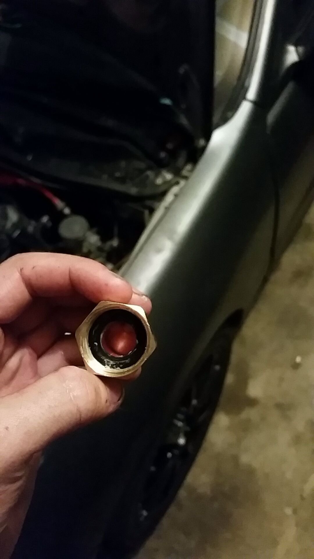

Okay so today has not been the best day for car work.
Long story short, jacked car up, to bleed coolant again, checked oil, saw it was low(cause it was on jack stands dumb me) filled it up, let it idle, blew a O ring on one of my fittings completely out cause the oil psi was so high due to so much oil. (oil started leaking slowly out of the fitting and dropping on the ground so I unscrewed it and saw the o-ring vanished)
I basically have no idea where it went, somewhere in the oil system, probably stuck in the sandwhich plate or the oil filter? What do you guys think, I strongly do not want to pull the sandwhich plate off, cause it took me 4 arms(a buddy and I) to get it on there.
Also: When I was taking the fitting off, I didn't notice the hose was getting VERY kinked up, it's -10an steel braided, do I need to replace the hose or will it be okay even though I squished it a lot.
O ring gone
what it should look like

I'm.......not sure if there is supposed to be an o-ring there.
I could be wrong.

They came with the fitting when I bought it, when the O ring is in there it wont leak, but when it falls out it starts to leak

What fitting is this? Looks like an oring they put on shower heads or bathroom faucets.

It's for garden hose/pressure washer, I figured it would work but I should have rtv'd the o ring down tight first

Why the **** are you using GARDEN SUPPLIES for something like the oiling system of your car?!?!? On top of undoubtedly not being rated for the temperature of an engine, the rubber used is most likely NOT oil safe. And don't think that somehow rtv will magically bond it. Some rtv is oil resistant but not 100% and its NOT a glue. Get the right ******* fittings for ***** sake so you don't blow up the engine
BTW oil VOLUME will not increase oil pressure. Oil viscosity and temperature do. Unless you had so much oil in it that you were flooding the oil return line for the turbo, which would damage the seals since it can't drain properly.
You better find that oring. If it is in the oil lines you will probably blow up the engine if it blocks a critical path
