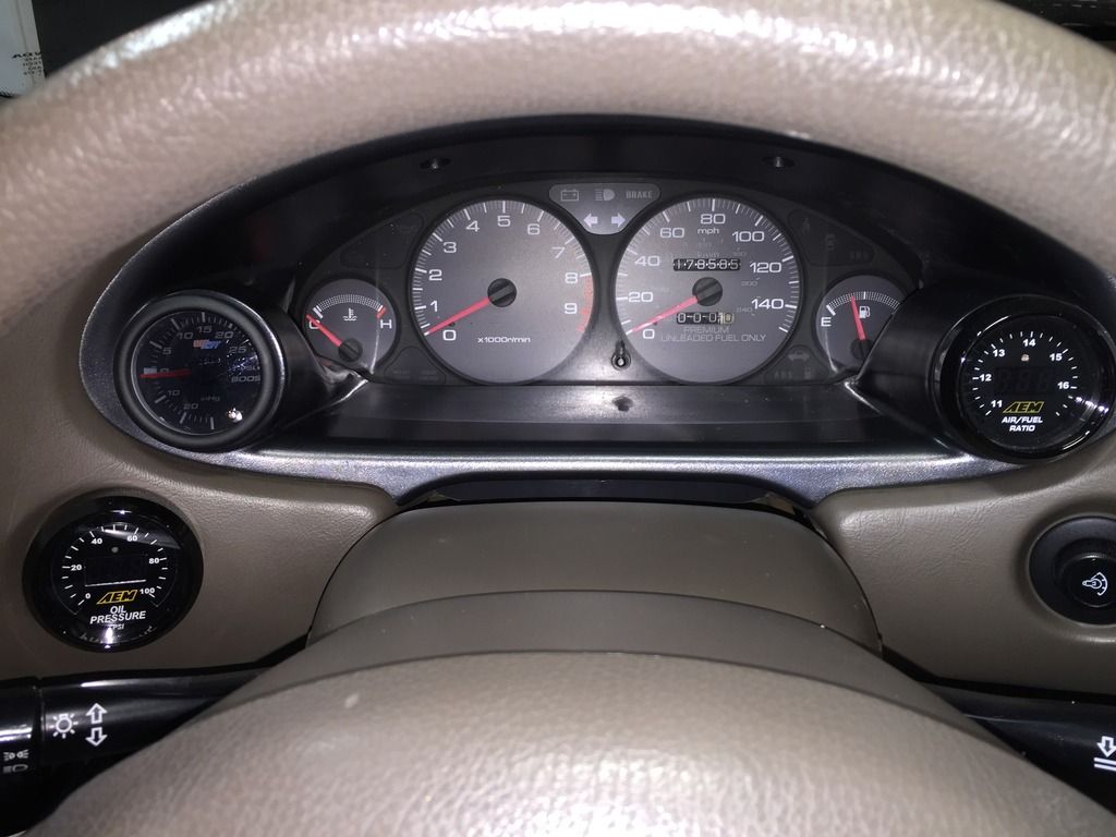

I got the scirocco radiator mostly mounted today. I took a ridiculously excessive amount of pic for you guys lol. I really wanted to keep the factory hood latch, in order to make the radiator tuck under the latch I had to notch the core support and then I welded in angled steel. I made some aluminum brackets really quick to support the top of the radiator, I will probably make some better ones later on. The whole process should be pretty easy to follow by looking at the pics. Overall I like the way it turned out and it should save some room in the engine bay too
boosted94gsr is offline   Reply With Quote

Got my AEM oil pressure gauge today. Decided to mount it were the cruise control button used to be. I also mounted my wideband and boost gauges in this piece if crap blox cluster mount. It covered 1/2 the temp and fuel gauge witch bugged the crap out of me, so I used a heat gun got it hot and bent the ends in to were you can see all the gauged now lol. The glowshift boost gauge isn't my first choice, but I had it laying around so I decided to use it.
