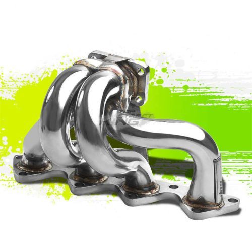

It didnt also really help that the 2nd and 3rd cylinder see much higher backpressure with that manifold right?
No matter what you tell me i dont like that manifold at all if you look at anything over the edge on performance.
Unless you run a motec or something and tuned each cylinder on a different 3D map.
Id really like someone to make a REALIABLE manifold of this ebay design.
Also dear god this pistons held the shockwave AND the debris.
This is not good for my brain.It itches me to get em now.
This is a classic case of "don't knock it until you try it, first." That very "Mini-ram" design is extremely efficient for its capabilities, and doesn't require something as exotic as a MOTEC to be able to work effectively and for long periods of time. From my experience with that manifold, as much as I don't like the fact that it sits that low, it does an amazing job of keeping the runners long enough, but the primaries not too large in order to support a wide variety of turbochargers, from GTX2860RS to GT3588Rs. It is truly one of the best of two worlds when it comes to a manifold for turbocharging. Much better than what is expected out of a Kooks-style "Ramhorn" or any "Top-mount" system.
Regardless of which manifold design you have, for Honda B-series engines, Cylinder 3 always runs the leanest. That's why those of us that still use EGT meters, tap that particular runner; because #3 is the most sensitive to detonation.
As for the classic "Kiwi" manifold you're referencing to, there is a person who makes those in limited numbers in a quality way. That is Love-Fab. The "Mini-EQ" is actually the one I'm switching to now, after my years of good use with the JDL Auto Design manifold that myself and "Dark_Teg" uses. Not sure if they make it enmasse anymore, but its the design we're going for.
Thats the exact reason i find the design i posted better and this BAD. If someone is a bad driver getting him drunk wont make things better right?
If it happens someone to measure the pressure on the to middle super short runner i bet the ll have much more difficult time evacuating the cylinder correctly or even mess with the other
pulses contaminating them. I cant even imagine the low pressure wave anywere with those runners.
This super short unequal length manifolds are not uncommon on the oem world but i dont thing any oem car will hit 500-600 to the wheels on 9500 rpm.
That manifold is so wrong for our engines really. Whould i use it? Yes on a GTX3576 after i measure the AFR on those unhappy cylinders and fix the map accordingly.
On a 7000 rpm 2.0 ABF VW yes i would use it without too much hassle too. But not on our engines.Unless i was on super conservative tune asking for like 350whp with b16 low
exhaust overlap cams.And i would use it if it was t3 or t4 divided pulses also, but not like this.
the lovefab mani looks cool.Altho again id have 1-2 inches straight exit before the first curves. But its MUCH better from the mini ramhorn
Again, this is on you. If you feel that way fine. It's the difference between experience and theory. On paper it may look "bad", as a practical matter, they work out great and have been doing so for quite a number of years (10+) on these engines. I like and have utilized the Mini-EQ on quite a few time attack and enduro runs without any hiccups or issues from exhaust backpressure, rotational speeds, etc. Not to take away anything that you've accomplished, Balor_GR, But the individual that was making the Mini-EQ is now strictly on NSX Pikes Peak Project cars and WTAC in Asia. I'll continue to take my design cues from him right now until otherwise for the time being.
Good ole' Rhett.
Life is good. We can agree to disagree.

No no mini eq looks very good. I was talking about the other mini-ram "super un-equal" style.I would trust my AFR on the mini EQ.(you probably missed the text under the image)
Id just add a straight 1-2 inch space between the head flange and the first curve on the mini-eq manifold.
Whats the sppol of the mini -eq vs full rammhorn?Closer to the ramhorn or closer to the "super un-equal" ?
Unless something is very wrong with it aero wise i believe mini-eq is the best mani design for 350 whp all the way to 800 whp.
I was crying so many years because the ebay mini eq was looking better from the other manifolds in my mind.
Now it makes sence it was a copy too
I didn't miss anything. I'm saying you wouldn't want to change anything off of the Mini-EQ. NOTHING.. I've dealt with Cody (the owner) long enough to leave his designs alone. If there's no 1-2 inch space, it's not there for a reason. If you want to contact him and go through the meanders of the "why", please be my guest.
We can simply agree to disagree on the mini-ram style exhaust manifold and it's utility.. No further comment is necessary.
The original Kiwi that you mentioned that is so popular on eBay has been copied since 1996, when Tomei first used them on SR20DET builds in Japan. The materials just kept getting worse, and the construction even more horrid.
