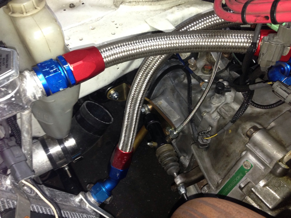

Look into aftermarket slave cylinders. You can get a puller style.
http://www.cncbrakes.com/sc.asp?grp=...eries=standard
citrus3000psi uses a Howie racing slave cylinder
Thanks muck, I saw this on T.I too. I wont be able to keep the torque mount with this setup right? is that a problem at all?

you can see the torque mount on that car.
