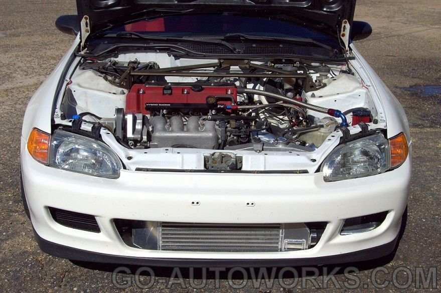

Something a little different from the norm here.
A 92 CX Hatch build w/ an 05' K20A ITR swap done by the owner. This setup w/ a cold air intake, Hybrid-Racing swap header, a Skunk2 Mega Power RR 76mm header-back exhaust, and KPRO made 231whp and 168wtq, on 93 Octane (Dynojet)
It now has the addition of the C38-61 Rotrex head unit from Kraftwerks installed and all of the fab completed. Still on pump, still the same stock motor/clutch, etc. 1000cc in and a new map sensor were added. 11psi, 361whp, 231wtq (same Dynojet). IMO, that makes for a fun package. A pulley change and E85 is on the way for it.

Thanks, once it is all together it does layout fairly simple. The charger/bracket/lower part of the bay in the front is jam packed.

The fan could actually be a puller at this point, but would be packed super tight. It came in mounted that way; which was a few hour road trip to get here. The original plan was to do a long intake putting the filter out into the driver side fender well. After looking it over, that would have been impossible with the layout of everything else (ducking, dodging, and dipping w/ a 3" pipe). There's a gaping hole right there for air to get to the area the filter sits in without soaking from the radiator (while still being somewhat symmetrical in location)
