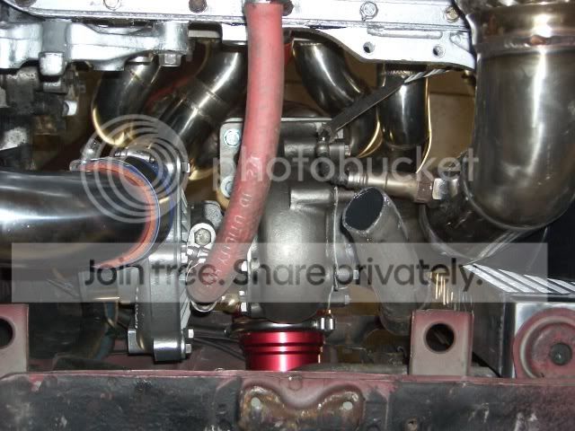

not my car. borrowed pics. to the owner, i hope you dont mind.
will it work and LAST the same as this hose? TAI

i don't know if that hose is oil resistant or not.
i used a high heat oil resistant hose for my oil drain. its made by aeroquip and is blue in color.
i got it from my local industrial/hydraulic supply store.
