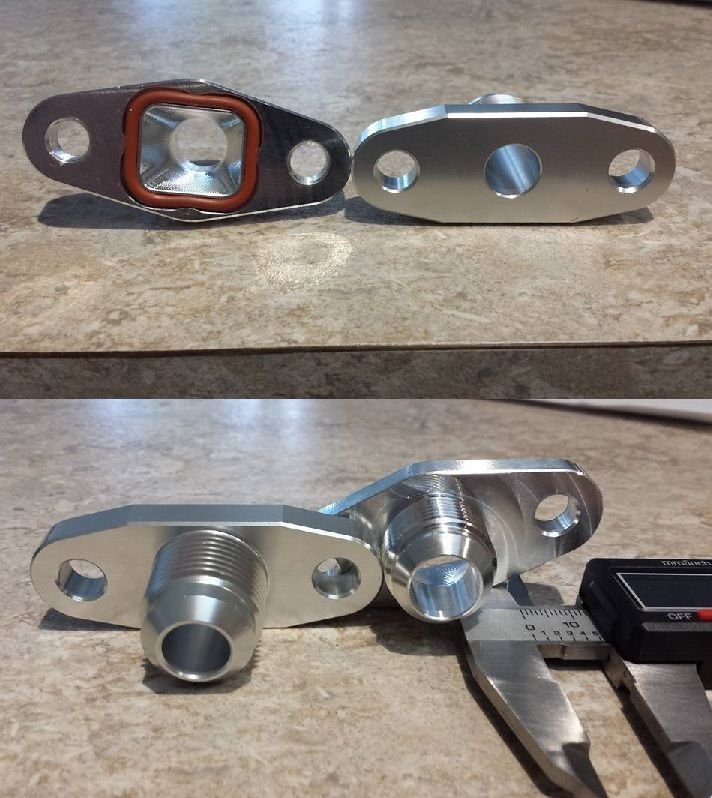

Only Turbos that seem to be finiky are the Precision JB... After tons of talks with people in the know -4 and .060 restrictor was best it seems. T46266. I put a inline T'd Gauge at turbo and monitored oil pressure to get the talked about desired pressure.
Turbonetics, Garrett, Borg, Comp, FF thought all either gave exact what feed line to use or some sort of restrictor already installed to use? for JB. They all seem to have better/stronger internals then the Precision JB line.
I know my old SC6176e Precision had no issues back in the day cause they used Garrett internals then.
-10 drain seems to work for most. However most say need atleast -12. I like the -10 CnC funnel that I am using below with a O ring as a gasket. You can also see in the picture the cheaper china flanges use a much smaller diameter hole 1.5+mm smaller...
