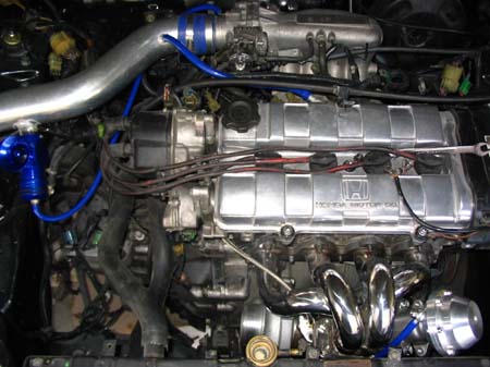

the actually pictures come from
http://cgi.ebay.com/ebaymotors...33742
My question I see that the valve cover port is connect to the charge pipe... on my setup I have the valve cover port connected to the intake.
Which is the correct way?

intake. you dont want to pressurize the crankcase.

Yep. the way in the pic is HORRIBLY wrong. lol. and yes. you ahve it right. connected at the turbo pre intake pipe.

Here are the options,
A. connect the valve cover port to your turbo intake pipe
B. just put a small breather to the port
C. connect that port to a oil catch can
The engine in that pic is not complete, if you look at the injectors they are not hooked up. But I am curious when this guy/gal do get it running like that.

Maybe he's running in N/A with no boost hehe

hes also got the BOV hooked up wrong, i tried doing that **** and my bov couldnt get vacuum to work.
Blah that is one screwed up picture.

Lol wtf? he has the line hooked up to his charcoal canistor line.

That **** is SUPPER FUNNY
It will never run right like that
You got it hooked up right dude

isnt that just for blow-by? i dont see the point of rerouting that back to your engine...

Emmisions and oily mess
It is nice to have a vacuum source but most dont
I will be using exhaust as a vacuum verry soon
