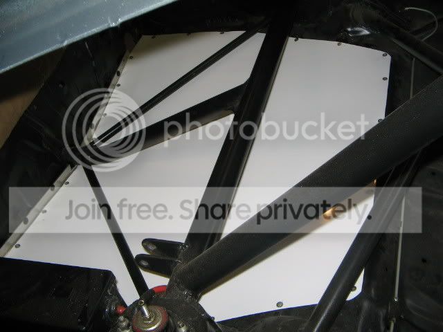

my ghetto back half effort
this is my new setup. old stock sleeve motor made 435whp, and ran 10.43 @ 137 in a shitty ghetto ef hatch. i love the b16, they dont make enough torque to break drivetrain, lol.

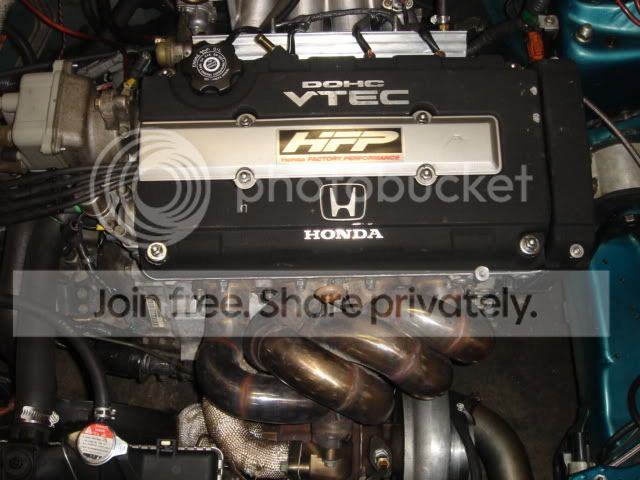

The Setup:
B16a
Stock Sleeves
Victor X Intake Mani
Wiseco Pistons
Crower I Beam Rods
Block Guard
PTE 880cc Injectors
Aem fuel Rail
Walbro 255
B&M FPR
Garrett 60-1 S-cover anti surge housing
Turbonetics Evolution WG
AFI Ramhorn Manifold
ACT solid Disk
XTD PP 1900lbs
HKS SSQ
3" Down Pipe
Stock head
Total PSI was on 23lbs. This car really gets mad with 195's on th front traction im sure you can guess is not there!
This was also done on a Dynopacks as well
here is the goodies
The Vid:

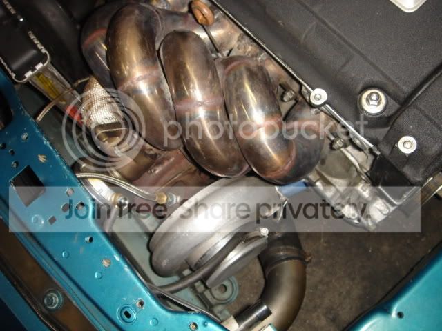

The new manifold:

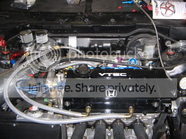

my B16A:
B16A - stock bore/stroke/sleeves
forged pistons/rods
compression - 180psi across (9.0-9.2:1)
gas - Costco 92oct
snail - Turbonetics 60-1 T4 'P-Trim' (thats all i know about it)
tuning - Dave Lee playing with CROME PRO
boost - 18psi...
cams - NA cams 255/248 duration 12mm lift
and whatever else you can see from the pics
why a B16?
77.4 FTW
