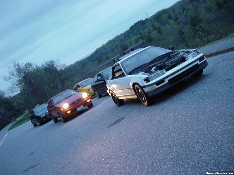

here's some pics of my kit i made in one day, it is really fast and spools incredibly nice and at 5500rpms on my stock b16 with s1 tranny. running 7 psi with stock injectors and a 12:1 fmu, i have the safc hack with 440cc's ready to go on though. I started last saturday at around noon and had it running good by 11pm, not bad considering i made the manifold, flanges, piping, and installed it all that day. It's really fast, i was sort of surprised how hard it hits all of the sudden.
Setup includes
1/4" think steel manifold $60
kkk26 turbo $25
dsm sidemount intercooler $20
audi external wastegate $12
dsm B.O.V. $30
2" piping w/ couplers $50
oil and coolant lines and fittings $30
dsm injectors $50
gaskets, oil, and misc. $100 (over exhagerating)
total= under $350

5500 is perfect, if it were any lower it would be spinning the tires non-stop. the turbo isn't really that small(in comparisson to your typical chrysler or subaru turbo that i'm used to seeing on junkyard setups.) It's off of a late 80's early 90's audi sedan. the car in the background is my girlfriends.

thanks for the compliments. i believe it was a 1990 audi 5000. i like the wastegate as well! I agree that she has great taste, her last car was a crx w/ a full kit and a b16. the teg has a b16 in it and is most likely going to be turbo soon as well!

yeah, it's all schedule 40 steel weld elbows from a plumbing supply store. I love ghetto style as well, funtion over fasion right.lol here's another ghetto style car that belongs to my friend evilxkid.
