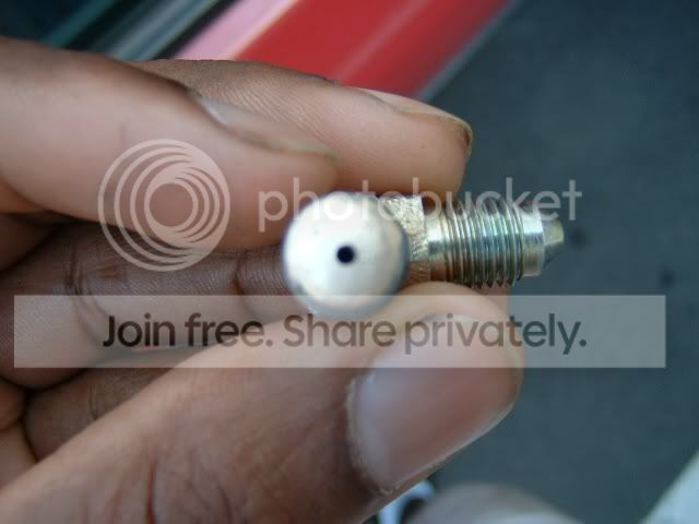

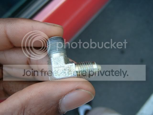

I know you dont want to weld or anything but "bubs" idea is actually a good one. I also had that problem with the turbo leaking on a -3an line so what I did wa had the oil inlet fitting welded on the bottom and used a 1/16th drill bit like what bubs was talking about. Now I dont have to wait for over a week for a restrictor to come to me in the mail plus $14+. Here are some pics:
Oil inlet fitting for turbo side view.
Had it welded shut then I drilled a 1/16th hole in it.
