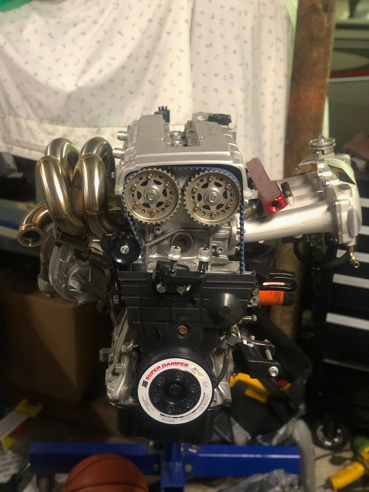

Old 02-22-2019, 01:05 AM
Join Date: Jan 2012
Posts: 66
Default Re: Nut4vette's EM1 Turbo B18C5 Progress Build
Took everyoneís advice/opinions into consideration and ended up selling the pro 1s and buying tuner 1s, I looked into sheepey built, Klm fab, and speedfactory for thei a/c compatible ramhorn and ultimately went with speedfactory, and that will be paired with a jb 5858 that I got from ht marketplace, so now just need to get turbosmart comp40 or tial mvs 38mm wastegate, and Intercooler, make Intercooler pipes, and a little more fuel components, what you all think? Any input on the parts I still need, gonna get 1300cc injectors and a walbro to 450lph pump, think that will be plenty for 500whp on e85, what about ic, brands you all prefer and all that
nutz4vette is offline

Old 02-22-2019, 04:27 AM
maxwellmercer's Avatar
Join Date: Sep 2008
Location: LoadedForBear,IL
Posts: 2,086
Looking good! I just got my speedfactory manifold a few weeks ago and it is fkn beautiful!
