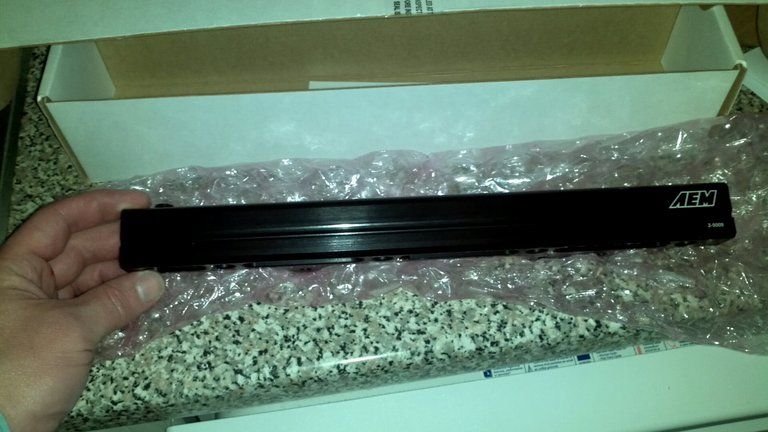

The AEM fuel rail I got is blued although they've told me to send it to them and they'll inspect it and likely replace it.

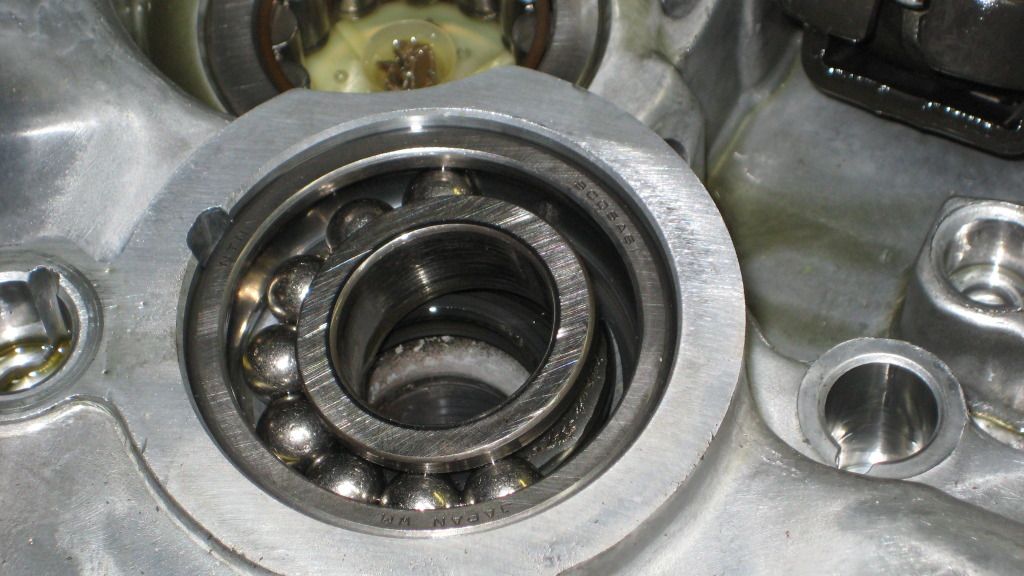

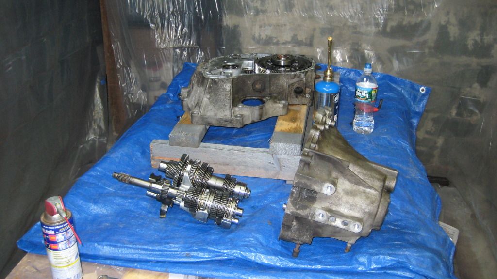

Pictures...
Tranny
Crapped out ISB

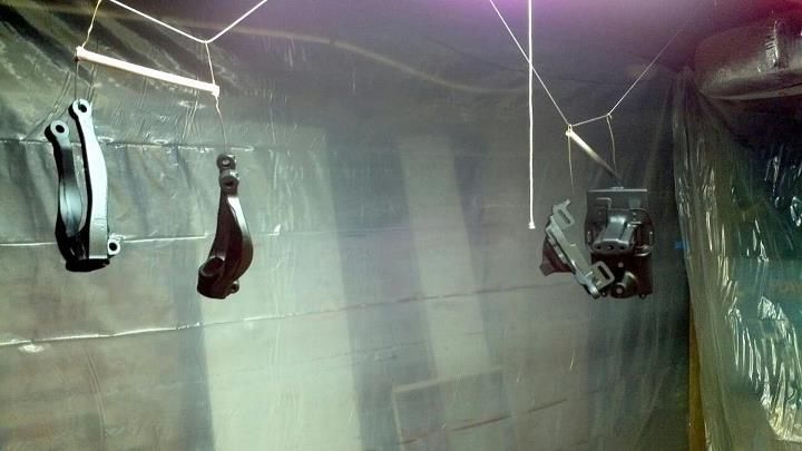

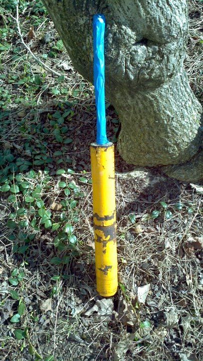

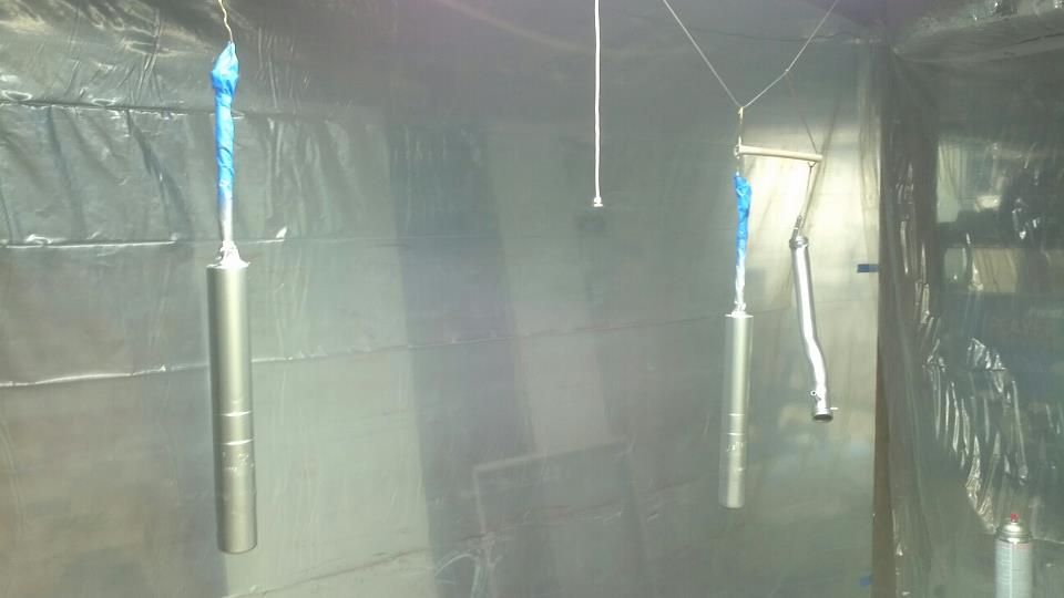

I've managed to do a couple other things... My GC/Koni setup was getting rusty and I had the old style sleeves/collars with seized up lock bolts... so I ordered new style sleeves/perches... Meantime I stripped and painted the front shocks:
Before
After
Some misc. parts I also painted:
So I have the ISB and oil seals on order, 2 of my ARP washers for the headstuds went missing so I ordered 2 of those. and I have to send out my AEM fuel rail.
This weekend I'm hoping to get the trans fully stripped down to the shafts, clean EVERYTHING and get it all back together if the ISB shows up in time. Otherwise get everything else re-assembled and ready for the ISB.
I only have friday and part of saturday to get anything done.
I have more pictures of more stuff I've done but like everything else my laptop and camera are both being ridiculously moody.

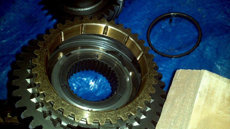

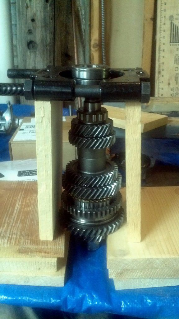

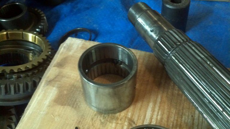

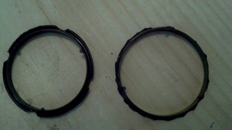

Should have ordered the friction dampers with the ISB and seals... everything is all apart now, I'm glad I took the time to clean it... it was filthy and several of the oil orifices were clogged. A bunch of the gears/collars had thick muck built up between them and the shafts...
this is what I used to get the bearings off the countershaft, after those are off you can just use wood under the gearsets to get them off the shafts.
Messed up upper damper, lower one was fine:
Some bits of the bearing gate that were stuck between synchros

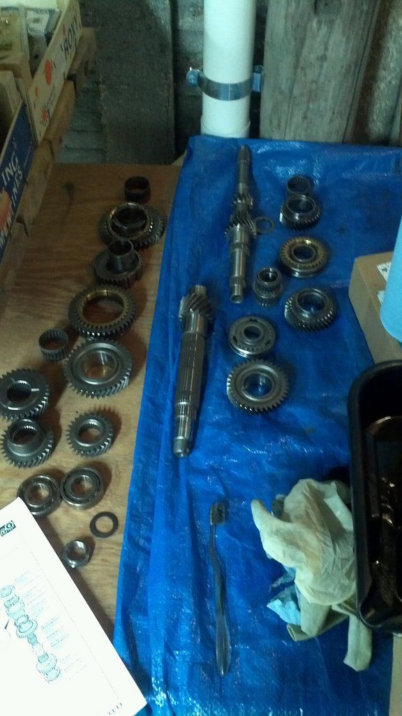

oil/plastic/metal **** that was blocking the oil valley of this collar:
Everything all clean:
Diff, counter, and main shafts are sitting in a freezer, I'm going to order the dampers and hopefully have everything buttoned up next weekend fairly quickly.

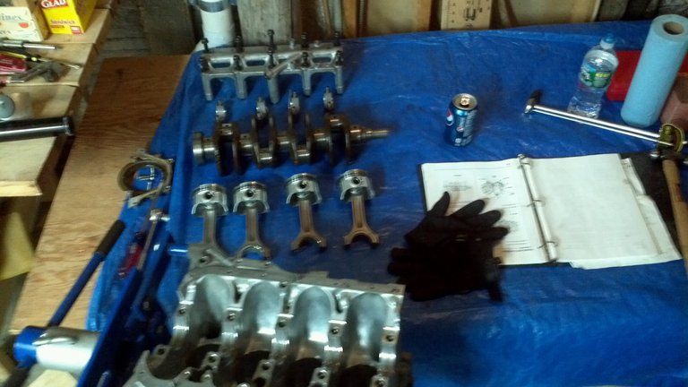

Trans is done, LSD in.

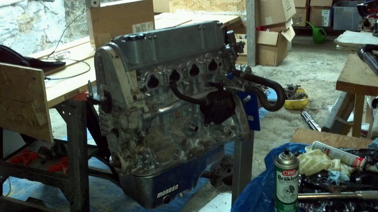

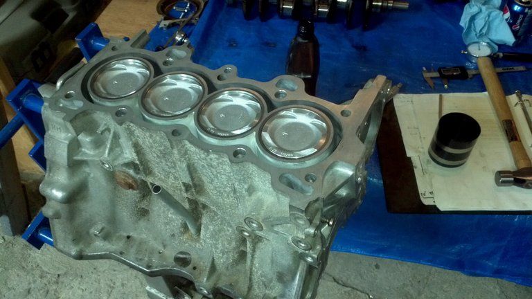

I stripped apart the engine:
Measured the offsets of the pistons and double checked the P2W clearances which are right around .030 which I think is good... I was leaning towards a little looser but I think it's going to be fine.
The common knowledge of pointing the arrows is correct. the offest is towards the intake side of the piston so they go in facing the FW.
I switched them around and torqued everything back down.
That is basically it. I should be ready to install everything in the car this weekend and maybe even get it started up stock.

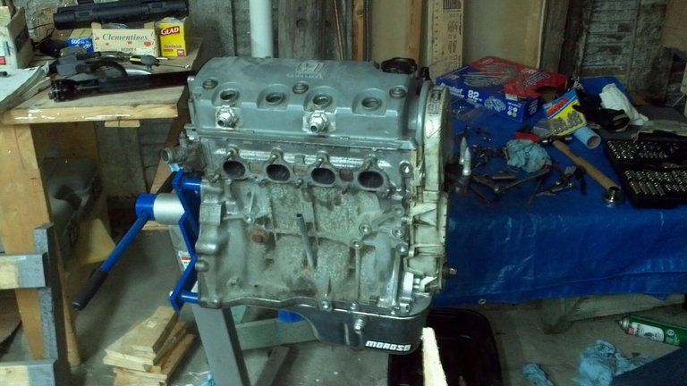

I didn't cc or clay the motor, I don't have a buret, so I figured using a 10cc syringe over and over wouldn't be very accurate and I just want to get it running at this point.
I did get a new torque wrench and re-torqed everything. bottom end is all buttoned up torqed down the head, adjusted the valves, and installed the water pipe and black box again for now.
Going to install it with a stock z6 intake manifold and header and break it in NA more for fact that I don't have a tune for the bigger injectors. Plus I will have to smog the car to get it registered so I figure I'll just get that done while it's as stock as possible. Most shops don't care but some do and would fail it if it had a turbo on there even if it passed smog.
Here she is no intake or exhaust, still need to put on the FW and clutch/pp too...

Hey why not, I stripped it, cleaned it, and reassembled it again instead of getting it into the car.
This time at least I'm 100pct sure everything is right on. Break away torque is like 9 ft/lbs it turns like a pat of butter on a hot pan.

AEM sent me my replacement fuel rail. The Black Ano coating purpled for some reason but the FPR which was bolted to it didn't... no idea.
Yay.
I'm going to get some work done this weekend and maybe have a startup vid.
