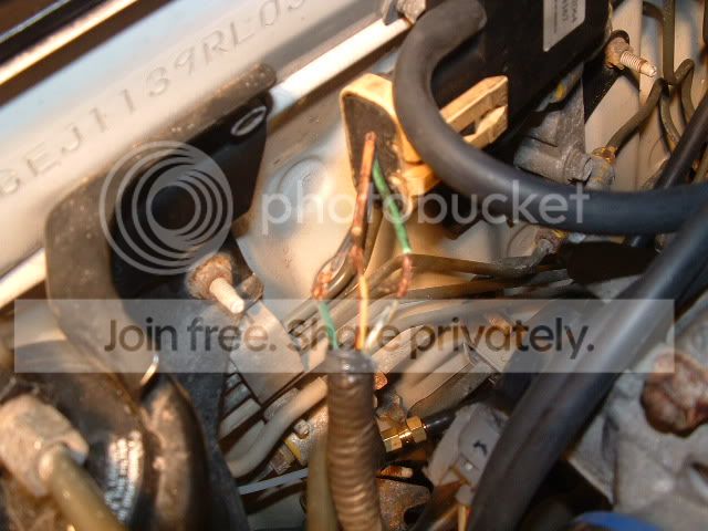

ok according to hondata.com website, 3bar voltage from map wire to gnd should be 1.6v (rather then 2.85 on a stock map)
I used a multimeter to test that and i found that mine reads 2.38v
what's wrong here?
here is my wiring (not soldered because i just rewired and im still testing)
Does anyone recognize this 3bar? i bought it off a h-t member....
what's wrong here?

I have seen many 2 bar and 3bar map snesors. I have never seen one like the one you have that is claimed to be a 3bar. You should have 5 volts at connector C (Yellow/red wire on your harness) and 1.6 volts at connector B (white wire on the factory harness) if it is a 3 bar. You got a reading of 2.38 volts though so, I am wondering if it is a 2bar? Keep us updated on the info you find out and we'll help. Have you ever actually seen the basemap you have in your car?
