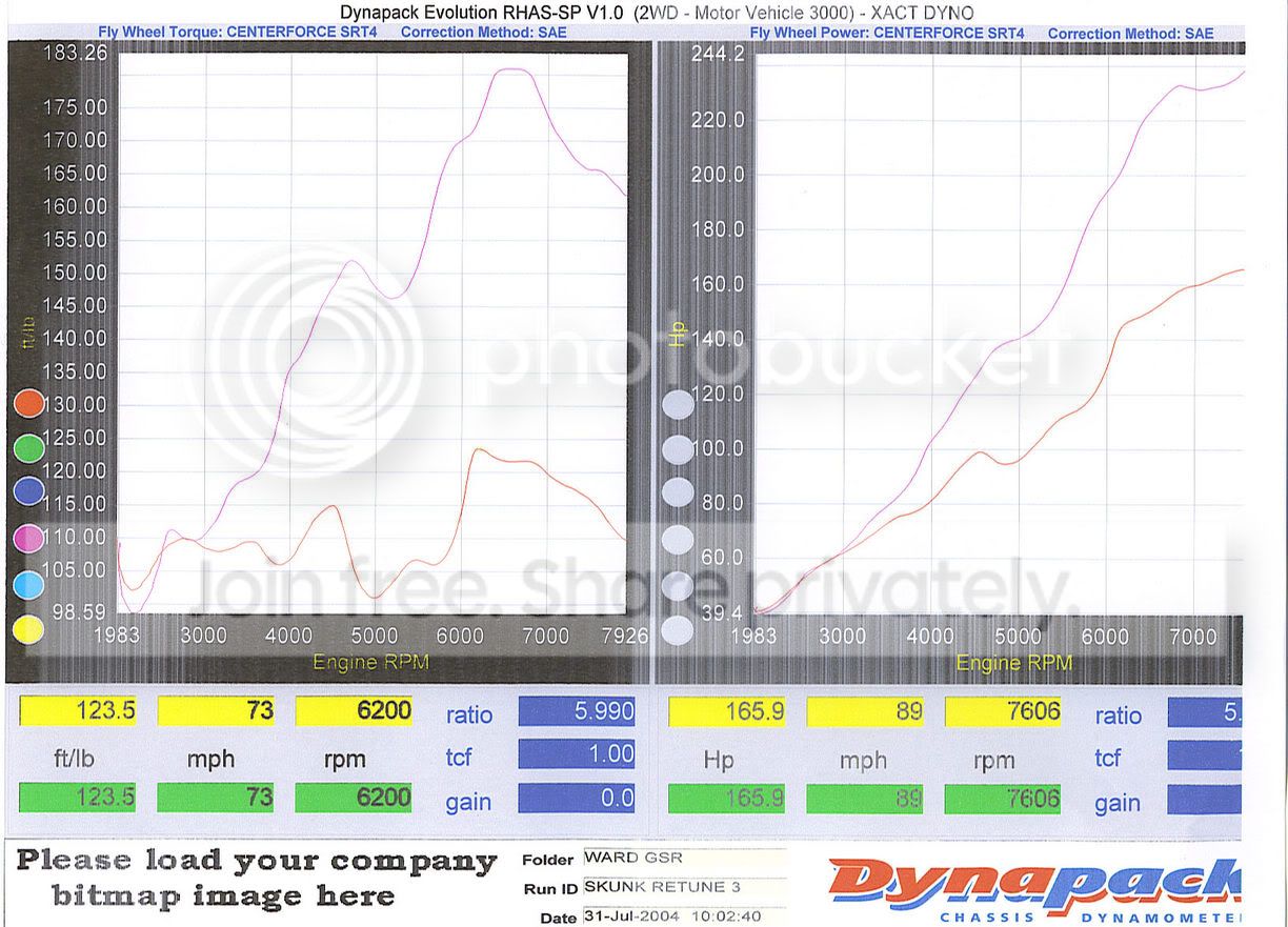

this a Vortech "Type R" kit running 6.9 psi with the aftercooler
mods-
B18c1
00spec ITR cams with Eibach valve springs
5zigen 4-2-1 2.5" header and and 60mm exhaust
MAXBORE 64mm TB
Skunk2 IM
magnaflow cat
VAFC2
the second graph is my N/A set up vs SC
vtec change set @3500 rpm

no offense, but whoever tuned that NA setup sucks ***. Also, the torque curve on the SC setup could tuned a little more.

"turbo on a stick"
Haha... nice plot for LOW pressure level

I made like 4 passes on the dyno.... it was a quickie tune just to make sure everything was ok
I had to drive to the Falken Drift showoff in Irwindale that same day
I will retune in a week or so.....after the smaller blower pulley arrives
