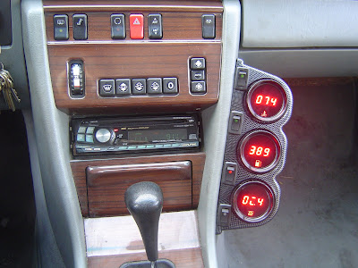

Default Re: mechanical or electric boost guage
Originally Posted by wantboost
Iirc tru boost is a gauge and boost controller in one. Totally useless if your ems supports boost control.
If you want the EMS to do that. Some of us don't for a variety of reasons. That's why TurboSmart had created these years ago.
