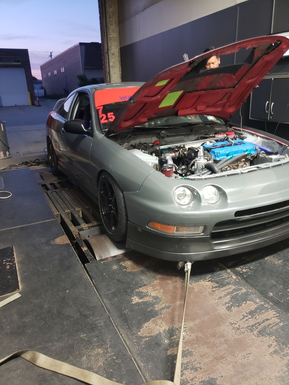

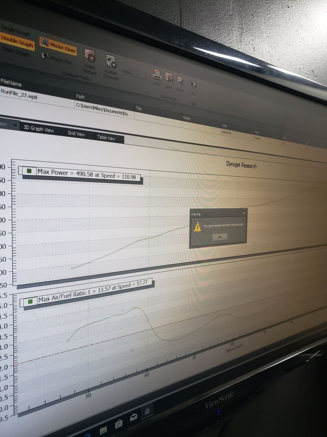

Well guys, I think it's safe to say I hit my goal! 490whp/330tq @19psi The car feels like an absolute monster and I'm so happy to have it finally tuned.

Very nice!! Congrats!

A few questions - did you tune on E85 like you planned? You mentioned in the first post about doing a high boost and low boost toggle switch - is that still the plan?

DaX- Yes, the car is on e85. I've actually only ever run E85 in this car even all motor. Unfortunately I'm having creep issues, so we were not able to do a high/low switch like I had anticipated. That is still the plan for the future though!

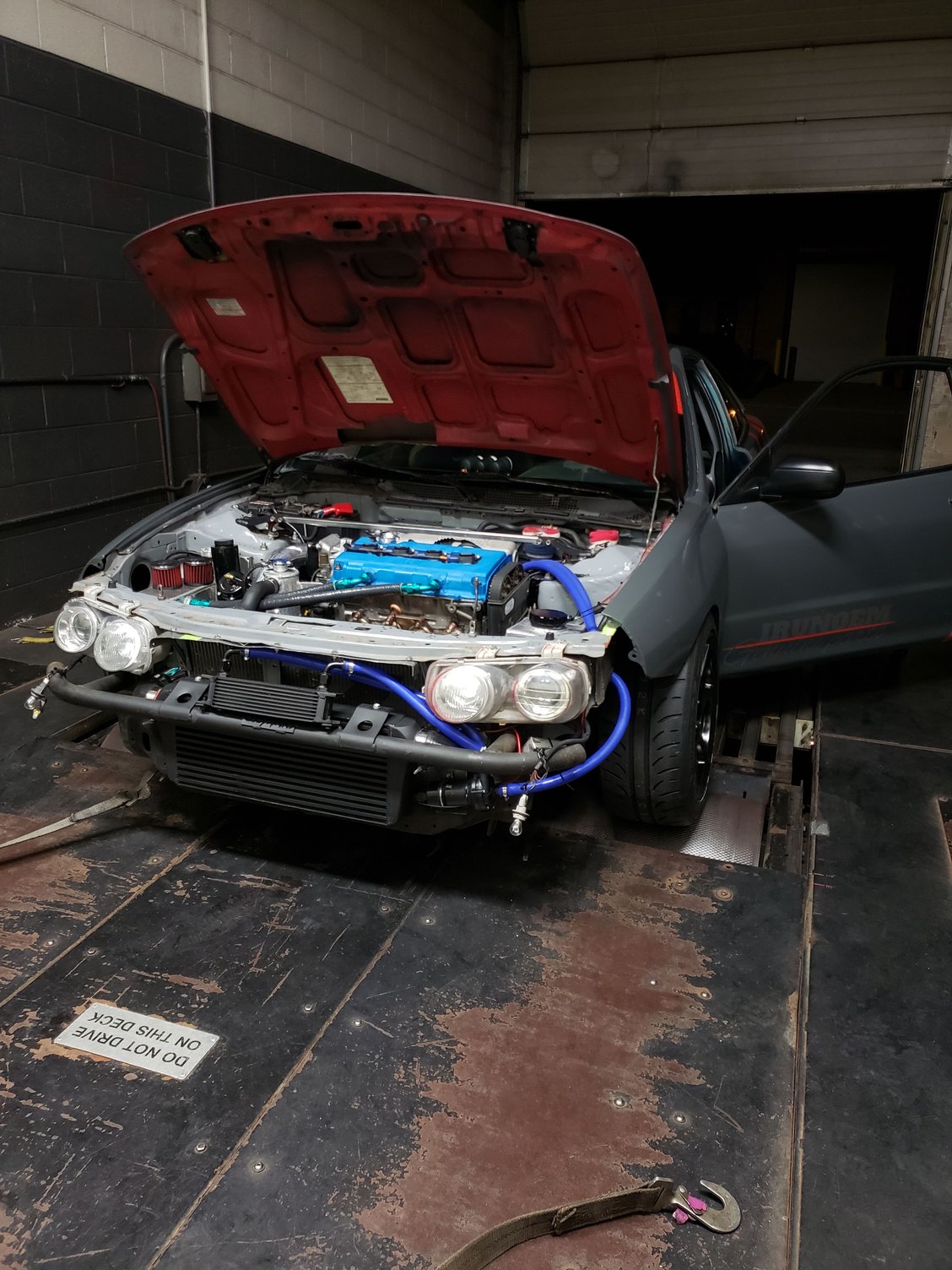

So, we were having creep issues on the dyno. I have what Tial says is a 8.7 psi spring installed. At this point the mac valve is turned completely OFF. It doesn't creep to the moon immediately but slowly ramps itself up through the powerband.
Do you guys think the 38mm is too small for my application? Is the .63 exhaust housing not moving enough out for the wastegate to keep up?
I also noticed that the speedfactory manifold doesn't have the wastegate "runner" tear-dropped going into the merge collector.
My tuner and I (Mikey at Mspec Tuning) were thinking the combination of the manifold design and wastegate size is causing my issue.
Forgive me for this somewhat n00b post but I don't want to modify my manifold, throw a bigger gate on and just expect it to fix the issues by guessing.

Sometimes, brother, an educated guess is all we have.
If it's slowly and steadily creeping, I'd say it's gonna be a gate/manifold issue, especially by the symptoms you describe. If it's something like, instant spike and ending at boost cut, your gate isn't opening at all.. That doesn't sound like your case so.. Anywho.. Methinks a larger gate would help mitigate a poorly designed manifold.

I disagree. If that compressor cover is being used as the vacuum reference point for the side part of the wastegate, its your reference point that's causing the boost control issue. Relocate that vacuum line to the intake manifold and plug the one up at the compressor inlet. A lot of creep issue occur because of that connection , despite what the interwebs has you believe. Try that first. then look to ignition timing and see if it's too far retarded before target boost pressure.
But I've had that exhaust manifold style/type and wastegate combination work perfectly on countless setups. Ain't nothing wrong with it.
This is very reassuring! You hit the nail on the head, my source IS the compressor housing. Funny because I just read a post on here AND commented on it saying I needed to switch mine to the intake manifold. Welp, I forgot.
It would be super awesome if this simple fix solved my issue! I'll try it and report back. Thank you!!
