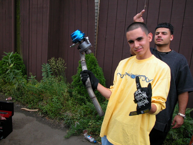

ill start and say that it fell off becuase i didnt use a thick weld el, just regular dump tubing, the nickel welds holding the steel/cast are perfect, ill probably take it apart today so i can re weld a dumb thick pipe, ill find some schedule 40 at my neighbors machine shop and that bitch aint never falling off, luckily it was 1/2 mile before the englishtown exit, so a muffler shop was able to MIG it temporarily so i could make it from CT to MD and back, this was on friday, but just letting you guys know, use a thick piece in case you didnt

that looks like the ***** how much noise did it make dragging the on the road..

what did you do? modify a manifold to accept an external wastegate?

it didnt drag, we stopped for gas, were cruising, i let go oif gas and it sounded louder, forst thought was the plate of my dump tube fell off (exhauts dump tube not WG dump), then i hit the gas again, stopped and it was hanging by the manifold/vacuum line, so it didnt drag

you can weld to a cast manifold

<TABLE WIDTH="90%" CELLSPACING=0 CELLPADDING=0 ALIGN=CENTER><TR><TD>Quote, originally posted by rjardy &raquo;</TD></TR><TR><TD CLASS="quote">what did you do? modify a manifold to accept an external wastegate?
Rob</TD></TR></TABLE>yep, they are cast and didint come for external at the time, so i drilled it and had my neighbor (machinist/TIG'er) weld it up with nickel, cause you gotta use nickel when welding steel to cast, thethin pipe itself cracked, that was the main fault

<TABLE WIDTH="90%" CELLSPACING=0 CELLPADDING=0 ALIGN=CENTER><TR><TD>Quote, originally posted by intercooledJRSC &raquo;</TD></TR><TR><TD CLASS="quote">you can weld to a cast manifold </TD></TR></TABLE>ummmm yes you can, ask FFgeoff, you use nickel if not a high content nickel alloy
edit for a javier pic and quote
quote by javier " ya buddy...
another of ffgeons beads, high nickel filler used on a T4 vband housing
told ya so, loks liek cast, and looks like steel to me
