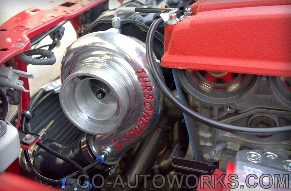

sample for you, you can see the wrapped lines running in front of the manifold (I mounted the sol in front of the motor mount/behind the headlight)
Very Nice! This Pic also just reminded me to pick up a Turbo blanket, filter, and those clips to route the air/oil lines neatly. Ill be placing an order with you guys tonight. I want to mock up an old air filter to see that it'll fit properly.
