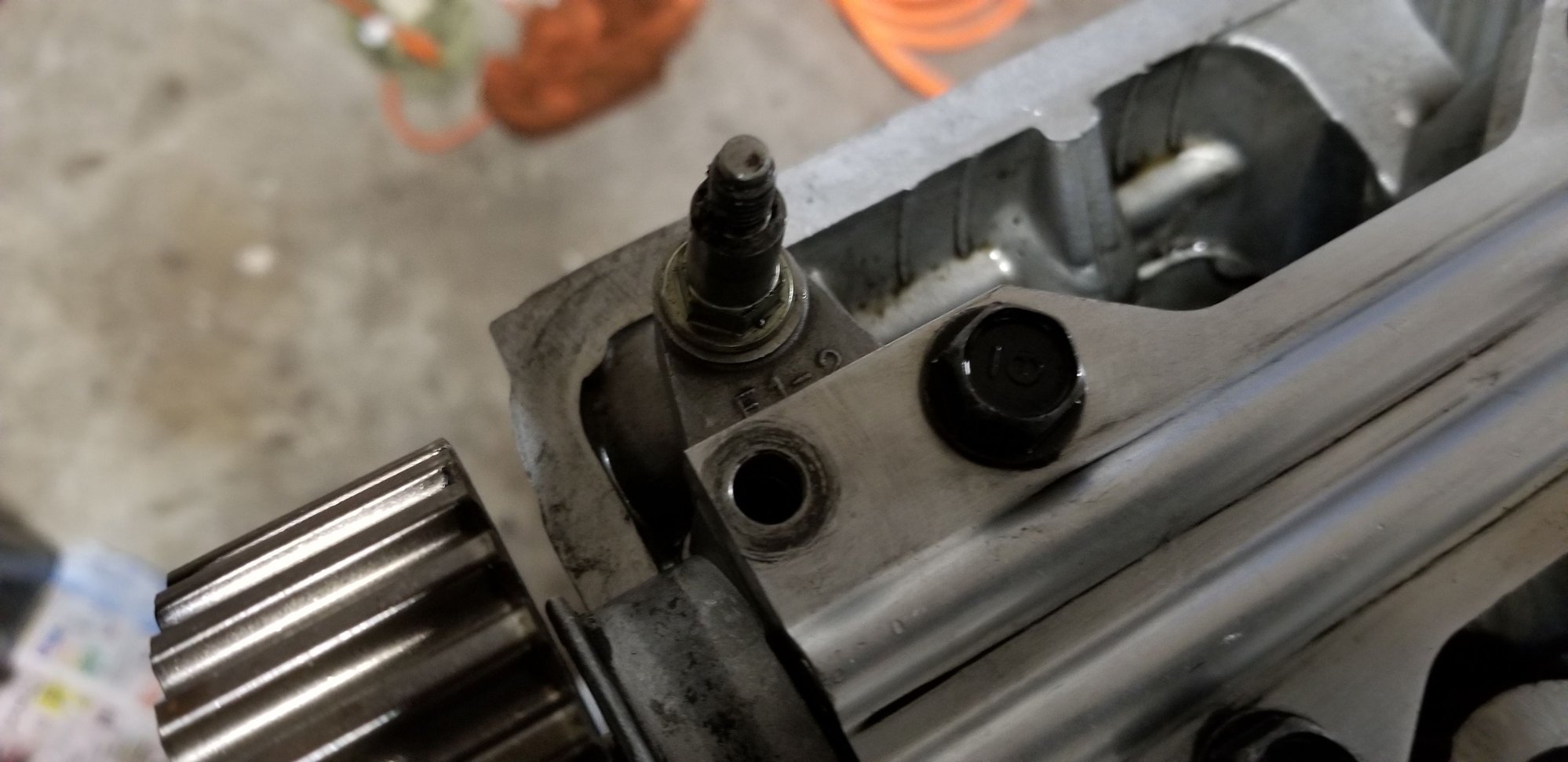

thanks! I was on a roll until recently. I installed the new toda oil pump gear in the oil pump, installed oil pump, rear main seal with cap, windage tray, pickup. Then i realized that the old oil pan needs to plugged for the turbo oil return line. I didnt wanna mess with taking it to anyone. So I ordered a Moroso pan. While I'm waiting I thought let me install water pump.....Then boom.... The block has an old broken bolt inside one of the bolt holes for the water pump. I failed to notice this before when I bought the block, because it didn't have an water pump so I didn't bother to look. Sucks *****.
worst part about it, is that I tried to use a few different bolt extractors to pull it out and none of them worked. And the dumbest thing I did is hammer a small flathead in the hole I had drilled. I turned it, and boom the flathead tip snaps and stays in the hole lol.
now I'm looking at drilling out the entire bolt and tapping for a 1/4" screw, or just throwing one of the old pans on the block and taking it to a machine shop to professionally tap the hole.

if youre able to, take it to a machine shop. something similar happen to me when i snapped a bolt that holds the cam shafts on my p72 head.

+1 for machine shop, just to end your headache there and avoid possibly damaging it more.

Yea after long thought in my commute home, I decided to just prep it to take to a machine shop. So today, I screwed in the old oil pan. I'll just carefully place it on the taco bed, and tie down/strap it. Machine shop is less than 1/2 Mile away. Won't be For a few days until I can take time off work to take it during their business hours. In the meantime. I'll work on the other odds and ends on the chassis, as well as paint the valve cover. Kteller exhaust arrives Thursday too.

So the machine shop fixed the threads to that water pump bolt last weekend. They did a great job.

Yesterday, I started painting the alternator brackets, head and other misc, attachments. Then I installed the correct headgasket and seated the head. Torqued down the ARP studs. Began to install the cams (with new seals) and caps. Then the last of the 10mm bolts snapped on the first turn of the torque wrench at 8 ft lbs.
I think it was probably over tightened by the last person who torqued them down. and made the bolt weak. Good thing the I never tightened it down, so I was able to chase the threaded half out of the head with a small flat head.
So now im left waiting for a new oem bolt I ordered.

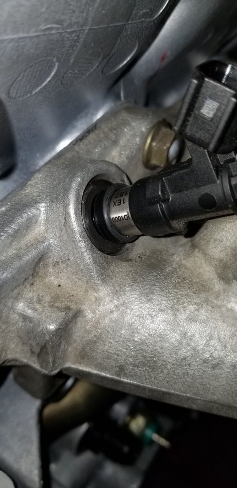

In the mean time, I decided to install the intake manifold, aem fuel rail and id1000s. Ran into a couple of snags here. The skunk2 intake manifold has a broken bolt inside the middle threads thats supposed to hold in the fuel rail. The previous owner ran the fuel rail like this. Im not sure how I feel about doing this. Also I purchased the id1000s second hand and after attempting to test fit them, I realized theyre too short, and that the previous owner didnt give me the top hats. So I ordered these as well. If im not mistaken....research told me I need the blue top hats to convert 48mm to 60mm with the 11mm top. Also im not 100% sure about all this, but I have the thick injector o rings that sit in the manifold. Am i supposed to use the fat orings on the bottom of the injector? or not use them and theyll slide in on the part of the injector thats marked with the brand and model# once I have the top hats installed?

Its been about nine years since order my id1000s. But im pretty sure b series used blue tops. And oem obd1 orings for mounting in the manifold were recommended from injector dynamics.

Good blue top hats are what I ordered, and I already have the obd1 orings. Hopefully Im not doomed with any more broken bolts

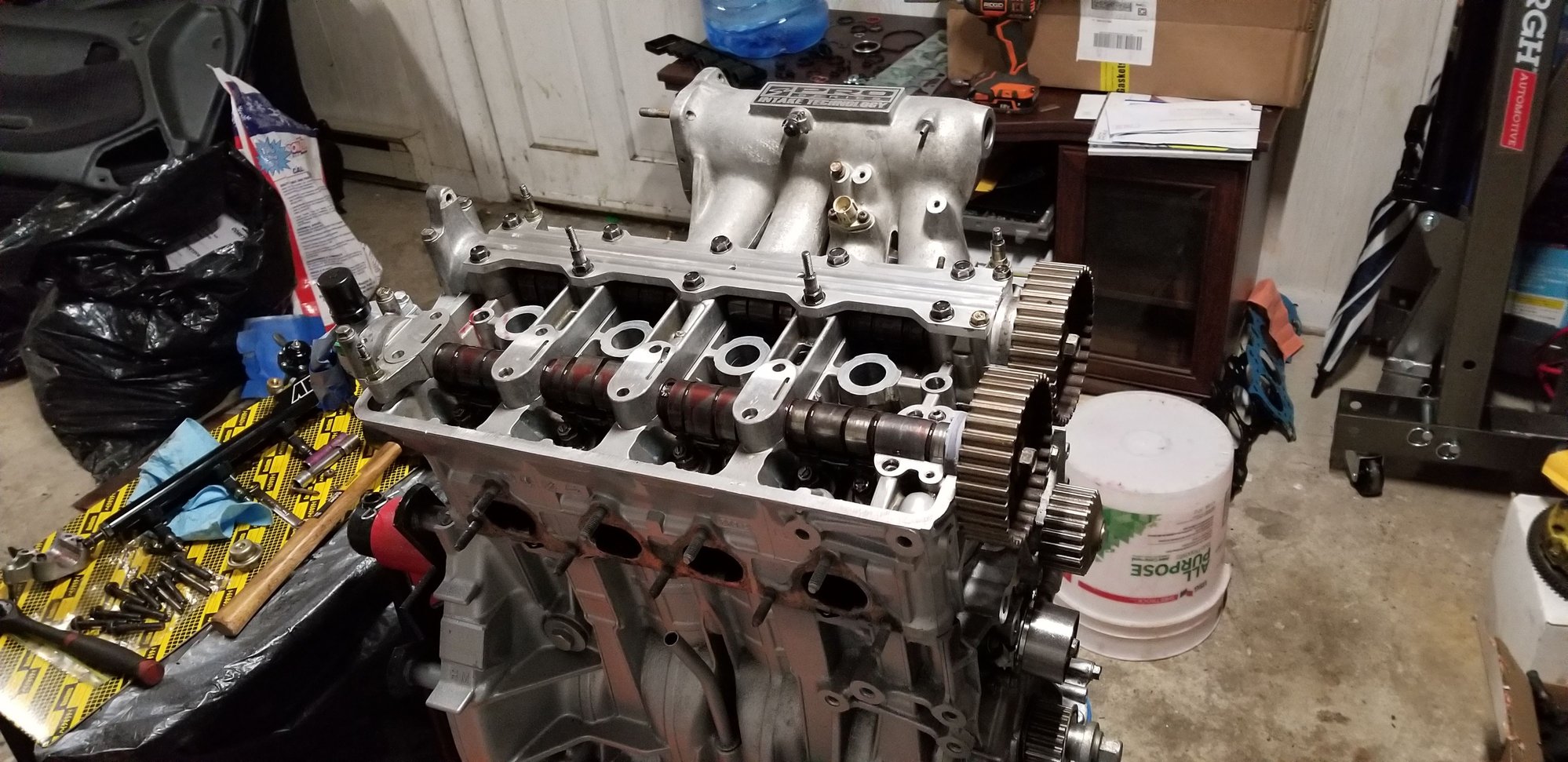

So I was able to get another oem bolt for the cam cap. All torqued to spec. Finished my crappy valve cover paint job lol. Finished assembling most of the engine. the distributor block off I bought wasn't the right size one, I have an aftermarket distributor, just gonna use the stock cap for now. The injector top hats I ordered weren't the right ones. So I sourced a set from someone on a FB group. Waiting on that. Also missing some AN fittings to properly attach the turbo oil lines, also missing the long bolts for the top timing cover.
While I wait for all these things. I pulled the chassis back in the garage, started cleaning up surface rust on the subframe with a light sand, and used a black rustoluem rust paint, then added regular semi gloss. Not necessarily improving the look in the engine bay, but It'll prevent problems later on. Also started converting the fuel lines in the engine bay to AN lines. As well as start mocking the bosch044 and GM ethanol sensor.
While doing this I remembered that the vacuum fitting on the back of the intake manifold popped off too easy when I was pulling the motor. I was thinking of stuffing it back in with teflon tape. Any other suggestion is appreciated.

I finally received the blue top hats. They fit perfectly. I'm not crazy about how the injector sit in the o rings in the manifold. I'm using the thicker obd1 orings. They fit kinda snug. When I tightened down the fuel rail they looked better kind of. I guess I'll find out when it's running.

thanks! It's pretty much done. Will soon have to start posting vids. Was trying to slap on flywheel/clutch/ pressure plate and tranny today, but had to have some fam time.
