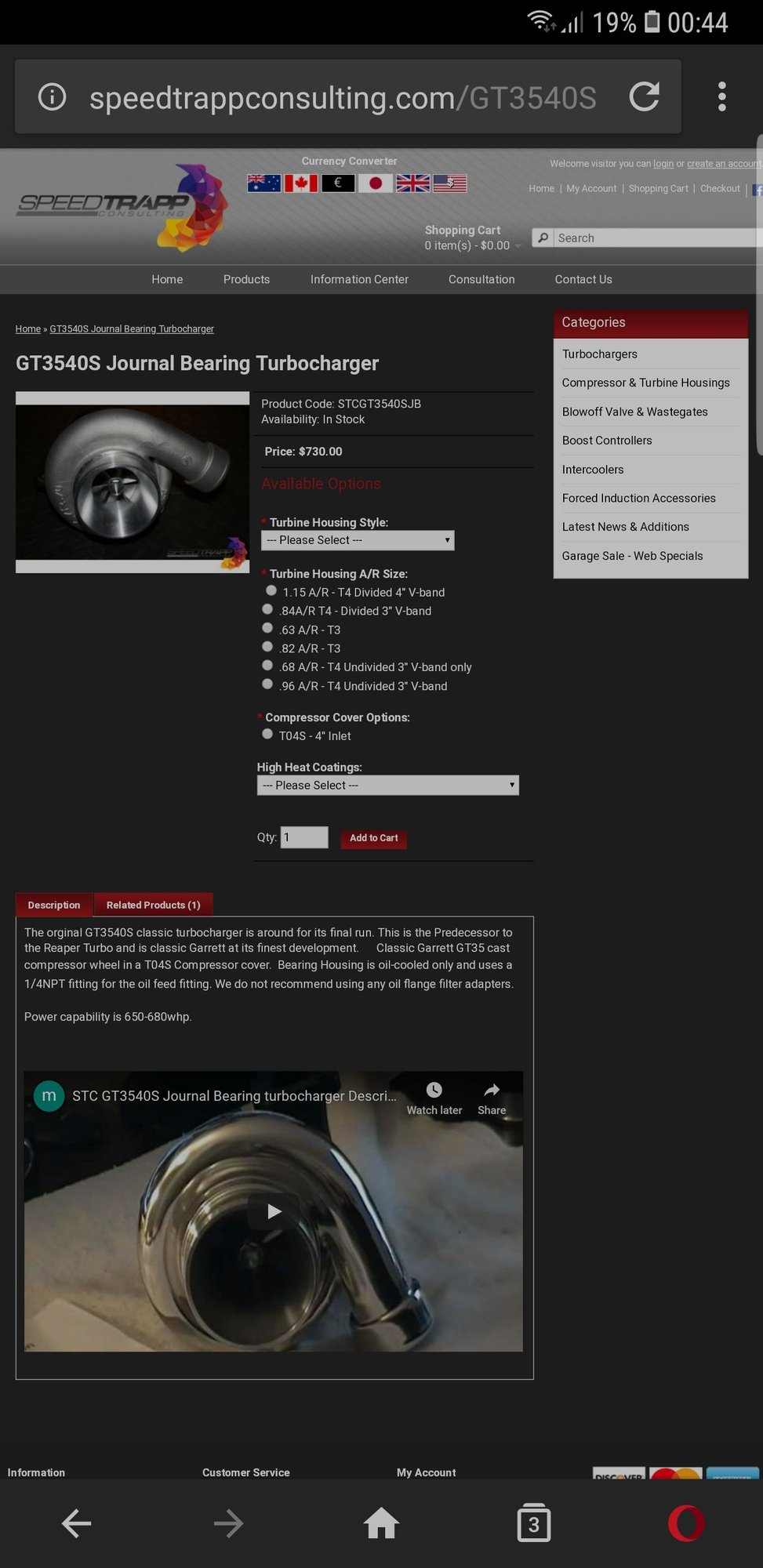

hpw1707's Avatar
Join Date: Dec 2018
Posts: 4
Default re: hpw1707's LS/VTEC quest for 450-500whp "street monster"- turbo education required.
hpw1707 is offline

Look my man. 450 to 550 is a very different target.I can undestand you cant be sure because target is difficult.
Id say Get GT3540S at t3 .63 housing and IF you want more later you can loose some spool and get some 50-70whp more power by going for a .82 housing.Thats the safer bet. Ive seen 500whp with a gt35 on .63 but that was almost maxed.
It was ok on spool toO and that was on a 84mm B16 that most of the times suck at spooling big turbos.
At least down the line you still have the option to go bigger with small cost.
A good middle ground is s257 sxe with a bullseye t3 .70 a/r housing. its like a GTX3576.It will not hit 550 wheel hp on pump gas and i believe you must go very big to hit that power
on 93 octane. s257 sxe depending on dyno in .70 a/r will hit around 480-500 to the wheels . But thats it. You cant go bigger after that since the turbine housing is allready big.
