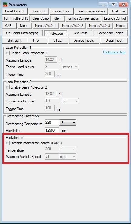

Bix VT May 9, 2012 05:33 AM
Re: How hot is to hot for engine?
Originally Posted by b16racereg6 (Post 47315531)
look under the protection Tab, It will say Radiator fan. Then you can put in the settings you like. Hope it helps ya.
You can also set a overheating protection.
Yup, here's a screen shot:
http://img.photobucket.com/albums/v4...in/s300fan.jpg
Also, if you click "Protection Help" it'll give you a concise description of what each option does. So much nicer than Megasquirt...
MalcolmV8 May 9, 2012 06:28 AM
Over heat protection is the last item on that screen, I've checked it a ton of times. I'll guarantee all I had to do was scroll down lol. Now I feel like an idiot, gonna check that tonight when I get home.
