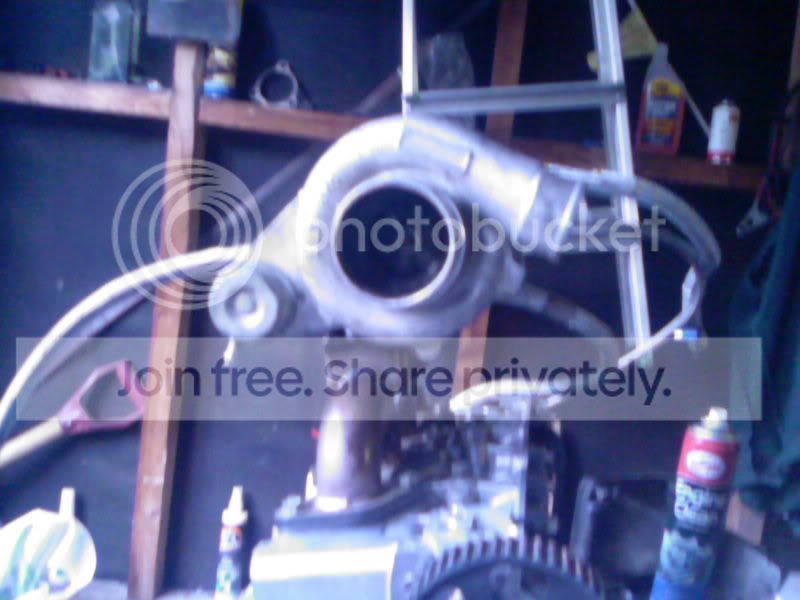

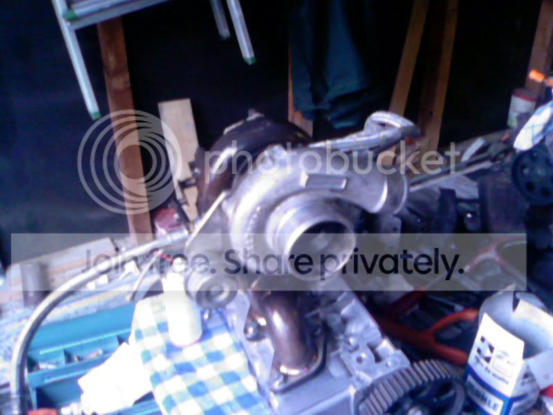

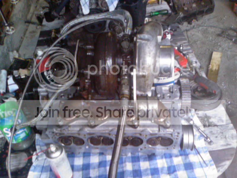

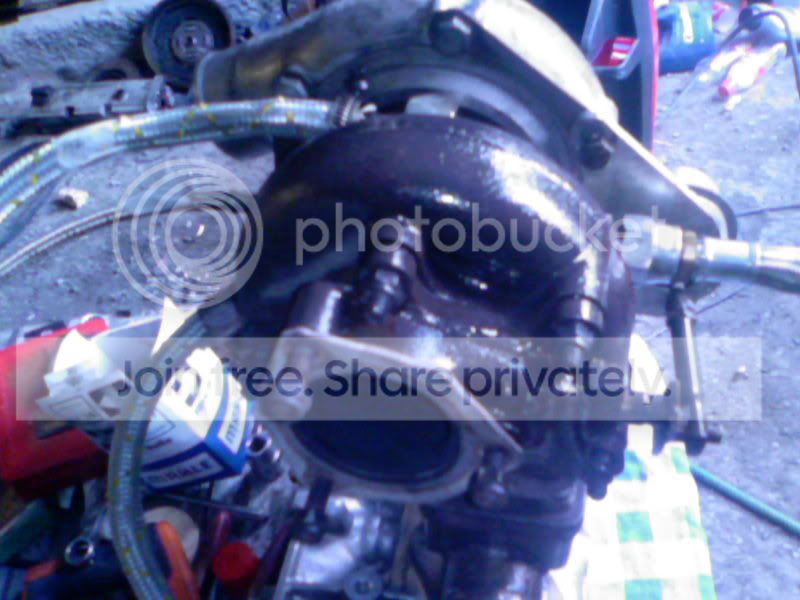

Help identify this bb Garret T3-flanged turbo
Old 08-28-2007, 04:30 AM
polo classic's Avatar
Join Date: Aug 2007
Location: OSLO, OSLO, NORWAY
Default Help identify this bb Garret T3-flanged turbo
inlet: 76mm/69mm
-Outlet to intercooler: 52mm/45mm
-Exhaust downpipe: id 51mm
12 fins on the inlet side
10 fins on the outlet side
Turbo was bought at ATP, but they could not tell what it is when the buyer emailed them now
Garrett serial11010504) 755246-1
Turbo was actually ordered for a VW G60 Turbo kit, but is now fitted to a 16v. It was ordered in place of the T3 60 to spool faster....
It is also physically quite a bit bigger than the T3 (T34) used by Ford in the Sierra Cosworth
the inlet is roughly 50mm at the turbine, if that helps
Also cast in 0,64 on the housing if that helps

most likely you will need to take the housings off and measure the wheels.

gt28rs maybe? at least it appears to match one.
