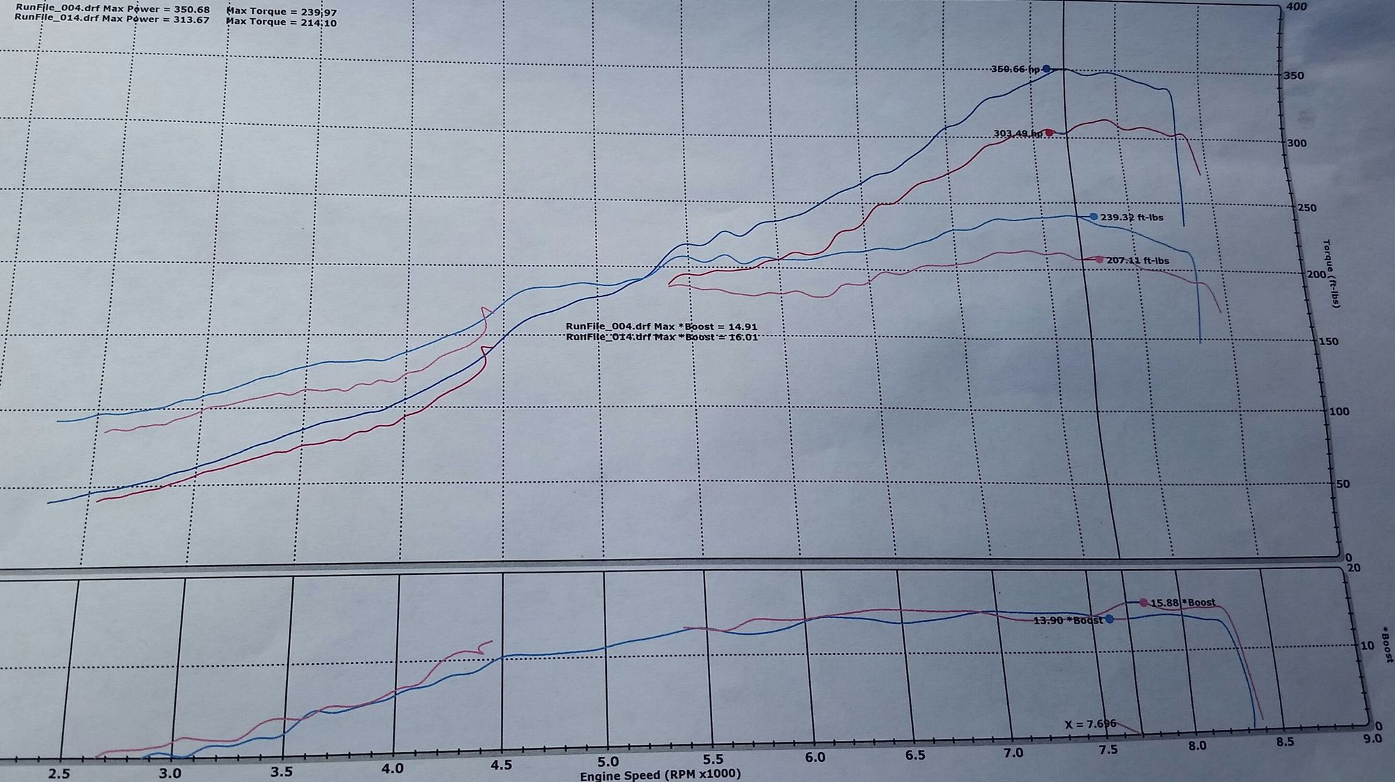

Man they must of been very conservative with your tune. Seems like you should have been able to easily make more power then that on pump gas, but at least it will be nice and safe. 350whp is still a lot of power in a light little civic. Got a pic of the dyno sheet? I don't think you need start upgrading parts yet as you aren't anywhere near the power potential of your current setup. Do you plan on a race gas tune too? Or better yet run e85 or methanol injection.

Thanks man it was just a let down. That does make me feel better though. I was gonna do race gas but thought about only making 400 and to me it wasn't worth it. They mentioned not having anything to read knock and that's why they made it conservative.

First tune is the new tune and the second is the old one. Can anyone point out any changes that were made? I realize pump gas is a limiting factor. Any input would be great.

Wait, English racing did this? That "Tune" looks like someone did it with an etch a sketch. The boost table doesn't even go above 12 lbs so how could they have tuned it to 14? There's like no timing in there AT ALL. Nothing to read knock? That's what reading plugs and having a basic understanding of the engine platform your tuning with are for.
I have a hard time believing that is the finished file. You should be easily over 400 on your setup, safely, all damn day

He just doesn't have "show 3 bar settings" selected in the options on these screen shots.

As for this tune, I understand starting conservative on timing with pump gas, but those timing number are extremely lower. I'm kinda surprised it made even 350whp after looking at those maps. There is a ton of power left on the table.

Yes, this was ENGLISH RACING!!! I paided $100 for a pre-dyno inspection and $250 for a retune. I also had to explain how boost by gear worked to Myles because the first time I got the car back 1st and 2nd hit boost cut. I told him the table was left at zero and he assured me that's not how it worked. When I went to pick it back up he said "you were right about the boost control" (I've obviously never tuned a car in my life and figured that out). So I guess you have to spend $$$$$$ there for there VIP tuning seevices. I definitely won't be going back there. Now I have to go to another tuner and fork out at least another $600 for another dyno tune. Maybe he'll chime in next time he plugs in a product he's trying to sell in the forced induction forum.
