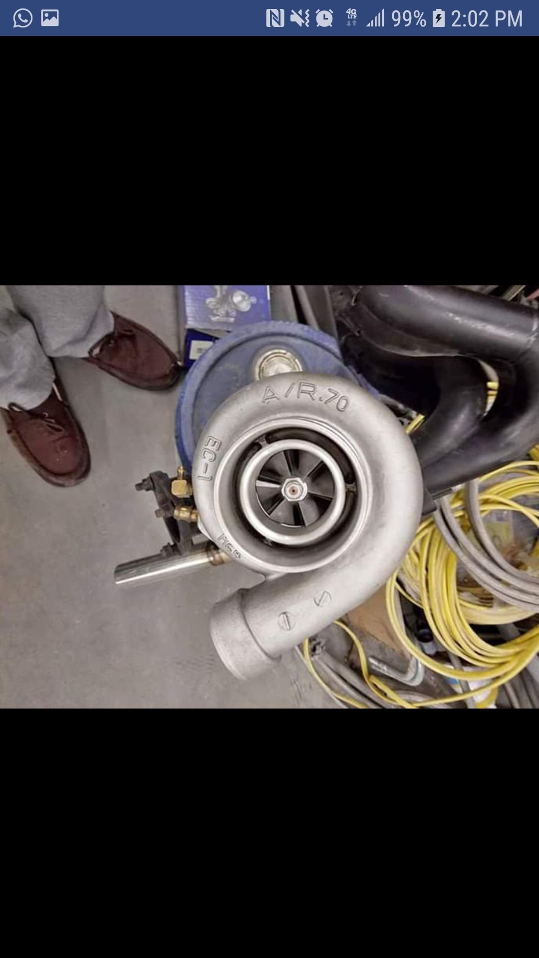

This turbo is brand new and I wanted to see if $1,300 is a good deal? That is the asking price. Also I'm wondering why the compressor cover does not say garret. Any info will help, I just want to make a wise decision. Thank you.
Sorry I dont know why my pictures did not load and I don't see an option for deleting the post/thread.

This doesn't sound right at all, I'd wait and find something legitimate and less questionable.

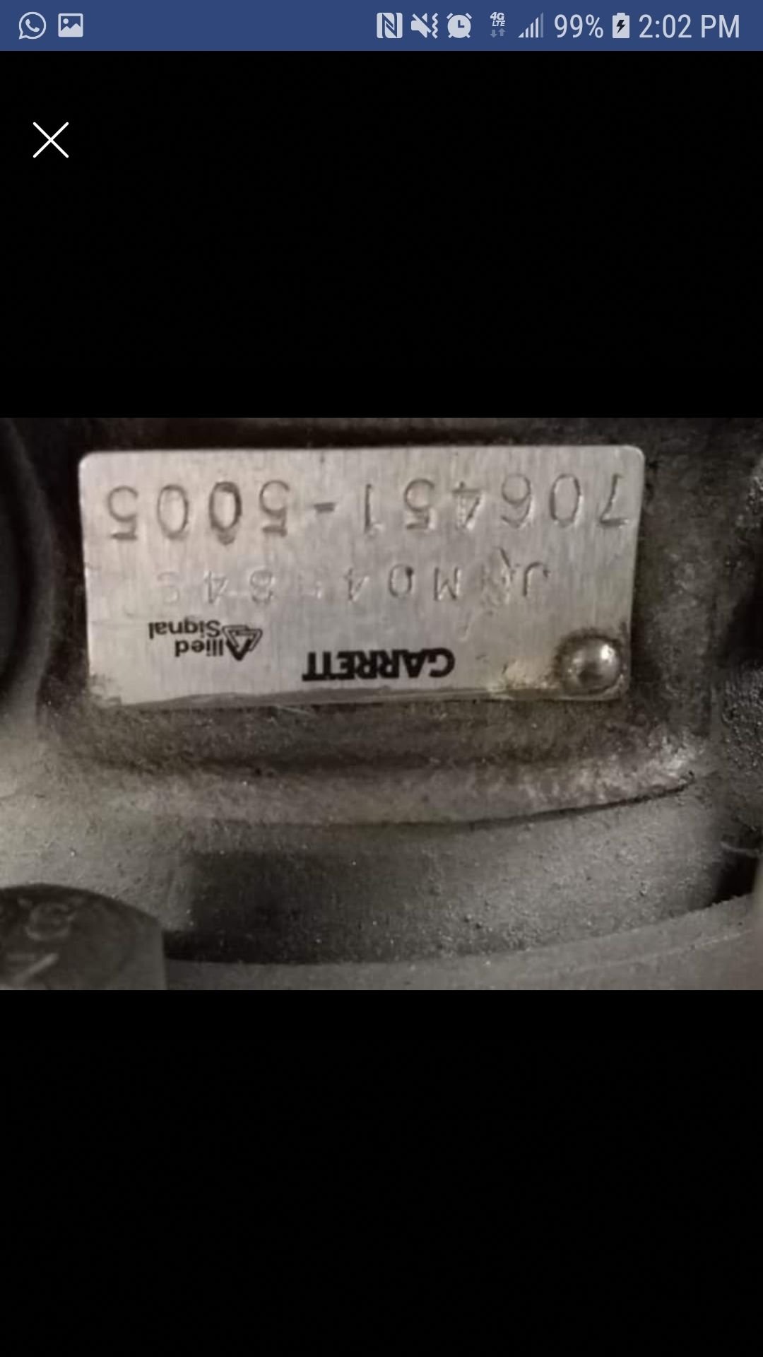

Yes I agree, the only reason I considered it Is because the cartridge in the middle has a garret ball bearing part number.
That sounds normal for a GT35R cast wheel.
Garrett T04S standard covers don't have a Garrett logo on them. Precision was also a former Garrett distributor until 2006. So if it has a Precision stamped Turbine housing, that's also perfectly normal.
Now if it had a Billet wheel from an unknown maker, only then would I be worried.
Try loading those photos again to confirm.

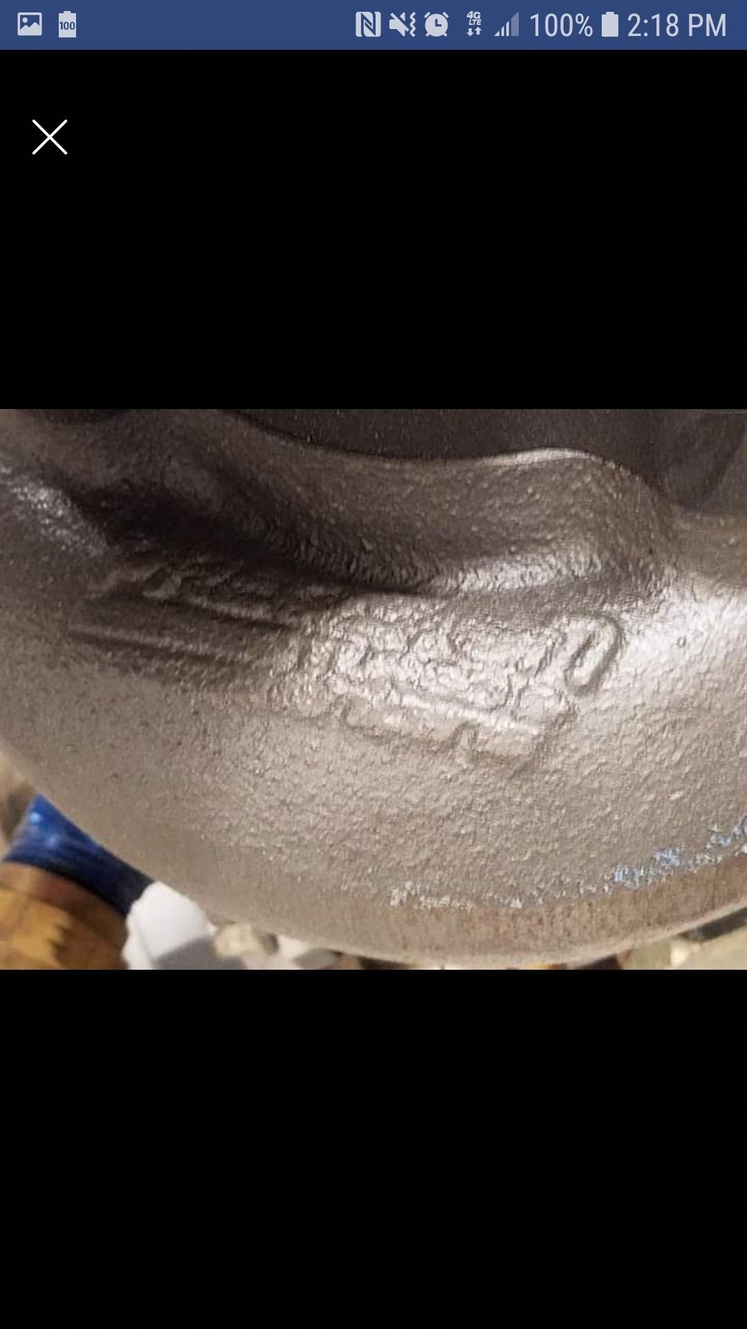

Yes the turbine housing has a precision stamp. I will try to upload images again. Thank you.
If I post only one picture at a time then it does let me.

That looks legitimate to me. Even the compressor cover is a standard Garrett unit. Very few covers actually have the Garrett logo. Been like that for almost 20 years.
Thank you. Now i feel more..comfortable buying this😂
