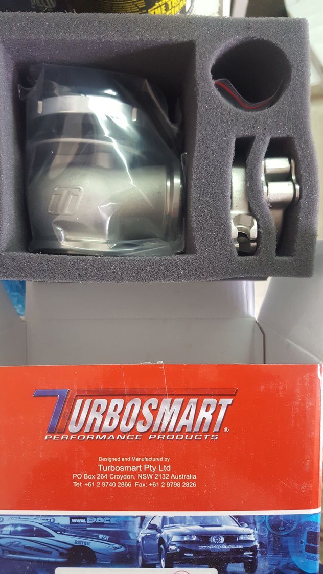

Shot out to Mac @ Speed Trap Consulting
Garrett Ball Bearing "Hunter" turbo
H_A Motorsports on my New S300 v3 installed in one of their P28s
TO BE CONTINUED.................

I was going to wait until i got and installed the turbo but heres my run dow of build
1999 Civic Ex (A/C and power steering)
B18c 97 Spec Type R
Engine: shortblock
polished crank
Manley H beam rods
Wiesco 10:0:1 pistons
Golden Eagle block Guard welded in
OEM head gasket
APR rod,main,and head bolts
OEM Honda bearings
New type r oil and water pump
New timing belt
Head: PR3
Factory mild port and polish
Supertech turbo valve springs and retainers set
Skunk 2 Lost Motion Assembly
ITR cams
stock itr valves
Transmission: S80
Stock Helical Lsd
4.4 Fd
Resurface flywheel
Competition clutch stg 4
Turbo:
Speed Trapp Consulting "Hunter" Garrett ball bearing turbo, Oil and water cooled
Go Autoworks A/C friendy ramhorn, heat coated and lava wrapped
Custom downpipe
Go Autoworks dumptube, heat coated and lava wrapped
Turbosmart 45 wastegate w/7psi spring
Koyo radiator w/mishimoto slim fan
Custom 2.5" Charges Pipes
Tial Q 50mm BOV
Vibrant catch can
Fuel:
AEM 320 Fuel Pump
AEM Fuel Rail
AEM FPR
AEM Inline Fuel Filter
Suspension:
Skunk 2 pro v II coilovers
Skunk 2 front and rear Camber kit
Skunk 2 Rear LCA
Skunk 2 Front Upper Strut Bar
Eibach front and rear sway bars
Hardrace rear trailing arm bushings
Hardrace Front LCA
Exhaust:
2.5" yonaka exhaust (don't blast, I know its cheap and a lot of restriction but man my car is quiet and sound completly stock)
Brakes:
Wilwood 4 piston front calipers
Wilwood slotted and cross drilled rotors
Wilwood brake booster (not installed yet)
Stop tech stainless steel braided brake lines
Rear disc conversion
Electronics:
H/A motorsports P28 with Hondata s300 v3 with boost by gear
Hondata boost solinoid
Hondata 4 bar map sensor (change to 3 bar)
Aem wideband
Wheels:
Stock 1999 Si rims
