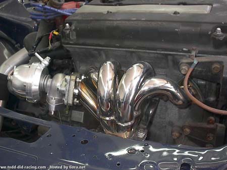

el cheapo wastegate,anyone seen these?

anyone ever tried one,would they be ok for a 8 psi set up?

damn, look just like Tial..

im just looking for a low 8-10 psi,im using a small saab t3 with internal wastegate right now.looking to make a step up.

sorry for the stupid question...but where do the two hoses off of the wastegate go to?

<TABLE WIDTH="90%" CELLSPACING=0 CELLPADDING=0 ALIGN=CENTER><TR><TD>Quote, originally posted by civictypenos &raquo;</TD></TR><TR><TD CLASS="quote">tial = bad? </TD></TR></TABLE>
no, it's just that I am not sure of the quaility of the WG. Tial has excellent quality, my suggestion is spend th elittle extra cash and have an extra peace of mind
stan

Aaron,
Top port goes to your Boost controller solenoid inlet.
Side port goes to any vaccum source (intake manifold)
stan

so if i'm using a turbo xs manual boost controller, it hooks up to the top of the wg? and then where does the boost controller outlet connect to? a vac source?

if you're using Turbo XS, just tap it off the side port, leave the top port open.

nah, boost controller solenoids are only found on electronic boost controllers. a turboxs mbc will go inline with the vac line.

the wg looks nice and decent...probably teh same people who cast and CNC the tial version too....
but I give ssautochrome an "F" for cusomer service and support.

i think im going to give it a try and see how it works,worst that can happen i just resale it right?

Yea, either that or you just have boost spike/creep and blow an engine Spend the extra and just get a Tial

Tial's run about 220 brand new. If you are that concerned with saving money, i would just go ahead and brose the for sale forum and find a used tial wastegate opposed to buying a knock off.

a wastegate isnt something you want to bargin shop for..spend the extra money and get something proven
