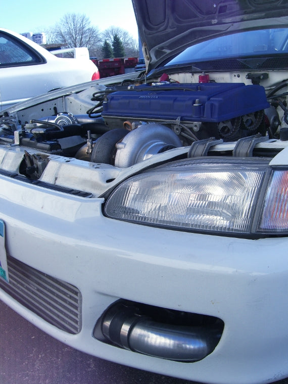

Current Modifications
  • Full Race Top Mount Manifold/ 3" Downpipe
  • PTE 6262 Journal Bearing
  • Victor X Intake Manifold
  • Stock port p72 head
  • Stock Cams
  • "1000cc" Fuel Injector Clinic Saturated Injectors
  • Walbro 255 Fuel Pump
  • E85 (70% blend)
  • Hondata S300
  • Jordan @ MAPerformance Tuned

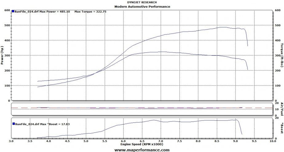

17psi
23psi
Unfortunately, anything over the 17-18psi mark she was running out of fuel past 7700rpm. Next thing to be upgraded is the fuel system! Stay Tuned!

correction factor?

1.01 CF

looks good... if youre using the hondata for boost control you could have ramped the boost up to 23+psi till 7k and tappered it down to 17-18... would have made 500+ and still been safe on the fuel side
