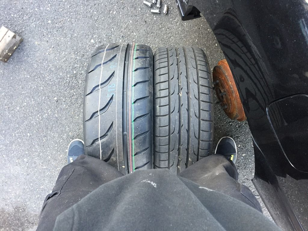

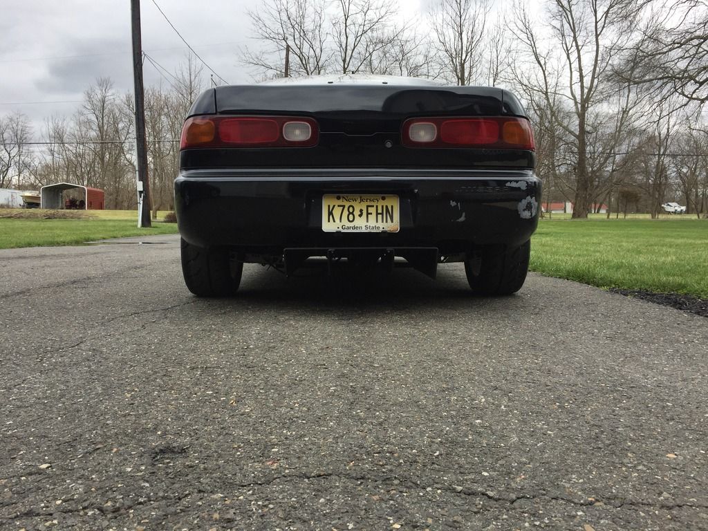

Changed over to 16x7.5 Kosei K1s and 225/45r16 R888R Tires, Top1 motors half diffuser

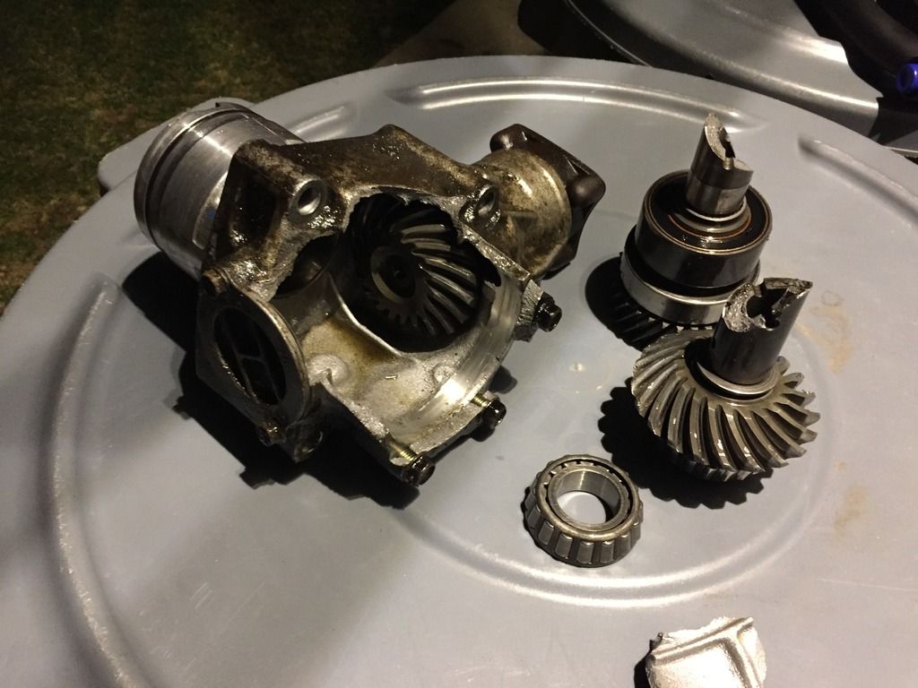

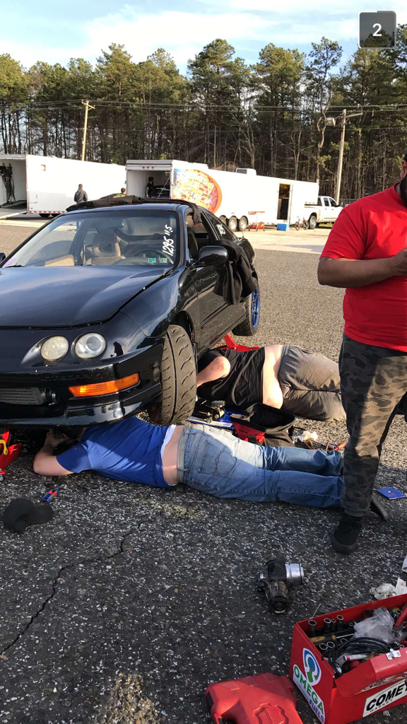

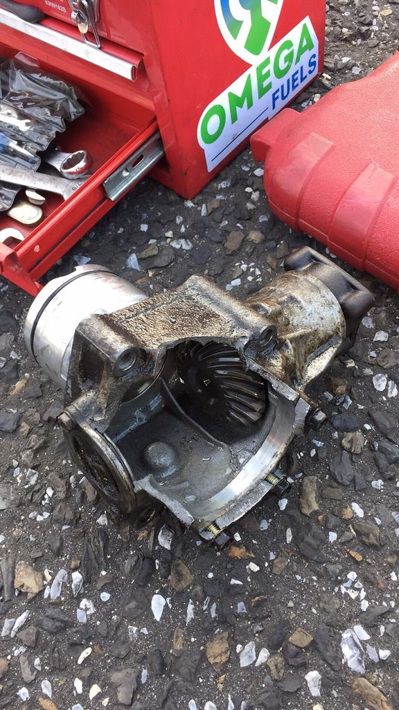

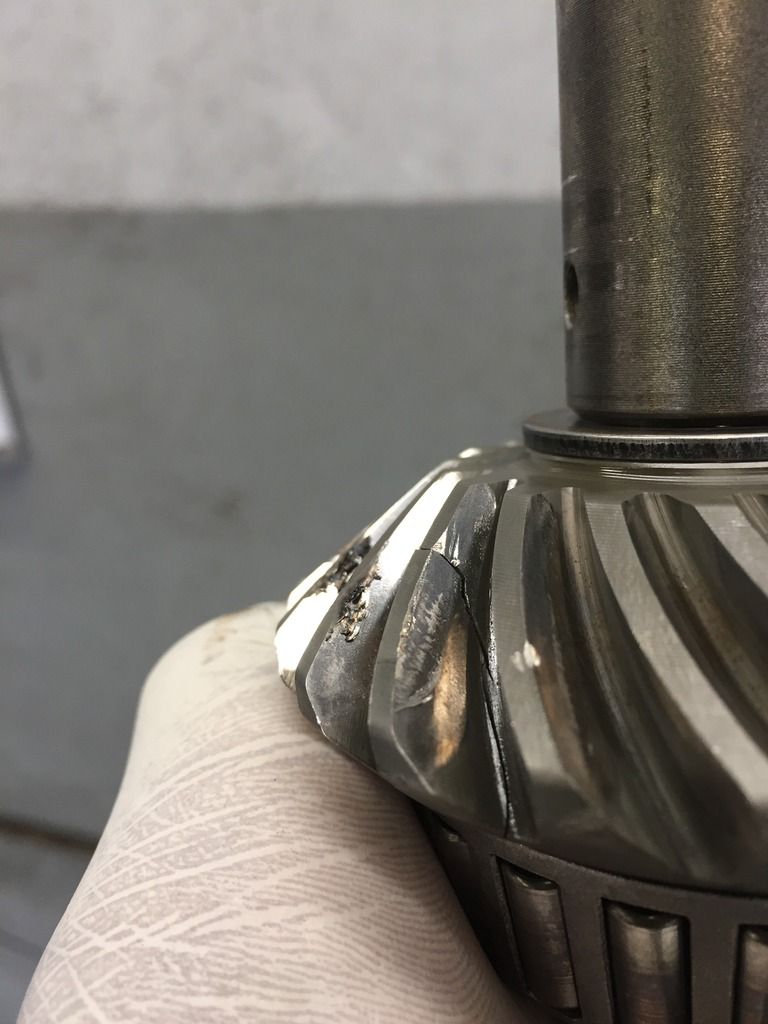

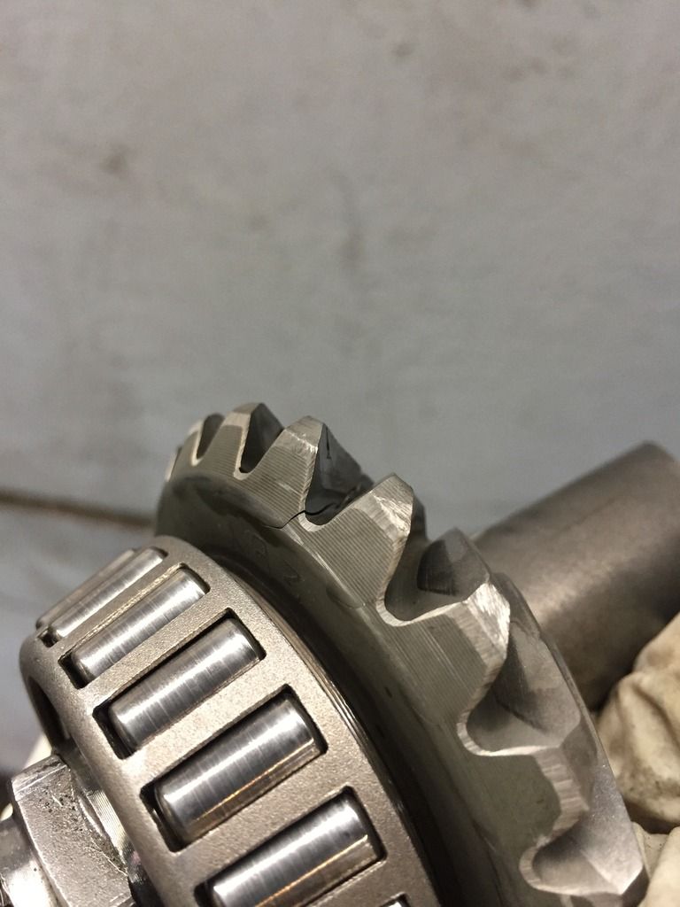

Then ran Import Faceoff and Destroyed a t-case Lmao
pretty sure the tcase was assembled incorrectly the nut that holds the transfer gear to the shaft was loose on the shaft ( it should be tightened to 85ft lbs) which caused crazy shock loading to the case until it failed . on top of that i did not have the transfer case brace installed like i should have. Dont think im at the limit of the parts yet just have to use the right stuff lol.

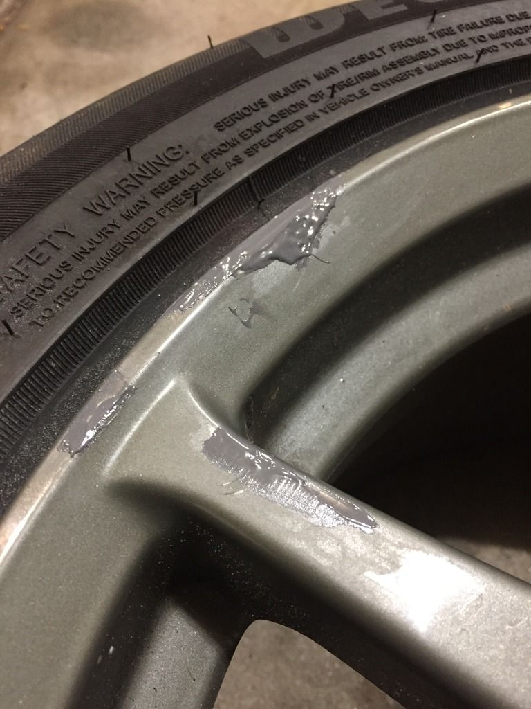

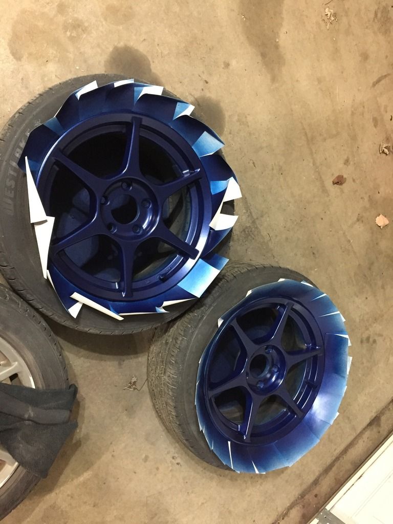

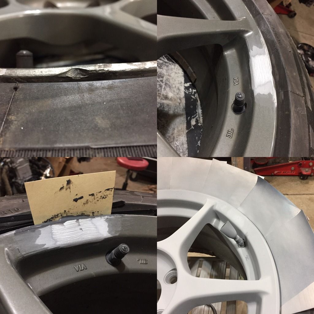

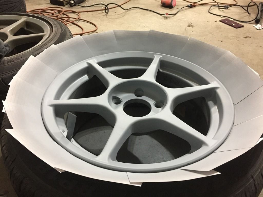

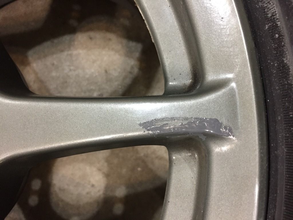

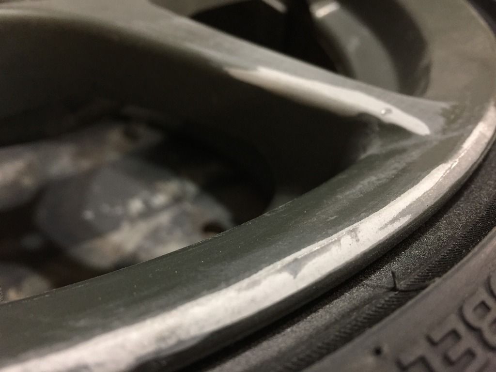

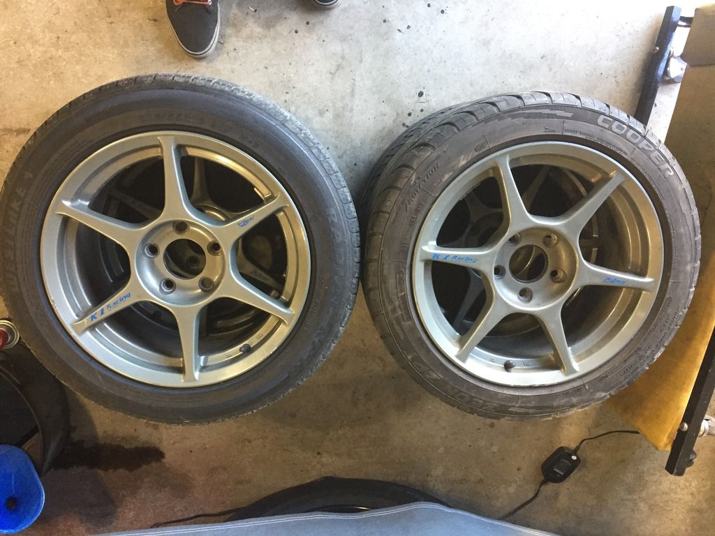

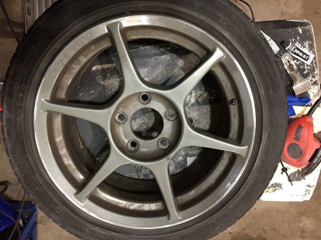

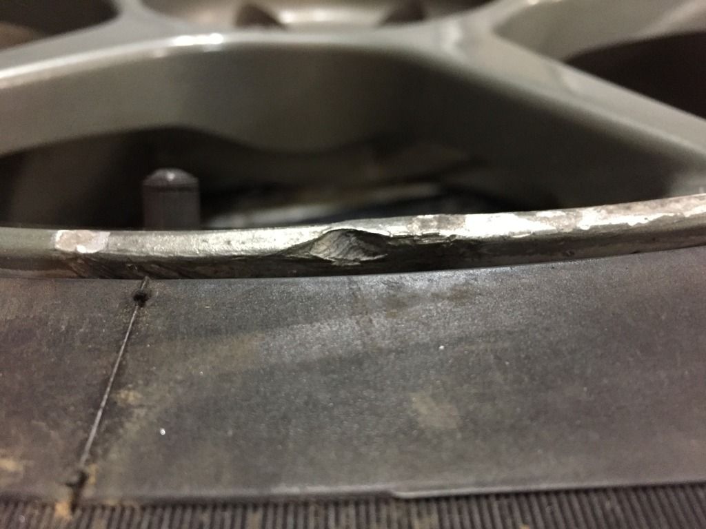

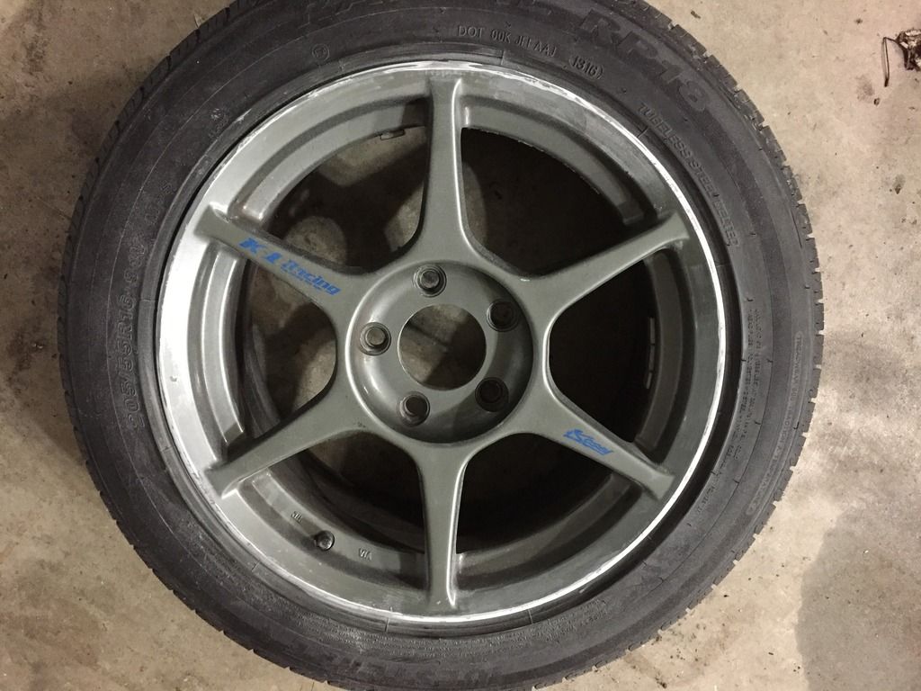

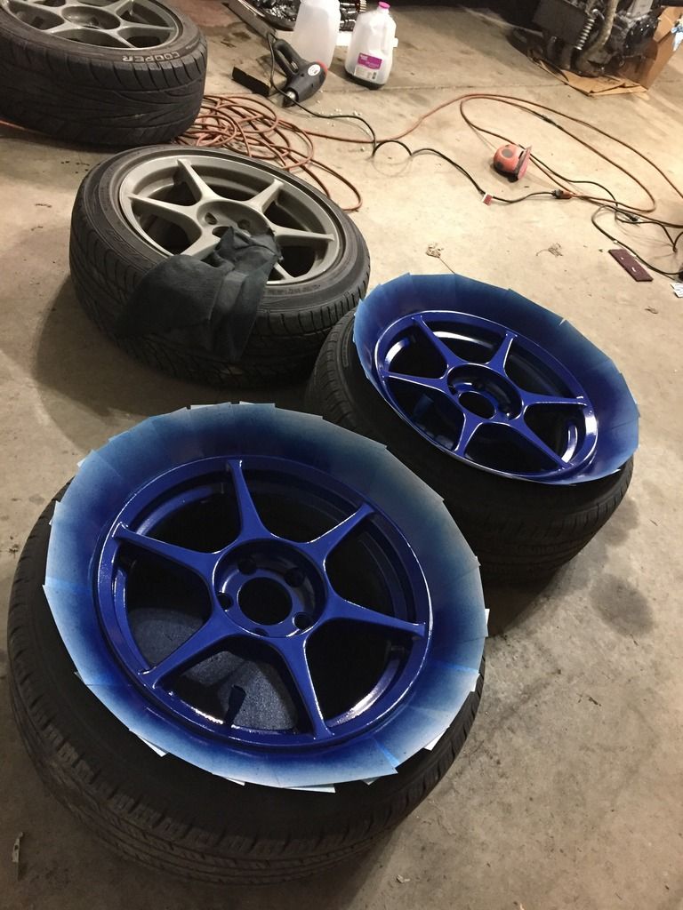

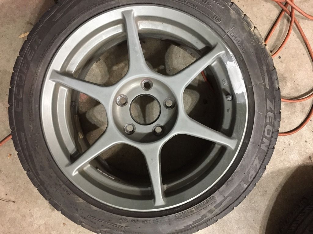

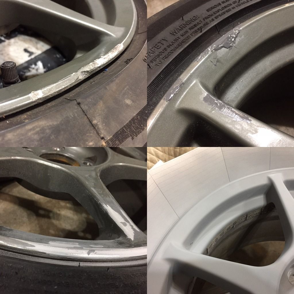

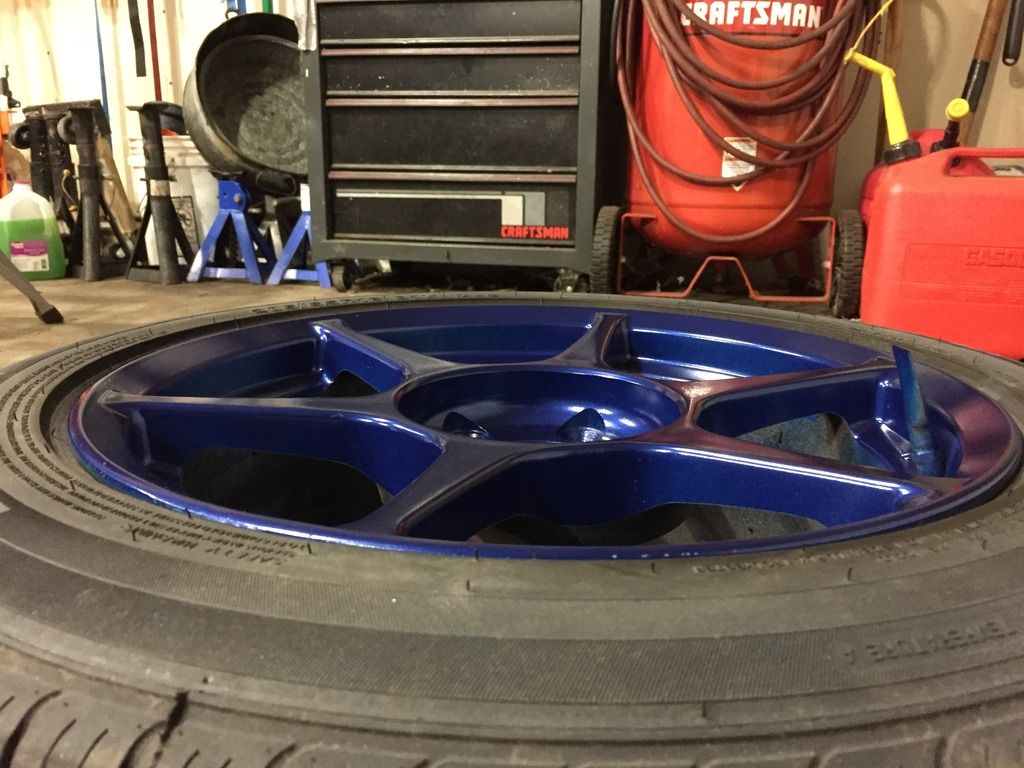

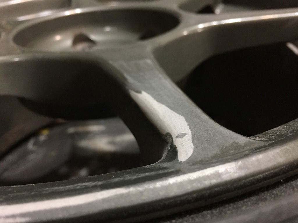

The k1s I got used were in really bad shape, kind of used them as a test of my refinishing skills, paint needs to be re sprayed but the chip corrections and cleanup came out really good. All the repairs were done with (dont laugh) jb weld and an electric sander, color is Ford Medium Royal Blue.
start
Filling
Starting to sand
This was the worst wheel, had a bend in the outer face took a lot of time to get it concentric and build the lip back up
In primer
First layer of color
DA-NINE is offline

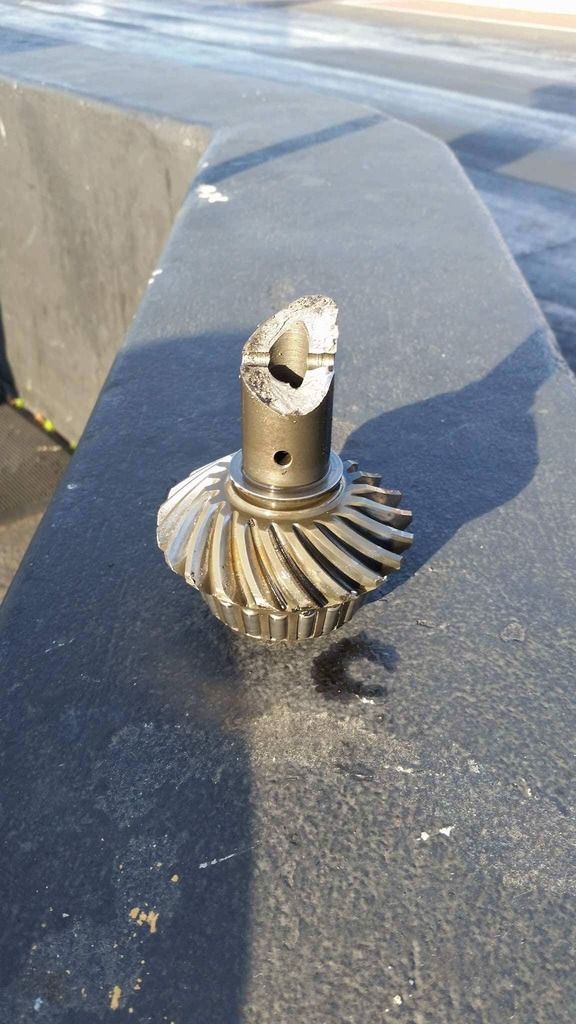

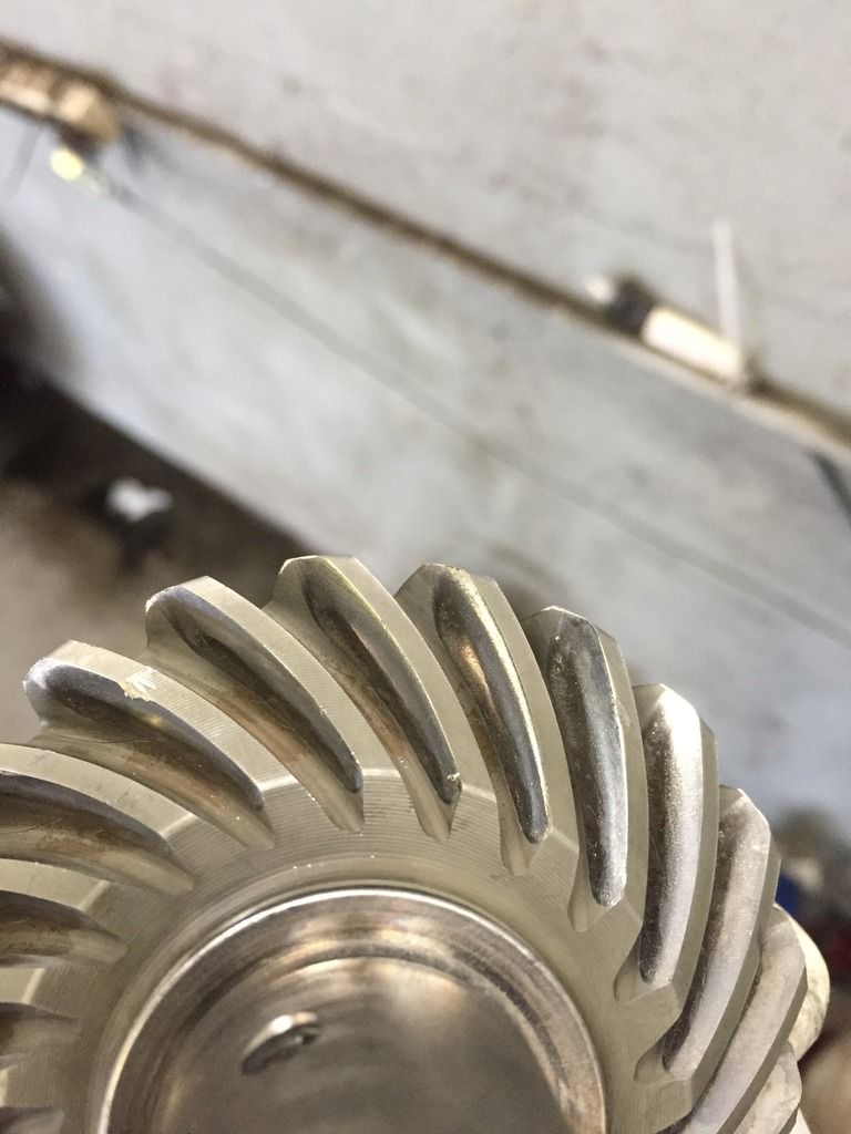

More close ups of the T-case failure. The Nut that holds the transfer gear to the shaft was NOT ran down and torqued the gear had .125" of free movement on the shaft it was supposed to be torqued to. Guessing every time the gear was loaded by the engine it was slaming the tapered roller bearing into the seat stressing the case until the case eventually let go. then broke the shaft on the way out. By the wear pattern on the teeth of the tcase it seems like the gear has been in motion for a long time, polished contact area all the way up the tooth face.
What sucks is it happened in the semi finals of 11.50 index, I won but broke the car and could not compete in the finals....
Was running the car on wastegate pressure all day to run the index and ran a perfect pass too.

nice work on the wheel repair, i was planning to try filling some curb rash using jb weld but decided not to bother - you've just changed my mind
