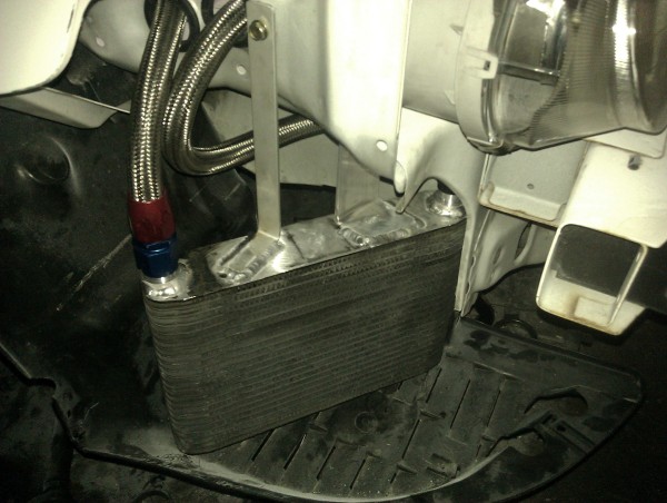

Few questions about placement for putting ventilation lines on the valve cover.
During my last track event my Moroso can overflowed. I currently have two -12 lines from the backside of the block to the can with also a -6 line returning to the pan. The valve cover nipple went into a check valve on the intake. So the valve cover would not get any ventilation under boost. The overflow happened at an uphill turn, so I believe oil was on the backside of the block and just got pushed out. During the event, I tapped the moroso can with a 1/8npt nipple, and ran the stock valve cover nipple to the can. The problem seemed to go away for the most part.
I'm building a bigger can and adding some bigger lines to the vc just for a little peace of mind/security.
So my question, should lines go to the front or back. The backside of the vc is higher, so to me it would make sense to put them there. But under acceleration the oil gets thrown to back; vice versa with braking. I've seen setups with them in the front and/or in the back. Just wondering what works the best and why.
Heres a pic of the current setup:
This was before I tapped the can with the 1/8 nipple

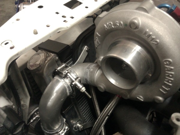

Here is a closeup of the valve
But like I said, the hose from the vc is now just plumped into the can. With the charge pipe capped.

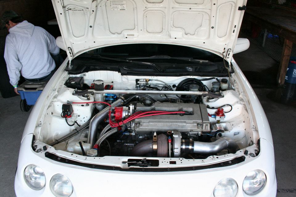

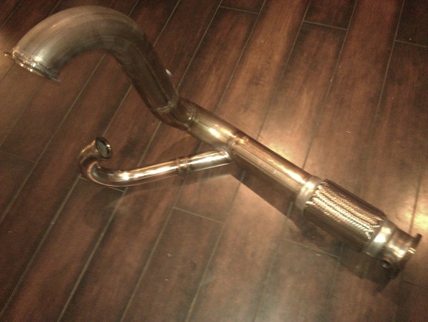

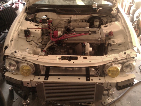

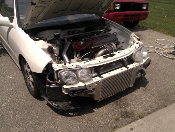

Just for fun, here are some pics of the build. All the turbo stuff was done last winter.
