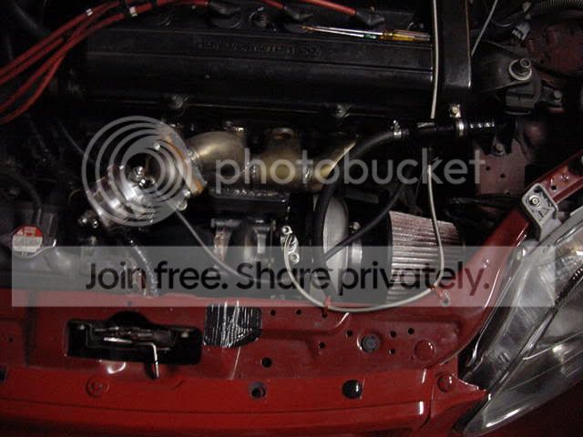

Here are some pics since you guys like to look at pics, and maybe we will get more help this way
THe car has a stock dizzy with stock coil, msd rotor, and msd cap, bkr7 plugs gapped to like 26.
WTF
The Wip
THe install, sorry about the pics but it was dark
The turbo
