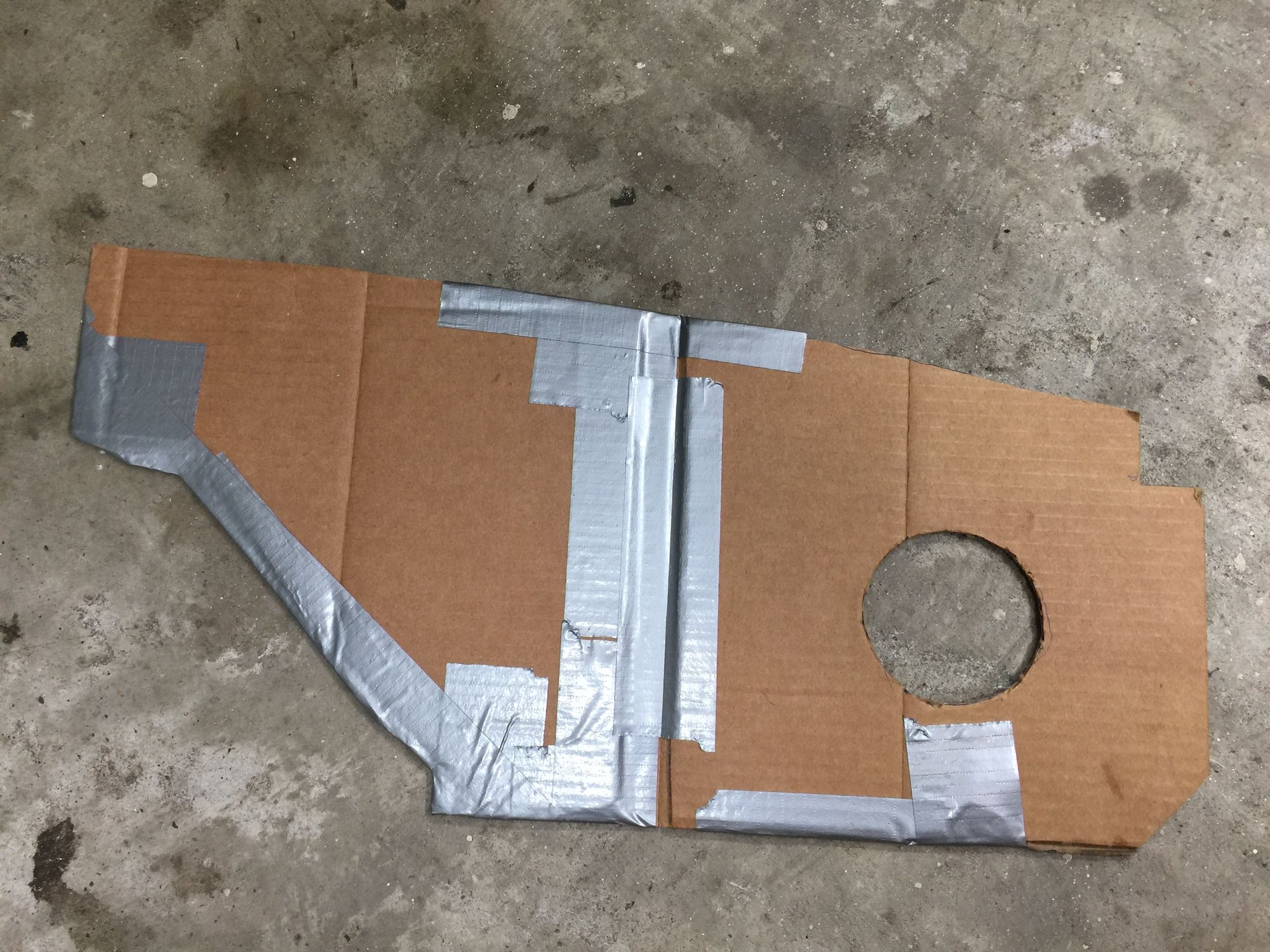

So been working on a nice place for the air filter. Got the beginnings of a airbox on the making.
Just in time too. It was about 97' today and humid as hell. Thank goodness I don't have a big tubular manifold radiating heat, or a half-radiator setup. Having either of those would not have worked today, and both together would have been bad. Sitting in traffic coolant temps would hit 201-202 and just sit there with fans on. With AC on it got to 205 once. After moving temps would come down to 192-196ish. Thankfully it didn't get any hotter but I still didn't like it. Rad upgrade would be needed if weather got any hotter around here

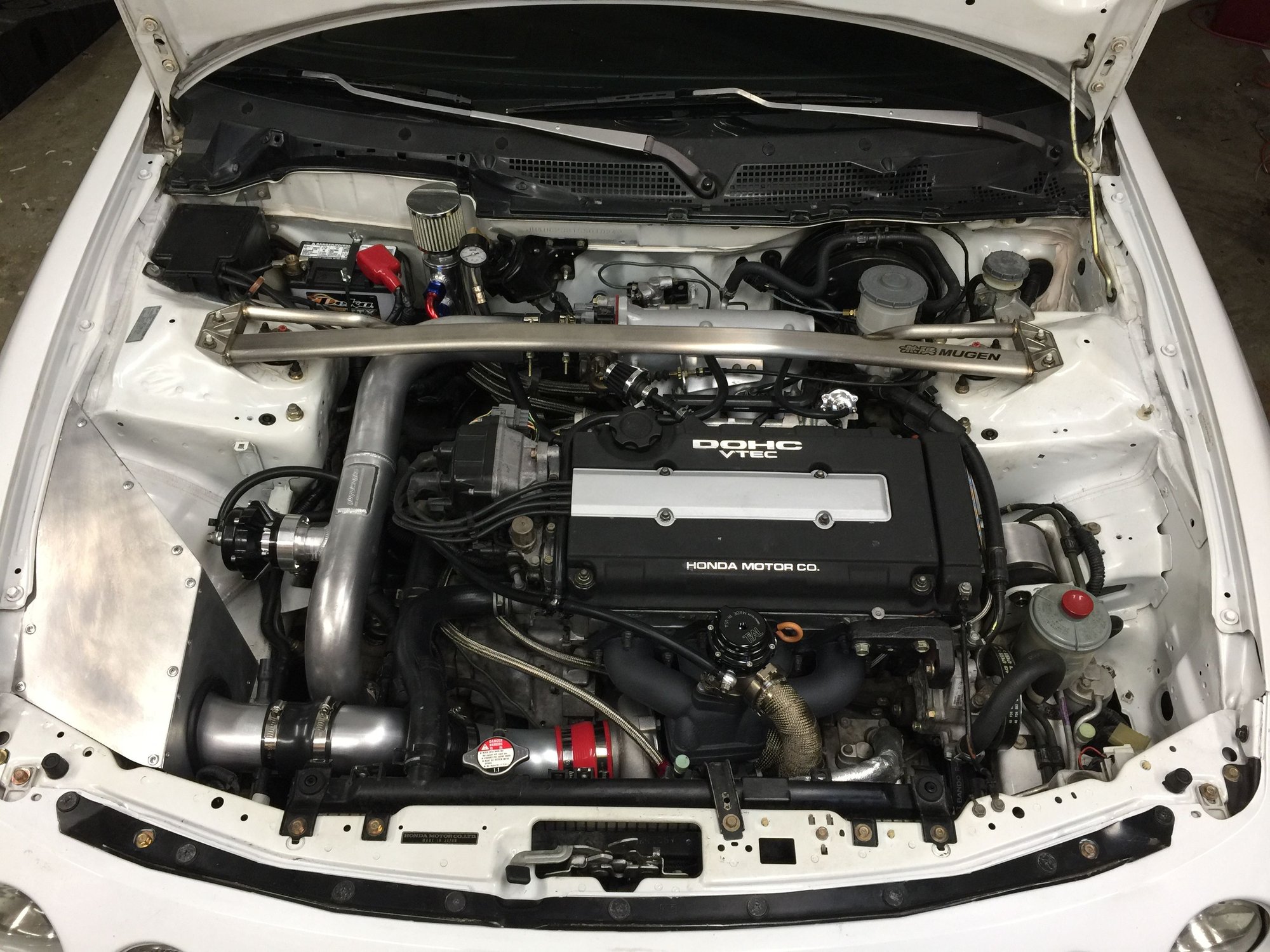

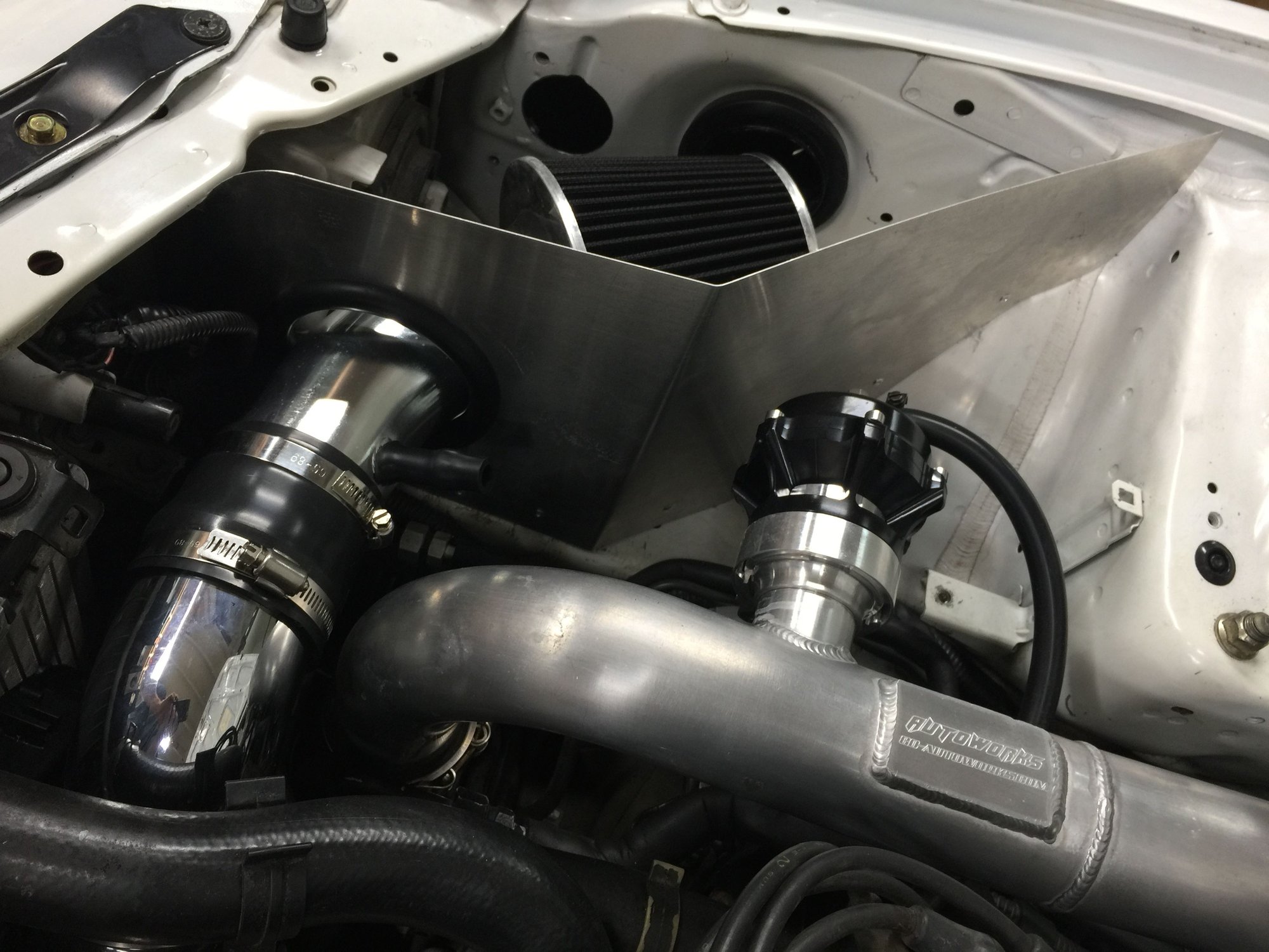

Finished the Cold Air Box
I'm digg'n it; gonna be very functional plus it gives a nice finished look to the rest of the kit.

im happy to report that airbox is giving me 10-15 degree cooler intake air temps. The temp being read from the intake manifold, after the intercooler so that's the end-result of the fresher air. I'll take it!
