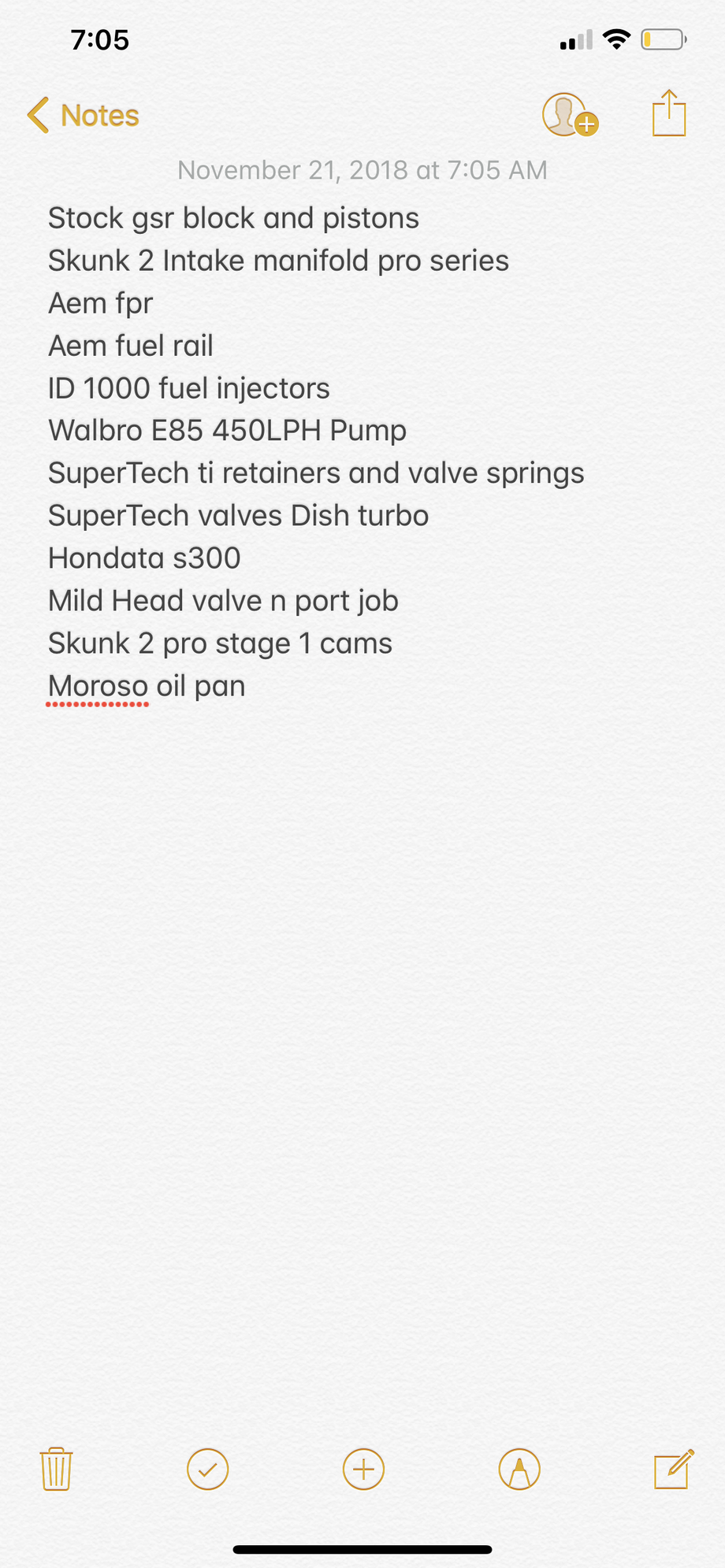

Need some advice on turboing this car. got b18c1 in a eg hatch. Want to go full e85. would like to reach 400hp at least 350 on stock block and internals. Don't know what size turbo I should run. Let me know what think of my current parts brainstorm and if reaching 400hp on e85 is doable. thanks

Save yourself the troubles and at least upgrade the rods, pistons, bearings and headgasket...along with an upgraded clutch. You don't need a Moroso oil pan.
and a GOOD TUNER who knows what he's doing.

OK, we know your goals, what is your budget like? If this were mine, I would add to your list: Pistons (at least some Nippon or YCP cast, if not forged), rods, bearings, replace all engine gaskets, new head gasket, new bearings, ARP head studs, timing belt. Don't forget to add in the cost of machine work - bore/hone/deck block, deck head, oil return bung for oil pan, bungs for catch can (if you go that route). You should get your ECU recapped, but you don't have to. If my budget was $7,500 or less, I would wait to buy the following until you know you can afford it all. Or, I wouldn't buy these at all - I would consider these 'nice to have' but not necessary: AEM fuel rail, valves/springs/retainers, port/polish head, cams, oil pan.
I'm not 100% sure about E85, but I think your stock fuel lines and rail would be able to handle your goals...someone correct me if I'm wrong, though.

one thing to add...will you be doing most of the work yourself and are you capable of doing it? See too many "projects" for sale and people assume building a turbocharged Honda is easy.

get rid of aem fpr, fuel rail, supertech valves, port job, oil pan, and dont mill the head unless you have too.
Made 440 on like 15-16 psi 10 years ago on e85, stock cams, stock head, stock fuel rail/fpr, stock intake manifold and full race gt30r kit on a gsr.. only thing i had was arp suds

I already have the head work done so thats what I'm working with.just a mild valve port n polish.running similar specs to type r head.440 on a stock head.ill be more than happy to touch that.Also what about the bottom block...was everything stock as well. I'm not trying to overbore for bigger pistons, ill upgrade the rods and bearings if I'm going to switch out the pistons for some of the stock bore size(if that matters any`as my current p72 look fine)also want to leave the bottom block in the car.

honestly, moneys not a issue at all. but not really trying to build a race car. this is just gonna be a street car to mess around with on the weekends. just want a little more firepower.nothing too serious. With that being said. I don't really want to run any over size pistons.shouldve put that in the description. But what do you think, running oversized pistons is a must or just a better idea?

Stock is perfectly fine. Just donít have high expectations and a good tuner
stock head or whatever you already have for head
stock block
good tune
1000cc injectors for e85
wqlbro 255
hondata sf rcautoworks 4bar map sensor
arp hesd suds
oem hg
oem new oil pump comes with oem rear main seal too
oem front main seal
quality turbo
quality bov
quality wg
install
tune s300 prefered but u can go chrome/Neptune
edit: should do a leakdown rest to see if piston rings are solid still
if not
keep it cheap re ring hone
or ball out forged rods pistons extra 700-950. New prices
switching to some other cast pistons doesnít make sense

thanks, exactly what I was looking for.but one more thing, what turbo or how big of a turbo. exact ones would be nice. and of corse I am going to run a good turbo don't want any ebay or off brand ones when I got the funds to run good quality things.

Augustine, in all honesty and with respect, what builds have you seen on this forum that are similar to your goals? There are several on here just from the last year. We don't need to spell out every part for you. The builds are crafted as guides for others to follow. Just check.

To quickly address your question, the short answer is yes, for a stock black, that turbocharger is much too large to utilize effectively. Keep it simple with something 41lbs-50lbs per minute airflow for the stock block.
