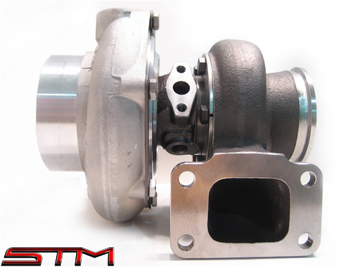

Actually, going from a 2.5" transition to 3" is a very good thing, as it causes a slight vortex effect to the turbine exhaust gasses. That's why you see a lot of conical-shaped GT and TiAL turbine housings that are 3" v-band, because they started off with the exhaust exit of the volute at something slightly smaller. This is very commonly used in Formula 1, Indy and Formula Ford applications that utilize turbocharging.
So, it fits on the turbo (GT and GT{X}) like so:
You'll note that even though most of the other turbocharger that are used whether or not they are journal bearing or ball-bearing CHRA, will have a typical T31 2.5" outlet, (even some of the custom-configured v-bands have this) because they expect the fabricator to make it into a 3" exhaust from a transition.
Only the GT 3" 4 bolt with it's special sized outlet, came from Garrett directly with a 3" to start with. Even then, that only works on GT & GTX CHRAs because of the fitment / profile of the exhaust wheel. But even then, as you can see, there is a nice conical transition.

The GTX2860 is probably the fastest spooling turbo option you have. (Saying this very loosely as I'm sure there are exceptions to this, but generally speaking...)
This especially applies if you get one of the new Gen 2's or a Super Core.

Originally Posted by B and B
How durable are the ceramic bearings?
Those use a silicon-hybrid bearing that is slowly replacing the steel ball-bearing ones over the last two years. It's not a ceramic bearing in the traditional sense at all. No disintegration or cracking.
You won't know by any part of the part number which is still steel and which one is not.
They rang are nice on the allocations I've used so far. Not like the older Turbonetics or Precision ones
