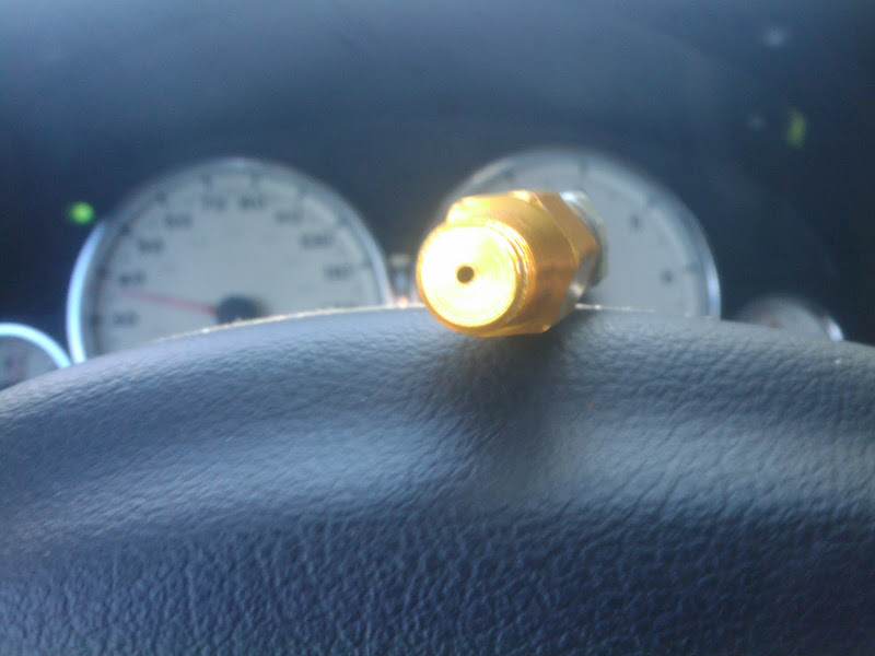

i was getting the similar issues. i would get excessive smoke (running open DP) when idling. pretty bad after the car sits for about 2 mins or so. i dont get any smoke during driving, or underboost that i can tell. there was oil all inside my compressor housing which led me to believe it was a turbo seal problem. i put a restrictor on it still smokes after a minute of sitting still. not sure what the problem is.
this was before the restrictor:
heres the restrictor im running now, and still getting light smoke at idle:

There currently is no restrictor on it so I would say that falls in the too large category. Was thinking of putting a sintered filter or .065 restrictor on it as well.
