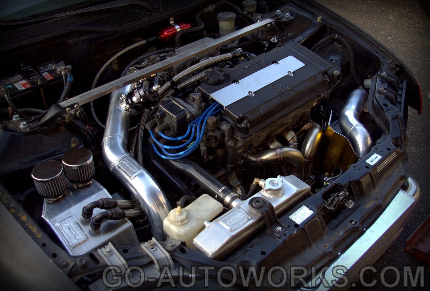

Hello H-T. Forgive me in advance, it's been a while since I've attempted to do one of these.
The Car: 92-95 Civic Coupe
The Motor: Currently a 100% internally stock B16 w/ unknown mileage
The purpose: Fun street car, roll race car, "street class" drag car.
Original Goal lists:...be competetive, and go 11s on the stock motor (at this point that has been achieved)...on to Goal #2 (to be addressed later in the thread)
A big "kicker" here (which will make sense later) is this car has NEVER been on a trailer. It's driven to and from where ever it goes.
The car belongs to a good customer of ours, Scott. This build has actually been going on for maybe a year and a half now. I thought I'd do a thread on it as it's something a little different, and may answer a lot of basic inquires that pop up in the forums. Scott brought the car in, sat down, and we went over the goals; both immediate and long term. The car was to be and has been handled in phases more or less. He does his research, homework, asks questions, listens and gets good results...what more can you ask for there. The forced induction/fabrication/fueling/parrts delivery was to be handled here. The suspension and whatever else that can be bolted on, or walked through was to be done by him.
So here we go: When he picked the car up, the swap was already done. It as most had it's "short comings " and short cuts taken, but nothing that couldn't be easily fixed/addressed.
(a few parts were picked up while it was NA that would work throughout the build process...excluding the air intake)
(I just realized how long this build has been going on while looking for photos, the Na pic is early 2015). Sept 2015 the tear down began.
Fueling: The car was going to be run on E85 so we went with:
-Grams 1000cc injectors +320lph in tank pump
-6AN fuel feed kit from tank to rail w/ inline Aeromotice filter
-Aeromotive regulator w/ Skunk2 composite rail
-tuned on Hondata S300 V3
This would easily handle what would be thrown at it.
The kit/bay layout was designed specifically for the build as well. We went with (what was at the time) the new T4 internal gate Turbonetics turbine housing which had been something we had been testing. The turbo is our BB T-GA 6157 turbo option. This is a unit that I knew would deliver the needed power & curve while still being able to make the future goal further down the road. A mini ram was built to accomodate it, along w/ the rest of the turbo kit.

A quick shot of the fuel side

What catchcan is that?
I made the can specifically for him/this setup.
