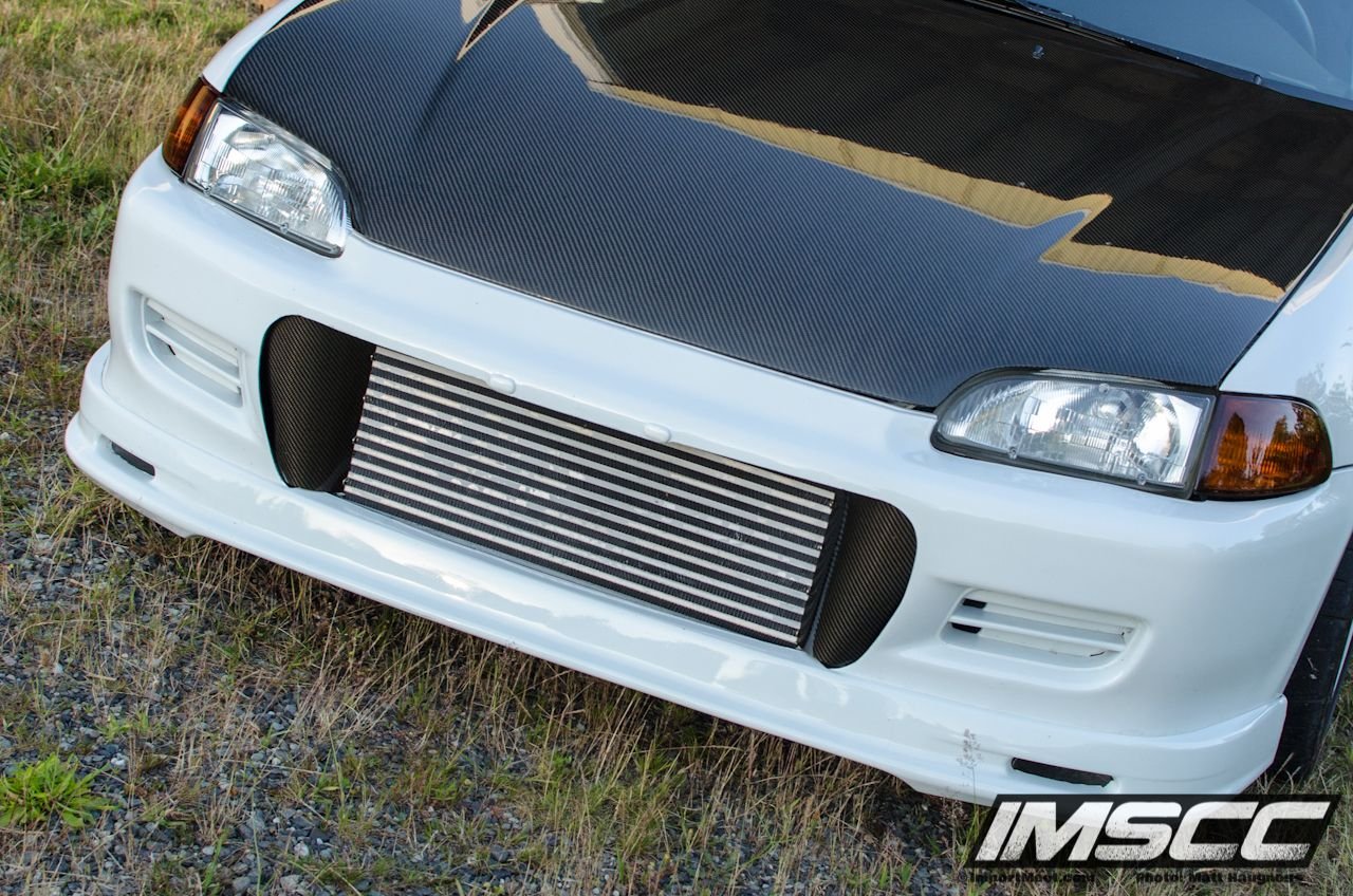

Any air that's going to enter into that system from your highway driving is going to be much faster than what any fan can provide.
I recommend venting the front bumper itself more (damn EG bumpers cover everything as the hood riser method only "draws out" ambient engine air temp, which has little effect on what's happening for the radiator to receive fresh outside air.
Something like below if you want it to look "clean"

I’ve been dealing with similar issues in my B series ef. Try driving without the front bumper cover and behold the world of difference it makes!
After trying every other trick in the book, venting the front bumper ended up making the only noticeable difference. I just cut the front grille opening all the way up to the black trim piece (used to be about half this size). Not sure how to make it look decent on an eg bumper.
Since it is only a half rad, build a block off plate for the rest of the space on the other half of the front end, behind the intercooler. So once it flows thru, it is forced to the radiator.
Other methods to reduce underhood temps do help a little. Heat wrap, turbo blanket, etc.

This is how I cut my eg bumper. Not the cleanest, but it’s built to race not to be pretty lol. I seriously love my scirocco tucked radiator with spal fan, my ect never goes above 192* driving in traffic on a 90* day. I think the highest I’ve ever seen it was 195*, but I was seriously beating the living crap out of it lol. Typically if I’m rolling at 50mph or faster it just sits at 186-188*.
