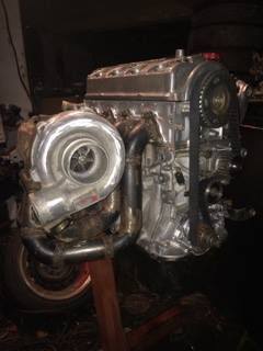

So i made progress today with my car, got the new manifold in the mail and tested fitment, will need some exhaust reworking lol but i dont mind because it looks sick! its a blue ridge motorsport 'tornado style' t3 manifold, I got it used from another honda-tech member
Also I have my RC injectors in
And getting my Turbonectics manual boost controller setup so i can turn up the boost An Omni power 2.5 bar MAP sensor to go in as well
For the next tune my goal is 290whp

Looks to be headed in the right direction now. I like that manifold, a little over kill for your goals, but I think it looks cool. Good luck with the new tune!

Much better start to what you're doing. Yes. slightly overkill, but a good deal is a good deal.

You'd be surprised how far a good tubular log exhaust manifold will go efficiently. So, far about 530whp on Californiadad's GS-R no backpressure issues.

Alright i got the car running again today with all the new parts besides MAP sensor, and it drives ok, partial throttle and idle is crappy but it definitely needs a retune for the changes. It pulls good but just cant really cruise
Almost cant stop looking at the new manifold I love it. Still need to finish up the downpipe and dumptube but its looking good for now, and i had to get a spectre air filter, only thing the part store had that would fit lol.
And this is just a picture i took bfor i thru it in there
