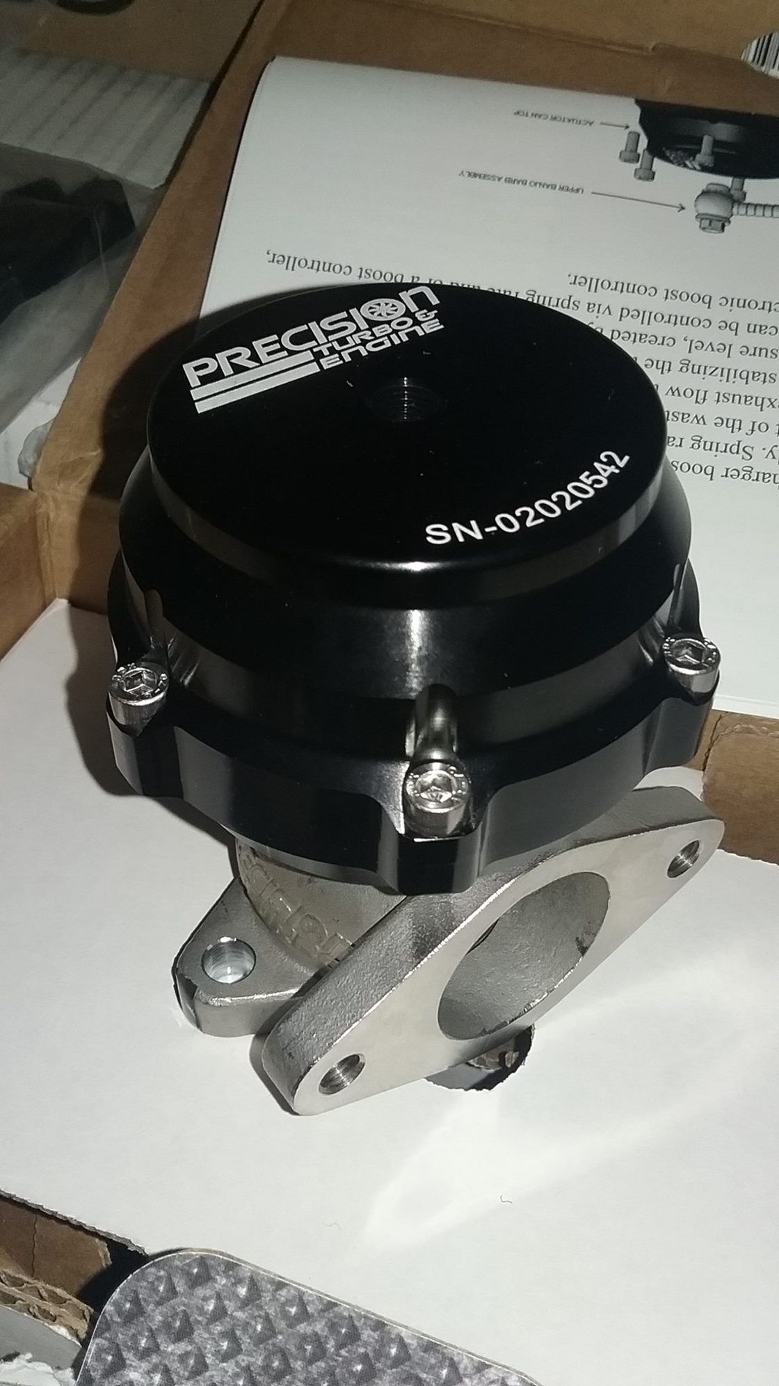

Welp, I have a sweet lookin Precision wastegate ordered, Along with all the other small stuff i need for my turbo kit.. Going to boost the car on the budget kit upto 10psi max for now and see what it makes, Cant wait

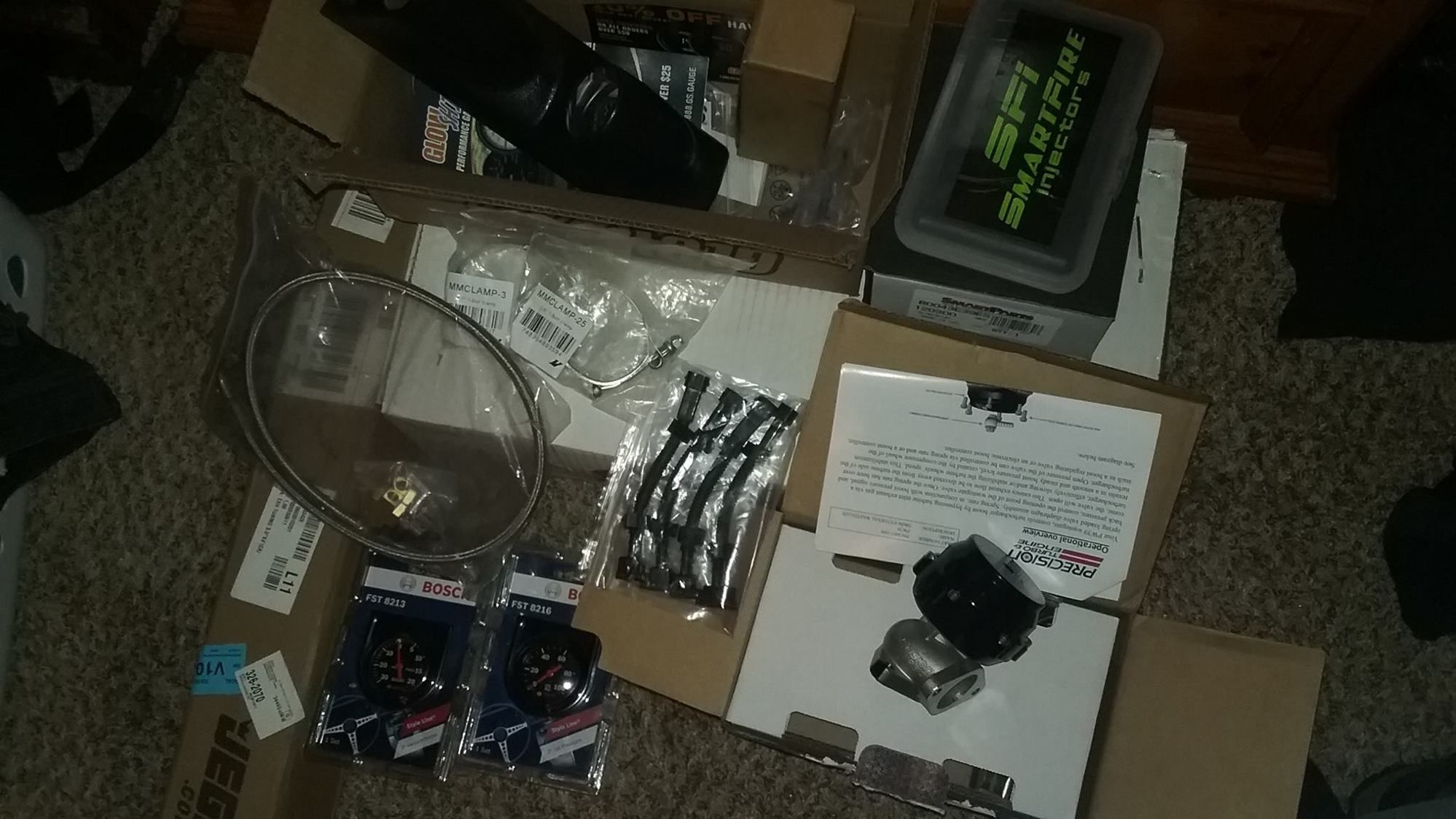

I have all my parts

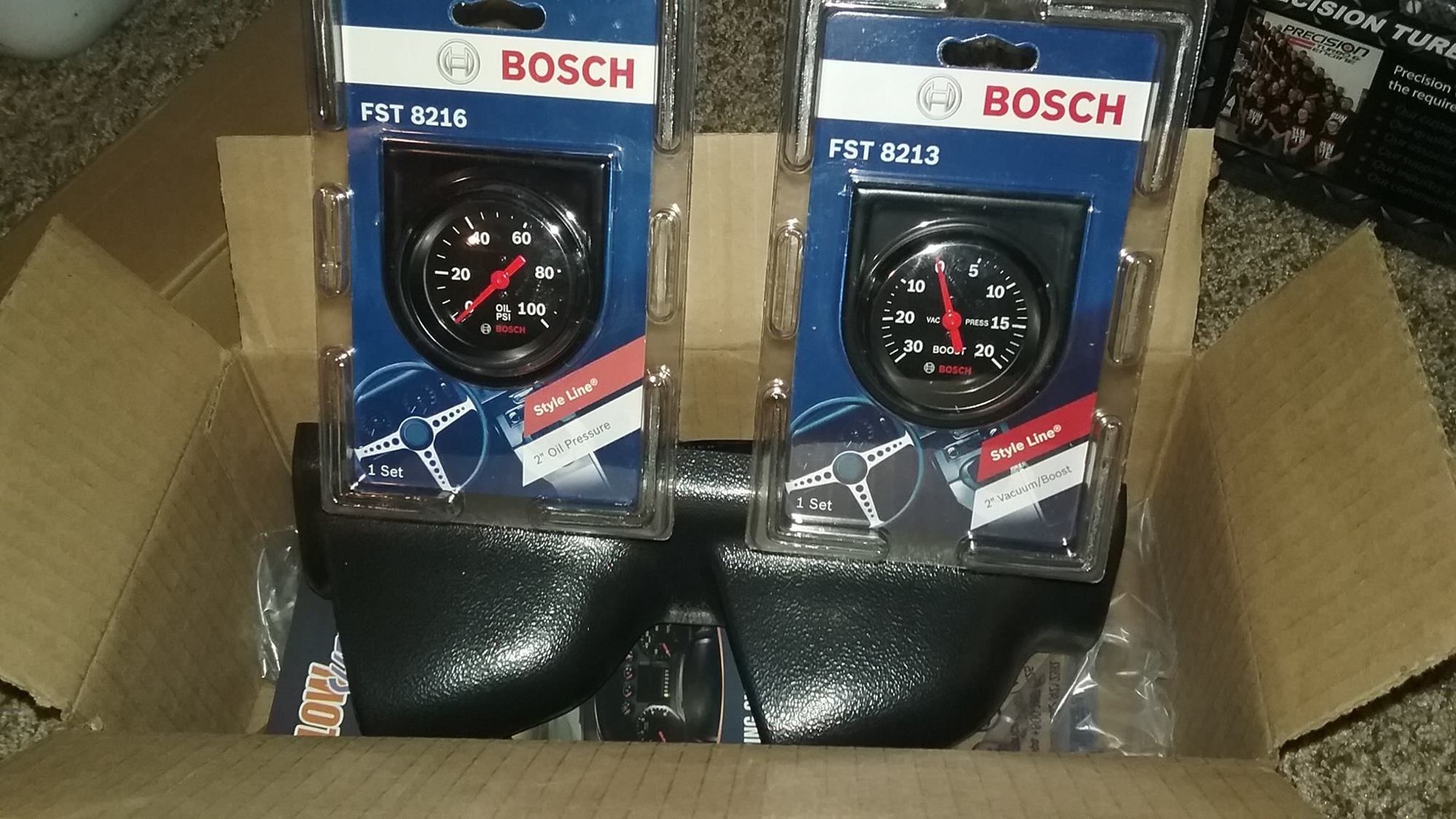

Pretty much next step is to bolt on the kit n hit the tuner, but where to go is yet to be decided.. heres a couple pictures
Had a nice parts pile building up again, the big white box is for my ranger tho, It really needed some new coil springs so i got some 2" (front end) lift coils for it Lol
Its so beautiful feels good to have a great quality wastegate to run, and its not a bad deal, around the same price as a basic tial 38mm but this precision is a 39mm that comes with a full range of springs, and v band adapters and all the hardware and new gaskets, very happy with how it all looks so far. It even came with a 1.5psi spring that ill use to drive to the tuner
Ended up just getting a 2 guage pod instead of the 3 i always planned on, Not sure if ill get a wideband or if i even wanted it mounted in the pillar permanantly anyway since i hear they really dont last long in a daily driven car. I do need a copper tubing installation kit for this oil pressure guage tho.

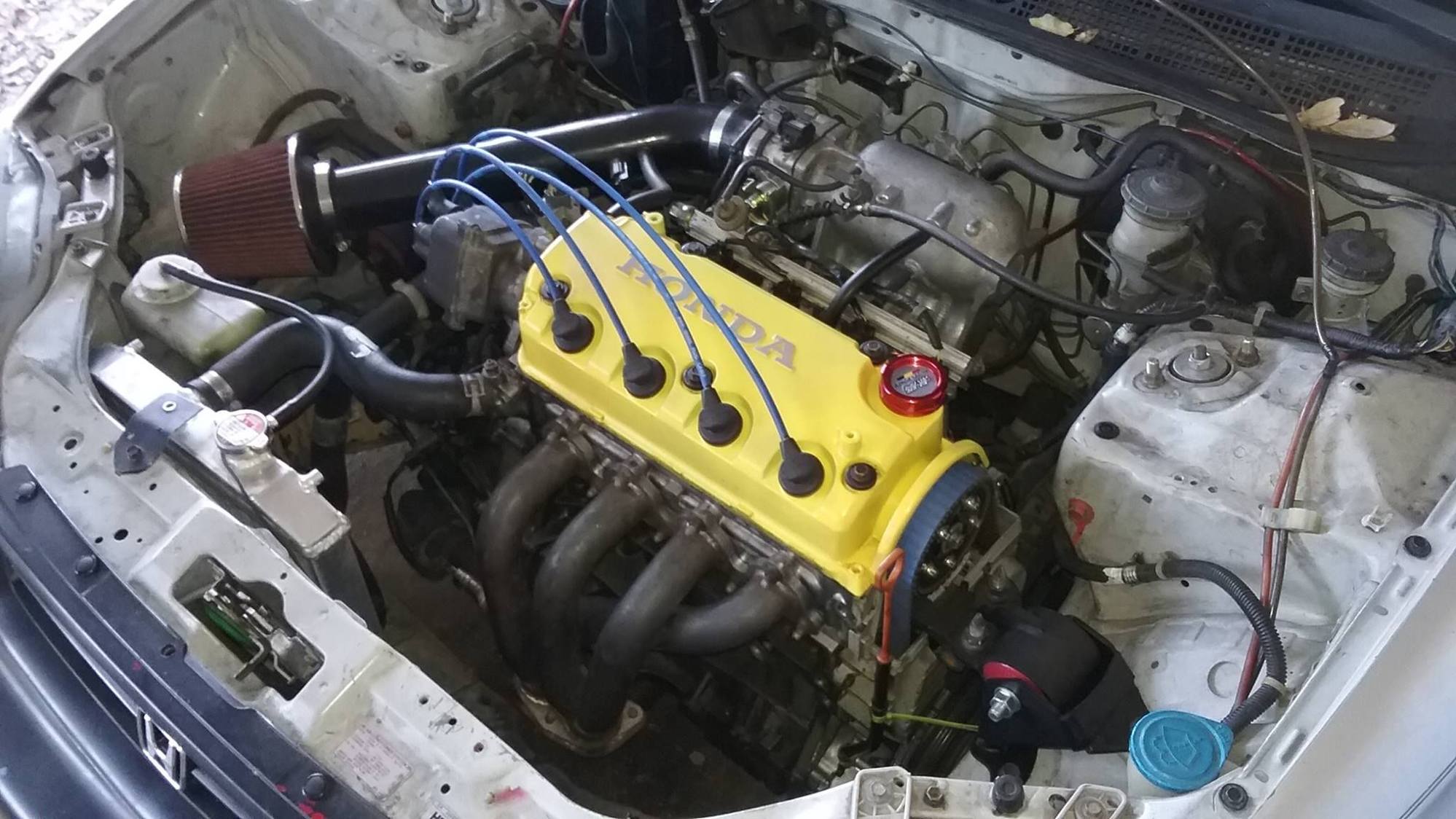

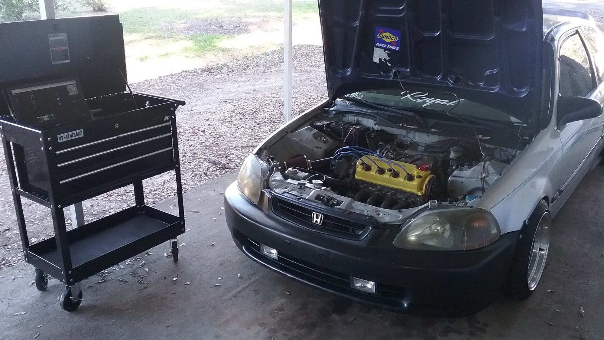

Got the valve lash done, some of them definitely tightened up after breaking in the motor, the whole exhaust side mainly, next is a compression test to make sure everything is good to go for boost, except i needa pick up some helicoils to put my valve cover back on. Lol.
My work shop car port lol
Lil y8 still lookin clean
All adjusted n looks good for now
