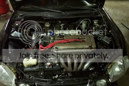

Any more pics of the exhaust mani, almost looks like if was a rear mount turbo set up, but i see the hot side coming up where the power steering used to be, looks good tho!!!

yea show us some pics of that manifold

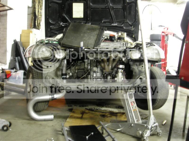

Did you modify a normal set of headers to accept a turbo???? Never thought of that before. Nice car
Old 10-14-2005, 11:31 AM
splitime's Avatar
Join Date: Jul 2002
Location: Chicagoland, usa
Posts: 5,695
Default Re: 11.8sec del sol - daily driven - pump gas - open diff (TurboTagTeam)
Also curious to see turbo location and header design. I'm curious to see if the turbo is way down there... and it if is, how the oil drain is functioning.
Old 10-14-2005, 12:16 PM
del slw's Avatar
Join Date: Sep 2004
Location: Taylor Mill, KY
Posts: 138
yes the turbo is mounted too low. about 2" too low. the oil return is SHITTY. thus the reason why the turbo is blown.
and no it's not a modified header, it was made from scratch by a friend. he can modify so that the turbo would return the oil efficiently, but i cannot go without my car for the 3-4days it would take to do so.

cool pic of downpipe being made

hey awesome car, got any shots of that manifold?
